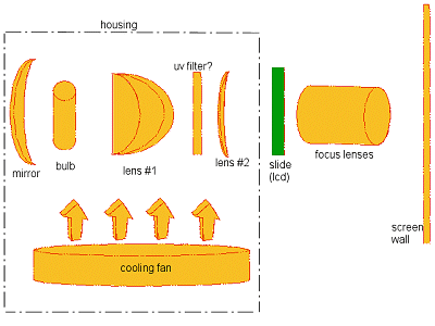

Hi all,
This is how my projector looks inside. Please tell me what do you think and what should I alter to make it better suitable for lcd projection. All lenses are glass lenses, the ones marked as projection (focus) were made by Meopta.
I could replace the huge fan with a smaller one and place the lcd driver board and/or other parts inside the housing. Any idea?

gabriel,
Without seeing the actual sizes and specs of the lenses, mirrors, and bulbs in your slide projector, it is tough for me to make any significant suggestions. In my opinion, your best bet would be to use the projection lens assembly, a 2.5" LCD, and a completely different light setup. You may, however, find a halogen, metal halide, or similar bulb that could work with the existing setup. If you wanted to get really experimental, you could try using a high output PC (CFL) bulb in the place of the existing bulb (check out the GE bulb option from the ace-ballast link that lokost posted recently). That would probably have a relatively low output, however. It looks like the mirrors and lenses in your projector were designed to be used with a true point-source light, like a metal-halide.
If you find that you really can't use much of the slide projector, at least you can learn much about optics and the general theory behind projection. That alone is worth $10.

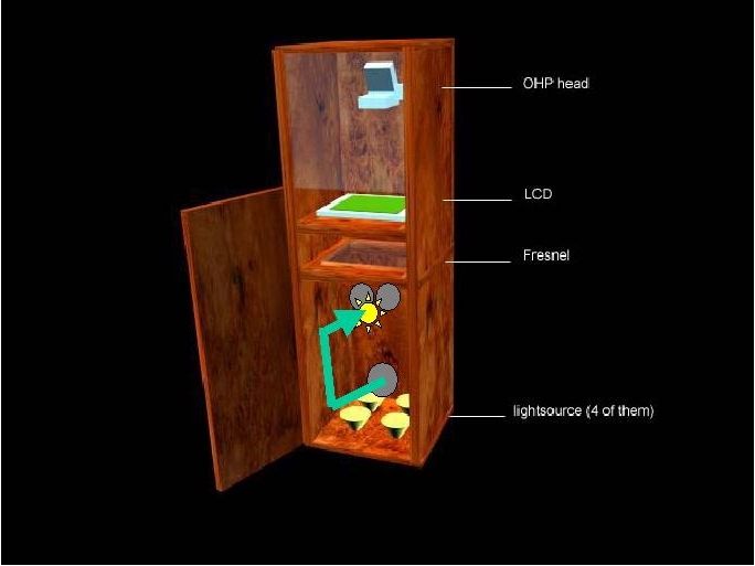

Okay, I'm desperatly trying to think how to get the cooling in my box work better. Three 12x12cm (5 inch) fans should be enough!?
Here are two pics of my setup, one is the original "3d design" which looks quite much it, only lightsource is not in the bottom of the thing and there are not four of them. The other picture is the cooling setup right now. All the fans are located in the backwall of the thing.
Now, first of all, do you think the fan in the bottom is useless? Other thing is that should I also have a fan on top of the fresnel as well?
Any suggestions are welcome, even just your best shot, It'll be better than nothing.
Somebody warned be about the ohp setup that heat goes up so is it like this:
my current setup all the heat goes to the fresnel and apparently the cooling isn't doing any good right now so only some heat is pulled of by the cooling. Heat is represented as red lines in my hardcore drawingskill pictures.
Anyway if I had standard setup would most of the heat go upwards to the "roof" of the thing and not too much to the fresnel? Or what?

Hi Bitch,
I think the fan in the bottom will do much good. In one way or another you have to get air in to the box if you are trying to get air out of the box.
I believe this will give a more quiet solution. If you only had the two fans on the top, they would have to work harder to pull air in through the small openings around the door on the box. That would make much more noise.
I would suggest to try to lead the air from the fan in the bottom to the front of the lightsource. Maybe using tubes. Then there will be an even airflow that are passing the lightsource. See the pic added.
