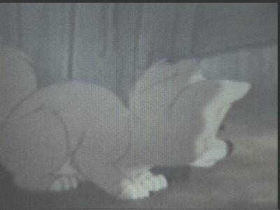

Myren: Didn't quite understand what you mean when you say that the FFS bulb may not be usable. If you mean that the light intensity wouldn't be uniform( the same amount of light everywhere in the pic ), you just place apiece of glass to blur the light before it hits the LCD('s). Don't know if that is what you meant. I believe this is much light for the cash. About 5 cent pr hour. Original projectorlights(the ones we use) are about 15-20 cents pr hour.
Zark: This is cool. I see that you have a lot of stripes in your picture. ( See the file attached ) Is this because of the camera used or is it in the projected image? I understand you use a 5" LCD. I looked at it and saw that the resolution wasn't the best. Only 960 H x 234 V Try to find a screen with higher res. PAL and NTSC would need about 800 H x 600 V(SVGA) to be at it's best.
All: Love to see your pics. Hopefully in color. Not to complain about you Myren.
soje are you out of your mind, that image is up close and is just what my setup looks like with a 640 by 480 LCD, even the new philips hopper projector which I recently looked at has that kind of screen door effect. I am also sure the images looks much better without going through a camera! Great work everyone, most impresive. I am still hunting for a good projection globe. I was going to use a standard mains voltage Halgen globe and it was 650 watts and 12 000 lumens but only lasts 50 hours, to short! Anyone know of a similare one that they have the type number?
Fiat1, no I'm not out of my mind. the only horizontal and vertical stripes you should see is the separation between the pixels.

soje
The lines are from the LCD itself. Your right its not the highest resolution screen available, but my project was based on building a reasonable projector for under $200. If you can link me to a 5" LCD with a higher resolution at a descent price that would be great. I want to keep the cost down because it wouldn't be worth investing the same money as a used comercial projector. The lines arent really that bad especially for the price. I also have a Kloss Novabeam CRT projector that wont have lines
as soon as I have time to fix a couple of convergence problems, but I'd rather work on the LCD project. (Less like work). Thanks for the input. If you see any other improvements that could be made, let me know.
