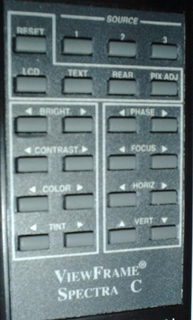

It could be that my panel is bad, but I am being fairly critical in my description. Most people don't even notice it when I show it to them. You almost have to be looking for it. It's not a blurring of motion....the motion is great! No trailing or blurring during normal playback. The distortion I am seeing is a faint "ghosting" just to the left and slightly up from the intending picture. It is visible during playback or pause.
I have tried all of the remote settings, and none seemed to help very much. They do, however, have a significant impact on picture quality. I would recommend to anyone that hasn't played with different settings to do so ASAP. It made a big difference for me!

have you done the calibration on the back of the remote?
it might not have the label attached still, here is how to calibrate the panel:
Press reset, then focus, then palette, and this is what you can do:
adjust 9th pixel drop: (no idea what this does) Color
adjust phase: (refresh rate, if you have jitter) Tint
that should work out for you. if it doesnt, i think its a bad panel...
oh, and press reset to exit calibration mode. that should help out everyone with a spectra c. it will solve any issues you have.
cowang,
I'm not sure if I have the same remote as you. I have attached an image of the face of the remote. I don't have a palette button, but I do have a button for phase. Maybe we have different year models or something 😎 . Unless there is a hidden calibration that I can find (or that someone could point out to me!), I think I might just have a bad panel....actually, even if I can't figure it out, it's really not that bad. It's just me being picky 🙂 . I can live with it.
Thanks for your help,
f4

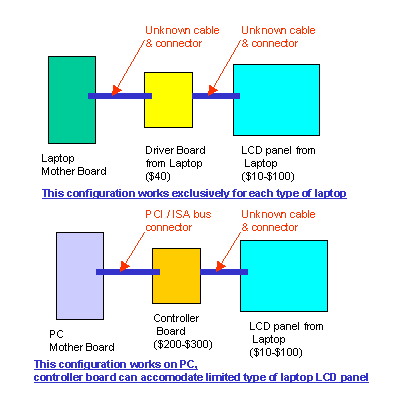

Hi guys,
I'll try to explain about Laptop LCD panel connection, see attached drawing below,
please correct me, if I'm wrong:

About smearing image, don't be to fast blamed on the LCD panel, maybe the problem is from light source.
I did some test:
I draw multiple horizontal and vertical lines with different thickness (mostly black color lines) on a piece of transparancy, project this image and see the result.
If the projected image shows the lines in perfect solid lines, then the problem goes to the LCD panel, if not... there are more then one causing this problem.
First: light source= not small enough as a point light source (critical)
Second: fresnel panel= not good enough, (the quality, bended etc) (less critical)
Third: lens= not good enough (spherical & chromatic abberation) (critical)
see you.
