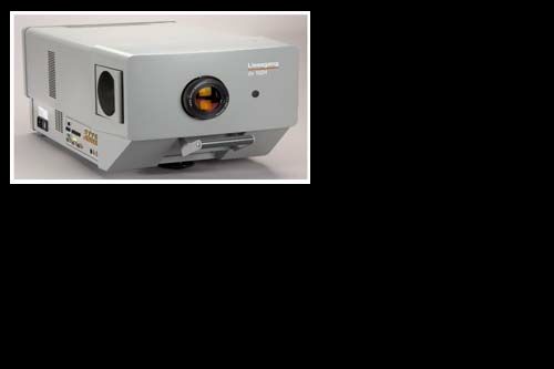

For all who are interested into the OHP route. Here's a typical all in one solution. This projector was built in the 90s, up to 1280 SXGA compressed, native 10" XGA panel, 575 W MH bulb, 350 ANSI lumen. Company was 'Liesegang', Germany. The parts seem to match with OHP parameters, p. e. objective. Even the length of the casing (650mm) matches the distance between the bottom of OHP and projection lens! Bulb life is 750h.
These PJs are handled on ebay for about 600 to 900 EUR. I already have a native 600x600 projection panel, which have the same in-and outputs as this projector!

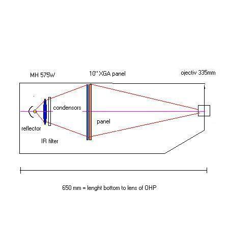

I made a little drawing of the supposed internal scheme.

I don't think you need a very big IR filter. You just need to do the filtering close to the light source without any stray beams travelling towards your panel. Check xblocker's diagram 3 posts above.

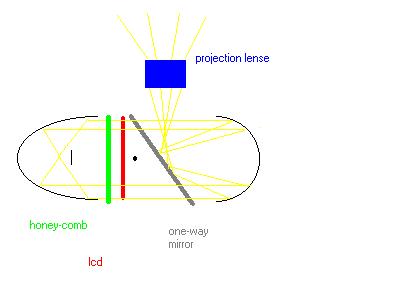

new projector design
okay... first let me say i've been reading this thread from the beginning, and damn it's long. i think i have a pretty good grasp of what the problems are with the lcd setups, mainly that of focusing the light and getting it parallel through the lcd. (polarization i haven't touched yet), but i had an idea, and i need someone to tell me why it won't work.
ohp - okay, these work pretty good, but to get more light through, we want it normal to the plane of the lcd. the two fresels don't do this, and we can't sandwhich the lcd between two fresnels because of image quality issues. furthermore, we can't seem to find lenses big enough for a reasonable price to use instead of fresnels, or a screen small enough with good resolution to use normal sized lenses.
take a look at the picture and i'll tell you what you're looking at. we starting with a light source with a parabolic reflector and either a small blind in front of it, or a very small 2nd reflector, whatever floats your boat.
light coming off the reflector is in parallel rays. it travels out through a honeycomb-like structure painted flat black, to assure that ONLY parallel rays are going through. one might want to put heat sinks on the outside edges of this honeycomb.
next the light passes through the lcd.
after the lcd is a one-way mirror tilted at a 45 degree angle. light from the lcd passes through the mirror. correct me if i'm wrong here, but the angle does not change when light passes through a sheet of glass or one way mirrow, but it may have some offset based on the thickness of the glass.
still all parallel rays at this point, enter the second reflector, facing the opposite direction. which is then focuse towars the reflector focal point.
it then bounces of the 45 degree mirror, and out of the projector, either straight onto a wall or through a set of projection lense.
bonus: i *think* you get free keystone correction with this by change the angle of the mirror slightly.
so what am i missing? i realize i'm loosing a lot of light through the mirror and the two reflectors, etc. but i think allows us to avoid using BIG lenses with BIG lcds. interference between light travelling in opposite directions? there's got to be something.

So what am i missing? i realize i'm loosing a lot of light through the mirror and the two reflectors, etc. but i think allows us to avoid using BIG lenses with BIG lcds. interference between light travelling in opposite directions? there's got to be something.
Jiggersplat,
Your idea would work. Just a couple of points. A fresnel can give you parallel rays if thats what you want. Depends where you put your light source. If a light source is at the fresnel focal point you get parallel rays out the other side. Or you can move the light slightly and get rays with a very slight convergence through your LCD panel but you have a long distance then to locate your projection lens.
Where you going a get a honeycomb structure with sufficient definition.
You would have to have thinwall structure otherwise it will block light including parallel rays going to the panel. It would have to absorb non parallel rays and the honeycombs would have to line up with the pixels in your LCD panel. Thats a tough job. 3 LCD projectors use a sheet of pixel size microlens on each LCD to take as much "useful" light as possible and direct it through their panels. Gives more contrast and more lumens on the screen.
There are several ways to get parallel rays. Point source light. Perfect shaped reflector with completely smooth walls. Normal reflectors and lights are a long way short of this but its suprising how well they work.
Direct your light into a fibre optic or light guide and a lens at exit end to make parallel rays. With practical devices you only get small diameter parallel ray bundle and can be costly.
Assuming you could find a honeycomb structure and parallel through your panel you could use an offset focus second reflector directly to your projection lens and not need the one way mirror.
You could find the losses in the honeycomb structure and the second reflector and if used, the one way mirror you would be short of light.
