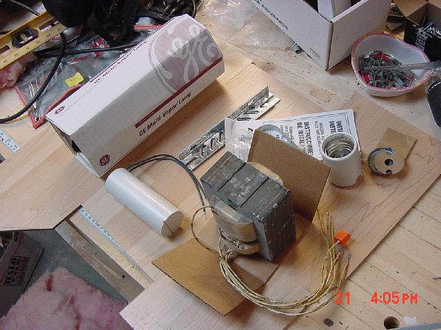

Friends, don't fail me now...
I been making slow but sure progress with my projector setup, and many of your have been wonderfully helpful in getting where I am today: I've just taken the $100 leap, and purchased the 400 watt metal Halide lamp for the project.
Here's a picture attached.
Now I've got to wire it together, and see how it operates. Can anyone suggest how long a "test" I can get away with before I start working on the cooling system? Clearly, I've got to get airflow via fans and ducts, but I need to set it up and see how it's working. 2 minutes? 5 minutes?
I'll take the guts out of the OHP, and take more pix.

If that's a Metal Halide, why does the box say Mercury Vapor?

Ya scared me...
Noodles,
I read your question, and zoomed back into the workshop. The big print actually says "GE Multi-Vapor Lamp", and above it in smaller print it says Metal Halide.

Hello all, from colorado I post 🙂
First of all, for those who said no progress has been made, I remind you that I will have a finished working projector within 2 weeks 🙂
As for the Multi-Vapor labeling on the metal halide bulb, I'm pretty sure that all Metal Halide bulbs say this (most of the time it being the largest print on the box).
daveb: almost all metal halide bulbs will be fine out in the open air, without any fans or cooling whatsoever. You can run them for hours and hours. The only time you have to worry about cooling is when you've got aluminum or mirrors, or whatever surrounding it, keeping the heat within a small fixture that the bulb is in.
