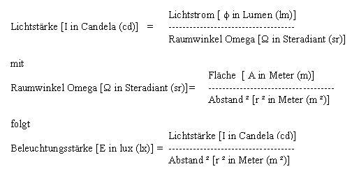

A Luxeon Star LED has about 660 candela. And if candela = lumens... then well, you know the rest.
daaaaaaaaaaaaaaaaaaaaaaaaaaaaaaaaa!!!!!!!!!!!!!!!!!!!!!!!!!!!!!!!!!!!!!!!!!!!!!!!!! cd does not = lumens!!! I am going to make a section of my web site on how to convert the numbers. One 10,000 mcd led with a viewing angle of 15 degres is 2.1509 lumens. I lexeon emitter (if i remember from their website) can go as high as high as 150 lumens.
ooopsss 😱
yes u are right: here is the formula
so 10000mcd * 15angle --->>> 150000 m lumens
so 150 lumens is right...
but even then we are just talking about 150!!! lumens and is still a long way too 35000 lumens...
and the leds posted here had max 7500 mcd that would be 112,5...

noodles said:A Luxeon Star LED has about 660 candela. And if candela = lumens... then well, you know the rest.
so the luxeon star led would have about 10000 lumens, but i think the viewing angle is the problem. u won't be able the light up the whole lcd.
