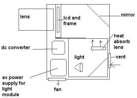

new design ? input please
I am working on a compact projector. 11"X10"x5" + lens.
I currently have a light module from a Kodak slide projector. 300w light with mirror, and heat absorbing lens. the light is very kool and bright. A 5" lcd from parstexpress, and deltaIV lens.
The light output is rated at 1300 lumens after the heat absorbing lens and mirror.
This is a very small design if it works.
I am using the mounts from the kodak slide projector so I dont have to build mounts for the light. and an all new box for the rest.
I have thought of using 2 or 3 Halogen lights from Home depot ($9.00ea) in place of the light module, or just adding another light module, but this would increase the size of my projector.
The light is very small so I am guessing that the edges will have low light. I think I can help by building a concave screen.
The pics are rough sorry

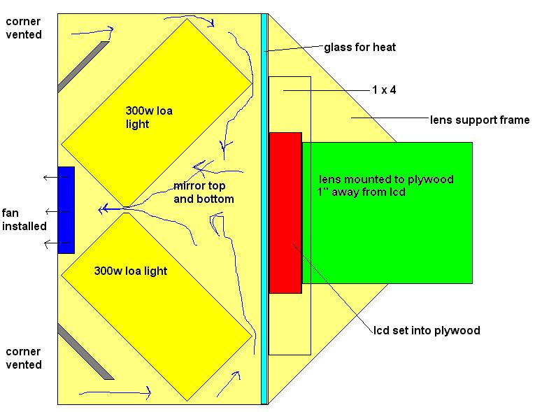

New design 2 input request
Similar to the design using the light from a slide projector. except the light source will be from two halogen lights from home depot.
This will be larger than the original design, but shoult have good output. I am just concerned about the heat on the LCD without the heat absorbing lens.
two 300w halogen lights, facing at a 45 to the lcd to get light to the edges. A std piece of glass to help create an air gap between the light box and the LCD.
Fresnal lens to help get more light through the LCD
5" lcd from partsexpress.com
delta IV lens
Is there a heat absorbing glass that is large enough fro the opening 5" diag?
See the pic.

hi mgerny,
your 2nd design is very interesting. but let me ask u some questions:
- why TWO 300W lamps (each of it has more than 300 degrees celcius, try to handle one first), ONE glas won't help for the heat problem... i have three glases before the lcd comes... and it still has 40 degrees celcius after 4 hours... (which is ok, i think)
- second problem of the two lamps is you will have to hotspots in the projected image. u are right if u want to light out the ankles but don't forget the middle of the picture... hotspots are seen becaus one point is brighter than the other...
- are u using two reflectors? what do u think about my theorie in my previous post?
- and how will your fans be positioned
sorry for my bad english
hope you got the idea of what i wanted to ask...
best regards andy

fan for Mgerny Projector 2
I planned on installing one large high volume fan with a baffle to keep the noise levels down, And just venting the sides of the box to force a convection within the chamberto keep the heat as even as possible. One of the other fan positions is on the top of the box, and vents on the bottom. All I am trying to do is keep the temp down in the box, and still looking for a glass that will absorb the unwantes heat froom the light. I have heard that some of the hear (IR) is reflected back into the lighted area anyway, because the LCD's only use about half of the light unless they are designed to be a clear view like the larger LCD panels used in overhead projection projection systems.
The LOA lights will have the manufac glass still on them. I planned on keeping them as factory as possible, but not sure about the life of the lamp or the plastic case it comes in if the temps get too hot.
I have another design with the LOA lights facing each other 90 deg from the lcd with mirrors in a v to reflect the light towards the lcd. I think this might be a more efficient way to light the perimiter without loosing the light in the center.
mgerny projector 1
The first mirror and the lens are part of the light module, These will not be removed for the first test. I might get out the hacksaw if it doesnt work, and start major modifications. I think I can keep it small or maybee make it smaller. It all depends on how much of this I want to make custom, and how much I want to keep the parts in sets, so they are easily swapable. If the lamp goes out, I dont want to take apart the entire box to get to a lamp. With the light module and the sleve that it goes into I can jest slide it out of the back and replace the lamp or the whole module.
Not to mention there is a light module that has two lamps installed that has more output in the same size module.
Future upgrade possibities, or just looking into the option for a day/night switch that would be easily turned on and off.
I am banking on the first design, or something close to it as my goal the second design is one to fall back on, just in case.
Keep the input coming.
