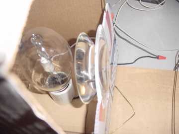

I have modified the optical design I previously posted to this:
light - condenser lense - objective lense - fresnel - fresnel - LCD - fresnel
The condenser lense and objective lense are "butt" up against each other right after the light source. This has greatly increased my brightness. I am in the process of using the previously mentioned "mixing bowl" to work up a reflector. I feel good about it after testing it with lower intensity bulbs. Now I have to cut the hole for the monster MH.

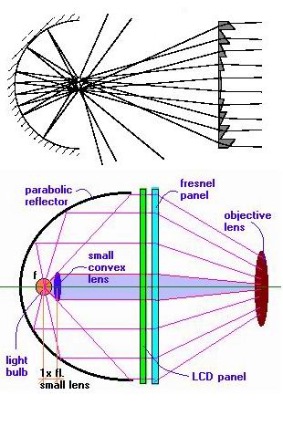

Re: diagram of projector
thumper said:
This is how simple the design I'm trying out is. I have no idea how it's going to work once I get the housing built and actually add a brushed aluminum reflector behind the bulb.
I have had success using a fresnel as a projection (after LCD) lens. The clarity was much better than i expected and there was no noticeable distortion like i had with my glass fish eyes. Now I'm trying to find a way to increase my light output. Maybe then i will notice problems but for now the cheap staples lens is working very well.

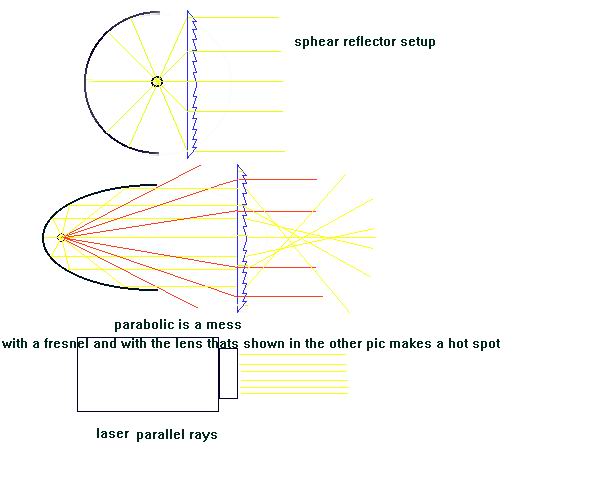

hi im back and broke
ive notice there are two ways that light should travel from the light source setup for even light. parallel rays from the bulb and reflector, or ray evenly spread from the point of source(yes the ray can be reflected as long as they reflect back in the same direction they came from "the point of source") but the thing is we cant go with both because they use different lens setups. i might be wrong but i doubt it. see the pic's below
i just thought about it and im wrong on one part .with a parabolic reflector its not posible to get even spread parallel rays.so basicly
lasers dose parallel even rays, and parabolic reflectors do both parallel and raysfrom point of source, and 1/2 sphears reflector setup dose evenly spread light from point of source. ill put some picture exsamples in a little bit to explain the two way that would work and the resond why parabolic might not be good for even rays of light. i still might be wrong on this so tell me if im wrong.

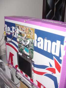

LCD Mounting
The LCD mounting (temporary but you get the message). The boards simply folded up (see the triple ribbon cable a the top of the screen connecting the screen and the green board). The three boards have holes in them to run small screws through and secure it to the mounting board.

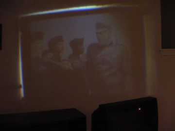

I TOTALLY agree with everyone so far who has said "digital cameras were NOT meant for dark or low light conditions!!!!!!!!
This is the best I could get. I wouldn't want to tell my family they had to watch it as a primary right now, but I have watched it two nights in a row with no discomfort. The dark area at the top right is a piece of paper I was using to try and block some of the ambient light. The white at the edge of the picture is the poor temporary framing job I did around the LCD panel.
I really feel that the reflector will help with the brightness. Even if it doesn't though, I've at least proven how to do this type of setup, and just replace where I have a 250watt with a 400watt. I just don't feel inclined to go out and spend another $70 or so for a new ballast and bulb until I've exhausted all other means.
The other types of setups have their own way of doing it and who knows, may very well look a whole lot better.... The whole issue boils down to "how much you wanna pay?" High cost, high quality parts will produce a higher quality picture. I think that with ongoing tinkering someone will find just the right combination of locally available parts to make it all work just right.
I don't think this is too bad for a bunch of stuff propped up with coat hangers and cardboard. I will begin on the permanent housing as soon as I'm happy with some kind of results from a reflector.
