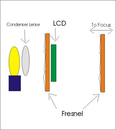

I have finally embarked on my DIY projector and am using the following design:
Light Source - Condenser Lense - Fresnel - 5" LCD - Fresnel
Light source is 250Watt MH with no reflector, light tube or cone. Just a big old bulb burning my eyesockets out while I'm working... Condenser is from inside of Delta IV CRT projector lense (it's the middle lense when you disassemble the lense assembly), two fresnels (page magnafiers from staples) and the 5" LCD is from Parts Express.
It is set up in prototype right now (that means I have a disaster waiting to happen on my project desk😱 )and I gotta tell you, I'm getting one heck of a picture???
I'm projecting about 12 feet onto the wall, the room is FULL of ambient light from the MH bulb, and I'm not using an objective lense, simply the second fresnel after the LCD and focusing with it.
This does not seem like it should work at all. I have tried to use the objective lense (again, from the Delta IV) but it is a real pain to focus (and not the ouside edge stuff that was talked about earlier, that was fixed by taking out the first SUPER planoconcave lense that is at the begining of the lense barrel). The focusing problem is from the two fresenels overlapping pictures onto each other and then trying to converge them with the objective. That's why I just started using the fresnels. Has anyone else had any experiences with this?
P.S. when you put the condenser lense RIGHT NEXT TO the light bulb - make sure it doesn't touch!!! I'll be heading out to get another Delta IV to scavenge the condenser out of tomorrow. The bulb BOILED surface and now I have a big spot with a bunch of little bubbles. (yes, it's glass and not plastic...) Teach me not to pay attention
diagram of projector
This is how simple the design I'm trying out is. I have no idea how it's going to work once I get the housing built and actually add a brushed aluminum reflector behind the bulb.

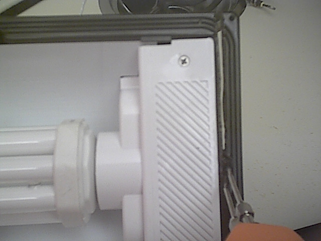

fluorex rules !! 65 watts, 6285 Lumen
i used 2 Fluorex bulbs 65 watts each and 6285 Lumen
so about 11.000 Lumen if you deduct the 10 pct efficiency loss.
i have some pics for those who might be interested

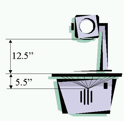

I see what you're saying (and drawing). And maybe it's time I change my optics. Here's my dilemma:
The optics I'm using come from an overhead projector, and the native distance from the surface (where your transperency would go) to the lens assembly is 12.5". So far as I know, to get a focused image (projecting 12' across the room) using this lens then the object being projected MUST be at this distance from the lens.
Meanwhile, the fresnel which came with the projector has a native focal length of about 5.5" (the distance at which you can burn a hole in the picnic table by shining sunlight through it)
If these two things are true, then I propose it's impossible to place the objecive lens within the focal length of the fresnel.
PLEASE tell me I'm wrong, and this can work. Otherwise, it's time for new lenses all around, I think.

daveb,
Your situation may not be as dire as it sounds...
If your fresnel is from an OHP, then the trick to remember is that it is (probably) really TWO fresnels, each with a focal length of around 12" arranged so that the first one collimates diverging light from a point source into a parallel beam, and the second one condenses that parallel beam into a cone.
When you focussed parallel rays from the sun, you will have been treating the combined fresnels as a single lens with a focal length roughly half of the focal length of each fresnel.
If this is the case, then, with a parabolic reflector producing parallel light, you will not need the first half of fresnel doublet, because its work is already being done by the reflector.
In that case, you would be left with a single fresnel with a focal length compatible with your primary objective...
Bill.
Bill,
An interesting approach. However, I do believe that my fresnel is a single, not a double. I've taken it out, and it's got one side smooth (the side towards the bulb) and one ridged (toward the lens).
Perhaps the right thing to do is to replace it with a different Fresnel. Any idea of the typical focal length of the "page magnifier" available at Stapes et al?
The one from the ohp is plastic, so I don't think I'll feel like I'm wasting it if I don't use it.
dave.
Hi Guys,
If the focal length is 14" then all is well.
I have never tested mine, and my memory is not good tonight, but I seem to remember that generally for a lens, their magnifying power is equal to the number of times their focal length will divide into 25cm (about 10").
It is something to do with near point of the eye and the amount by which the magnifying glass pushes the virtual image away from the viewer...
If I am right, then with a 2x lens, you will see a 5" (12.5 cm) focal length.
