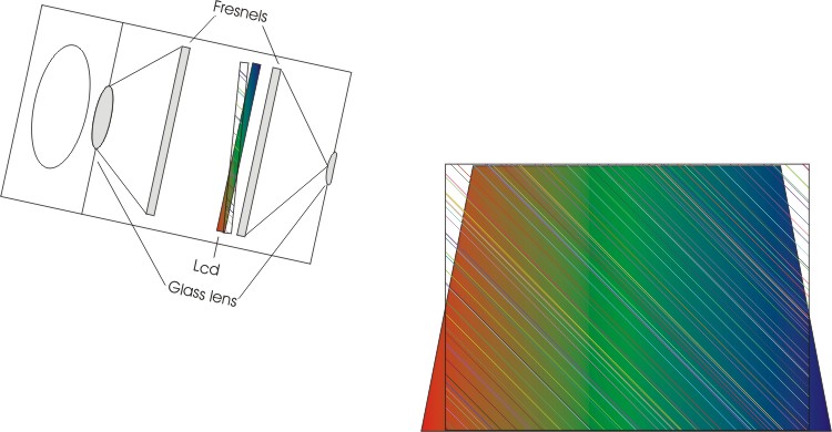

Here’s another concern, I made a little graphic for you to understand my idea. It’s the attached.
If we pivot the lcd in a way we can make the projector cell mounted and correct the trapezoidal image, would it work?

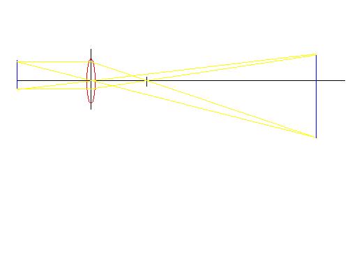

Keep everything aligned parallel to the same axis: lamp, fresnels, LCD, objective and screen. This way focussing is simple. Then, to offset the image, you could simply shift the LCD and/or lenses so that the center of the LCD is not aligned with the center of the fresnels/objective.
It is a surprisingly simple and effective way to adjust the output beam without getting the keystoning...
See picture...
As for lens focal length, if you can get lenses fairly cheaply, I would go for a spread between 5" and 8" to match the image size to the desired size of your image, and the length of your room. (The fresnel will move the magnified virtual image away from the objective - further than the LCD itself.)
With a smaller lens, position is crucial to maximise brightness.
Alternatively, if you can get multiple lenses, you might want to try a longer focal length lens exactly at the apex of the cone, and use a second movable lens to actually perform focussing. This is how my main system works.
(Two lenses close together will behave as a single lens with a focal length that is a combination of the two focal lengths of the individual lenses and a factor based on the distance between them. There are examples and spreadsheets to calculate this distributed through the threads.)
Maybe two 12" lenses would suffice. (I am guessing here...)

When adjusting keystone, Gustavo is on the right track.
My SHARPVISION projector uses a rotating fresnel like the one Gustavo drew to adject the keystone. That is basically the way all projectors do it unless they have digital keystone adjustment.
If you point the projector at any agel besides 90 degrees then you will have keystone.

Woneill:
Would that method also work for left-right keystone correction? ie. if the projector was mounted to the left or right of the screen?

What I described is not a keystone correction - it is a way of ofsetting the image with respect to the projector. It does not distort the image the way keystoning does - everything stays in proportion. (It works left and right too...)
It assumes that everything is aligned parallel to the optical axis - including the screen. That way, everything stays in focus. (This is also how desktop projectors manage to project upwards and not hit the floor...)
If there is already a keystone issue, then there will probably also be a focus issue too. Then the concept of rotating the LCD will possibly work.
