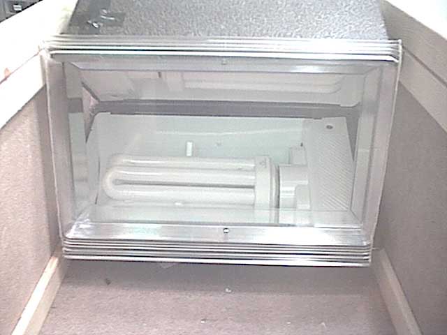

I do not understand why this forum cannot see success when there is
i posted some pics yesterday from my projector, homemade, and working perfectly, thank you. and no one replied .... ???
Is this perhaps a) because i used the FLUOREX 65 watters ? i noticed that some people are completely ignoring them = those i invite to come and see The hunt for Red October and i will record their reactions........
b) is it perhaps because success is not an option ????
c) perhaps someone on this forum is trying to invent hot water???
---- I watch movies now on a 95 by 48 screen (yes plas tek poly white) with a MINTEK dvd player that costed me $69.00 at Best Buy (new , not refurbished === people that buy dvd plaers on ebay should have to see this one! plays about every format there is including karaoke, dvd's that i copied with dvd copy plus = VCD format etc etc..
I have 16/9 format & wide screen at home for less than a regular tv. My whole project without the dvd player costed me (including the wooden toy box (from IKEA for $9.95) US$160.00
I will be posting pics on a regular basis, including pics during projection, as long as the moderator does not kick me out of here .
I enjoy it very very much!
now for me, and i suggest all of you, your next project or for most of you you the first one( i suspect) will be a lcd projector with a lcd monitor screen of 2.5" or smaller , so that the whole casing can be a bit more compact... i admit that 25"*16"*11" is a bit big.
This should really become the talk of the town as.....
a projector with a 5.6" and FLUOREX floodlight is already working boys!

Oh, I saw your pics 😀
But people will really comment when they see a final result. Show the people some displayed images 🙂
I do like the switch you used. looks tough and will last long 😉
65watt LOA

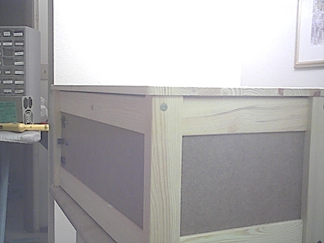

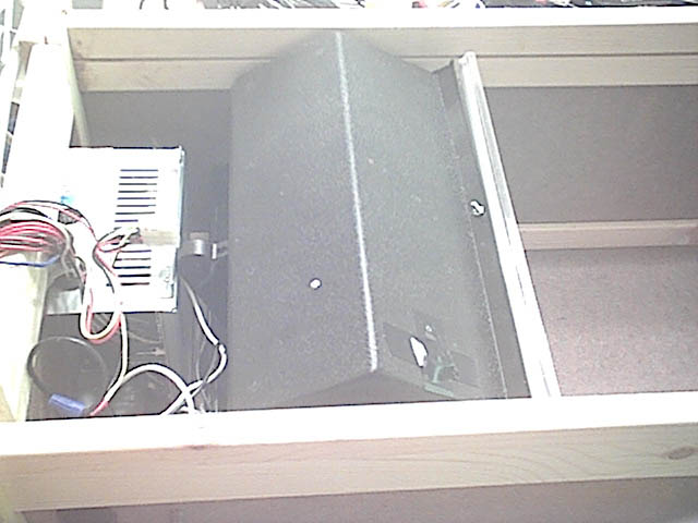

I would absolutely like to see more on uvodee's projector. But what was posted was just not enough to get a good idea of it's total construction and results.
Uvodee, how about some pic's of the whole box so we can see how you finally put it all together. The box construction, the light - lense configurations, etc... You know, wide angle shots of the whole shabang.

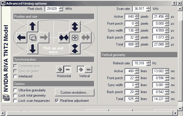

Solution for NVIEW vSYNC problems
I've been hearing alot of ppl say that their panels arive either defective or not copatible with their videocards .. in both cases i'm talking about vsync problem (screen jumps)
here are POWERSTRIP settings that corrected that little nasty on my panel 🙂

Because YOU asked for it, the enclosed box before cutting the frame for the screen/lens
