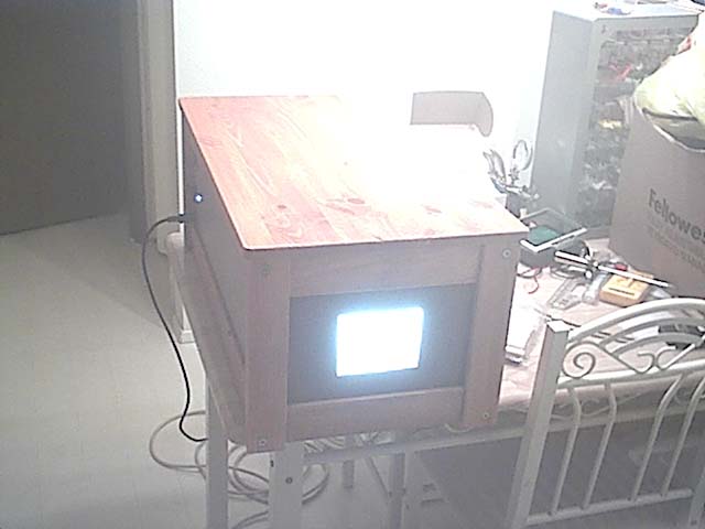

2 floodlights ????? 65 watts each fluorex bulbs ( bulbs alone cost about $9 each and go about 25.000 hours)
i did not remove the photocells, hust covered them with some black tape (yes i was too lazy!)
then i used ONE of the orignal covers to hold them together in the front ( i reversed a frontplate and used some stainless steel nuts and bolts (see detail of one of the pics)
the rearend was put together with again nut & bolt
the reason for using one orignal cover is: the plastic is perfectly heat or should i say warm resistant= no significant increase in temp. I incorporated a 5" 12 Enermax fan, i should have known better: more cooling that it needs but that's ok for now.
I piad $30 each at Home depot
the plastic fresnel ( i want to change it to a glass one) does the focussing or should i say in my words the job pretty well : i coudl clearly see the light being brough together into a rectangular shape and then i covered the fresnel with black fotopaper that i recuperated from a foto book ,and i cut out the size of the lcd screen.
i saw this at ZARK's website and s. o. a. gun that's all it took
soe playing around with 2 lenses delta IV and delta 67
( both have there good and bad points!! and
this weekend i have some friends over for the ocean's eleven viewing! with beer from my homecountry Belgium: Stella, Geuze, Hoegaarden en Triple Palm!

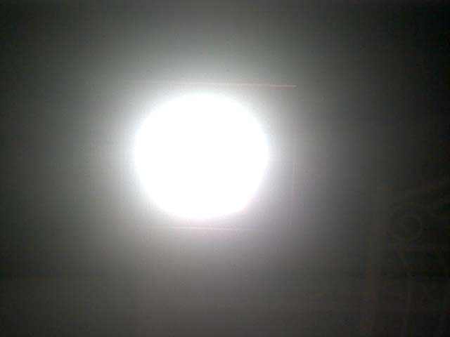

to whom it may concern II
a pic of the opening while lights are on before i installed the lcd , gresnel, glass and lens
Oops almost forgot, I used smoked glass in front of the camera, just to be sure that the optics inside the camera would not get damaged.
Me, i had no idea i had to do this, it was an engineer(my wife) who told me so!!!! grmmmpppsfffffffffffff!!!!

guys be carefull!!!
Looking at the last posted picture i almost got blinded.
be carefull not to stare too long to the pic ok !!

Bright!
Jean-Pierre AKA uvodee
Well that looks bright!
Sounds like when combined 2 units put out more than twice the amount of focusable light. But is that all the light you want? I don't feel like spending an extra fifty just to find out it works but should be brighter.
