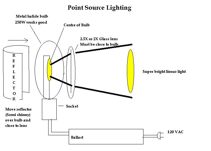

Hey Mitch
Just got back from trip.
Use a magnifying lens at end of bulb.
Using only 640x480 LCD panel.
Image looks perfectly good all around.
Make sure to build heat sink around ballast, gets hot.
Fan the bulb.
Then your good to go.
Later
