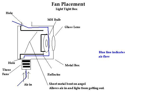

With my design it is not possible to get a large image at a close
distance. This is because my LCD panel is 10" Diagonal.
But if you can get a bigger Plano convex lens, say 12" then your in luck. I also tried two page magnifiers for the end lens (panel to screen, and it wasnt to bad (better with glass though). If you can get 2 glass frenel lens's with the lenticular line being fine (more lines per inch) the you should be good to go. Make sure that the
lenticular/ fresnel's are perfectly in line.
My MH bulb is in a metal box, and the reflector or any other shinny
stuff does not heat up. Therefore my job was to get the heat from
the bulb itself out. The only thing that I am doing is to have those
12Volt computer case fans (three of them) blowing air into the bottom of my metal box and a hole on top for out.
The heat sink is for my ballast (it getts hot). I have 2 pieces of aluminium about 12"x12" with heat sink compound on it and bolted the ballast between the two sheets.

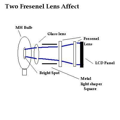

Gunawan W
The 2 lenses is to make the bright spot bigger, keep the light
square and parellel. Shorter distance.
It works great for me. I tried the reflector thing. If your using an
LCD panel use this method. Put a half curved reflector on the back
side. Make sure it is not mirror material, or it will creat another
beam or two. Use semi reflective material. I used one of those
stove pipe tubes or dryer vent ones. Something like that.

The first lens after the bulb is glass.
The 2 page magnifiers or fresnel lens are plastic. Bought them
at Staples in Canada. I think you have a Home Depo there.
My setup runs horizonal. Any extra heat developed goes straight up. They do not get hot. All the heat is traped into the metal box housing and the heat is removed by the 3 fans. My LCD panel
is always cool, not ever warm. Left it on for three days straight,
panel still cool.
As far as the lens after the LCD panel, look into lenses used
for light shows. They may be 9 or 12 inches round. If you have no luck try putting 2 plano convex lenses (4"ones) 1 or 2 inches
apart in a home made rolled tube.

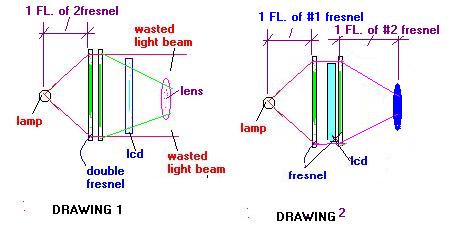

spot and condenser lens and another problem
Hi all,
Well I figured out my problem with the light bulb image being focused onto the LCd. As I suspected, it was my condenser lens. I grabbed a condenser from a 3M 9550 OHP, and popped it in my setup, and there was no lamp image. Moral of the story, make sure you get a good condenser lens.
Now, however I still can't get a bright image of my LCD screen from corner to corner. The focal point of the fresnel seems to be only about 6 inches past the LCD (measured by putting a white piece of paper in front of the LCD):
Lamp Fresnel LCD FOCAL POINt
} | || X
I thought it should be more like 12 inches past, that would make sense for an overhead projector. Because the focal point is so close to the LCD, the objective lens I have won't focus the image. When I move the objective further out, it focuses the image, but then it is dim, because a lot of the light cone is missing the objective lens. Does anyone know what is going on here? Do I have my Fresnel to close to the light source, does that matter at all? By all rights the focal point of the Fresnel should be about 12 inches, since it was from an OHP (well, 12 inches give or take).
Anyone know what is going on here?
At least I figured out the condenser lens problem

jco9w,Mario007,
distance between lamp spark/filament to the lens (convex / positive) must be smaller than it's focal length to get dispersion effect. Bigger than fl. it's start to collimate light.
Redevil,
with your setup, there are wasted beam of light after leaving the fresnel (see attached dwg1), because it's parallel beam, not collimated beam.
You don't need distance between 2 fresnel panel, you can put it close together to get parallel beam, just place the panel at 1 focal length distance to the lamp-spark/filament. (the 2 panel now act as single panel with new focal length=half of original fl. of single panel).
With drawing 2 setup, no wasted light, because all light beam goes to the objective lens.
Mitch,
please have a look at my spreadsheet at my website, it's explaining how to calculate lens, distance etc.
Rule of thumb, you need lens with diameter 1/3 of diagonal size of the LCD panel, to get whole image to be projected.
To get your setup work as your plan, you need to know the focal length and placing distance toward the lamp of condenser lens and concave lens, please do calculation before buying lenses to avoid useless lenses afterthat.
Actually to disperse light you can use either convex or concave lens, it depends on the distance of the lens toward the lamp.

Redevil,
Mitch,
