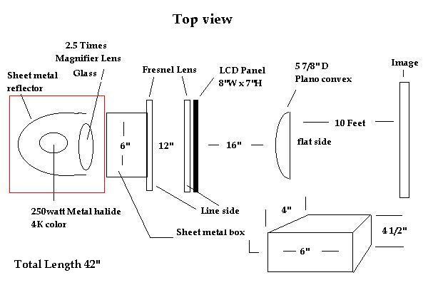

Mitch
First you need to square off the light by using a metal box.
Use a piece of cardboard at each end of lens to see how the light pattern is turning out. This is also a good way to determine distance. Your panel will work, but will need a 400watt MH for
brighter image (bigger panel). The lens you have will work, but then you will need alot more distance from Plano to screen.
I got mine (5 7/8" Diameter Plano convex Lens) for 8 bucks at
the surplus shed. The total length of my projector is about 42"
long, but hey I dont care, you should see my 90" TV.
Perfect clarity on all four corners, no centre hot spots, and this is on a white bed sheet. My friends freak out on this.

Redevil,
Thanks for your help. Drawing up those diagrams was above and beyond.
There are a few more things I had questions about. How big is your 2.5x magnifier? Is this a page magnifier sheet, or a round lens?
I just looked at the surplus shed and they didn`t seem to have any 5 7/8" PCX lenses. But they did have a 4 1/2 with a 12" FL. So I`ll proabbly get that.
I think I`m going to use two smaller MH lights instead of one big one. This might help with the light dispersion, plus I`m using a pretty big screen.
One other thing. On your diagram, your projector isn`t entirely in a box. Is this how it really is or did you draw it like that for "educational purposes"?
Oh yeah, just out of curiousity, how would you compare your projector to a regular tv?

Mitch
I wouldn't reccomend using two small metal halides. Simply
because two ballasts,two bulbs,two reflectors. It's quite a bit more money and construction then a single bulb. For light dispersion use a fresnel before your lcd and a dispersion lens right after your light source.
ANYONE
We need a pinout for a sharp projection cable. Please checkout the thread: Panel Paranoia! VGA cable -» need help . Thanks
Use only one MH bulb. A 400watt 4k-5.5k would be fine for you.
With two bulbs, you may end up with double image.
Only one point source is needed.
Thats why my reflector is made of sheet metal.
Before I tried a chrome reflector, and that ended up causing hot spots. The sheet metal gave me the chance to combine the back reflector spot with the front lens spot and not to overshoot the original spot.

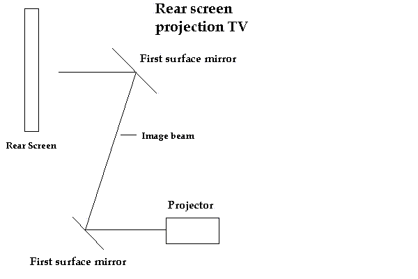

The lens after the bulb is a round glass lens that is 4 1/2 inch
in diameter (it is curved on both sides). Your lens after the panel,
your plano, will work fine. It will need a longer distance, so you may whant to use first surface mirrors. And guess what I just
experimented with today. You know the stuff that they use on
cars, the mirror type material . The one that you see yourself on
one side, and the other right throught. Well I took my brothers
back windshield from his truck, it has that mirror stuff.
And there you go. It worked really good as a firs surface mirror.
My MH bulb is in a metal box, with the other box attached.
The rest has a dark towel over it for know. The picture is better then my friends 52" TV. I can see the lenticular lines on it, and whats worse, the line doubler causes alot of distortion. Jagged edges.

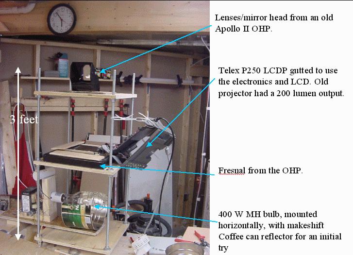

The Rubber hits the road...
Ladies and Gentlemen, I've taken the plunge, and I'm sort of treading water, sort of drowning.
I've been hanging out here since April, and have followed these threads all through. I've been inspired by the successes. So I've gone ahead with a design of my own. It's a bit different than the others, but not too unorthodox.
I built a frame out of 1/2" threaded rod, and cut 15" x 16? plywood rectangles drilled through at the corners. I can mount these "shelves" at variable heights for complete control over distances.
So I've put the light on the bottom. Above it is the Fresnal, and ontop of that is the LCD. Above that is the lens and mirror assembly.
What do I get? An image that's about as bright as the one I started with before I gutted the 6 year old LDC Projector from which the panel comes. And that's about 200 lumens worth. Dim, dim, dim.
I think there's something fundamentally wrong with the configuration, but before I start fiddling with everything, I thought I'd ask them that may know for some suggestions.
Please see the photo attached. If more clarity is requried, I can profide more pix quickly. ( I took the one here about 20 minutes ago).
I feel like I'm so close, yet so far.

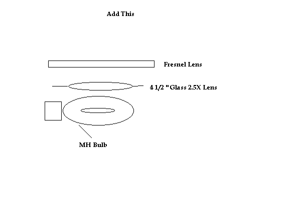

Daveb
Move the coffee can closer to the bulb.
Put a glass magnifying lens over the bulb (4 1/2" Diamater, 2.5x magnification). Mount the lens on a piece of sheet metal.
Leave 1/8" gap between glass lens and bulb.
Then move your panel higher, and stick another fresnel lens (or page magnifier) in between. Play with the added fresnel and panel til the light covers all for sides of your LCD.
Heat rises on these bulbs, put cooling fan on it.
Try the fresnel both (line side up or down) ways til image is good.

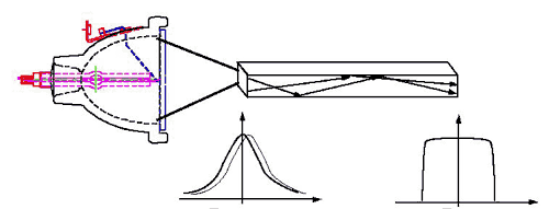

light pipe
enyone tried to use light pipe?
here is the article about it from this site:
http://www.extremetech.com/article2/0,3973,18971,00.asp
since i know you will not read it, here is the quote also:
"The optics in a projector are used to channel the light from the lamp to the imaging engine and then to the screen, maintaining as much efficiency and accuracy as possible.
This task starts right with the lamp, with the elliptical reflector that is built around the lamp itself. As the demand for smaller and less-expensive projectors grows, the reflectors also need to be smaller. The smaller gaps offered by the UHP lamps make it possible to use much smaller (and lighter) reflectors on the lamps.
Another optical task is to concentrate and steer the light from the reflector to the imaging engine. This is also an opportunity to mix the light so that it strikes the imaging engine more uniformly. The light from most lamps will be brighter in the center, gradually diminishing as you move farther from the center. On a rectangular screen, the differences can be noticeable by the time the image gets to the corners.
One way to resolve this problem is to use a series of microlenses to integrate the light from the lamp and create a rectangular beam. Another interesting solution is to focus the beam from the lamp on the end of a rectangular rod. This rod may be constructed of polished glass or quartz, or its internal surfaces may be surrounded by highly-reflective mirrors. The light rays bounce multiple times within this light pipe, and emerge from the end as a uniform light beam with a rectangular shape.
Note the left curve is the cross section of the light levels entering the light pipe, and the right curve shows light levels leaving the pipe. "
