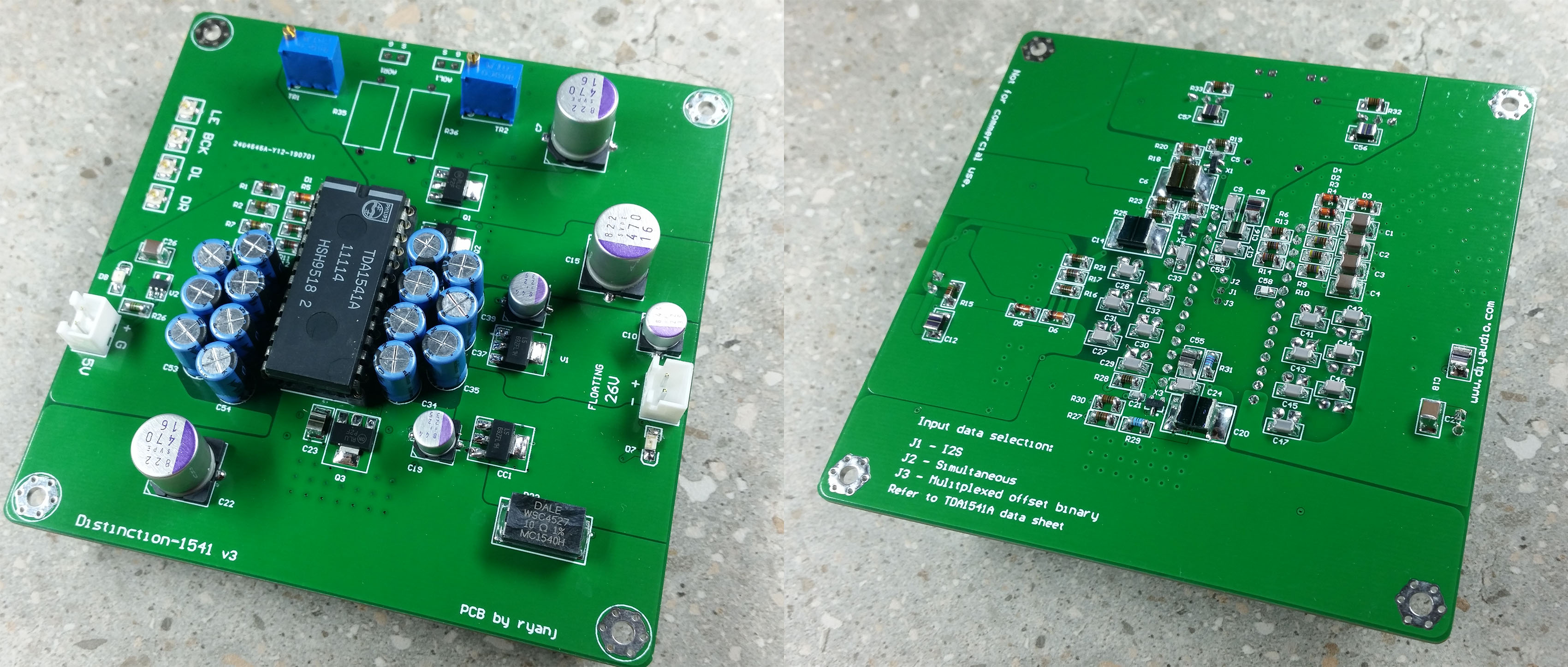

Update
D3 PCBs have arrived!
I'm currently populating one of them for a final test and then ill provide a link for the order form.
I will offer the final test PCB up for sale (without 1541A chip), if your interested please send me your bid.
Starting bid will be $169 AUD (Cost of parts+PCB). Postage cost will be calculated for the winning bidder.
I will accept bids until 15th July.
Happy bidding!
Ryan

Finished D3 photo attached.
This is a nice looking board, great job Ryan.
Couple questions, what is your preferred output stage with this ?
Also, is there a schematic for the 26V floating raw supply ?
Tia.
Thanks.

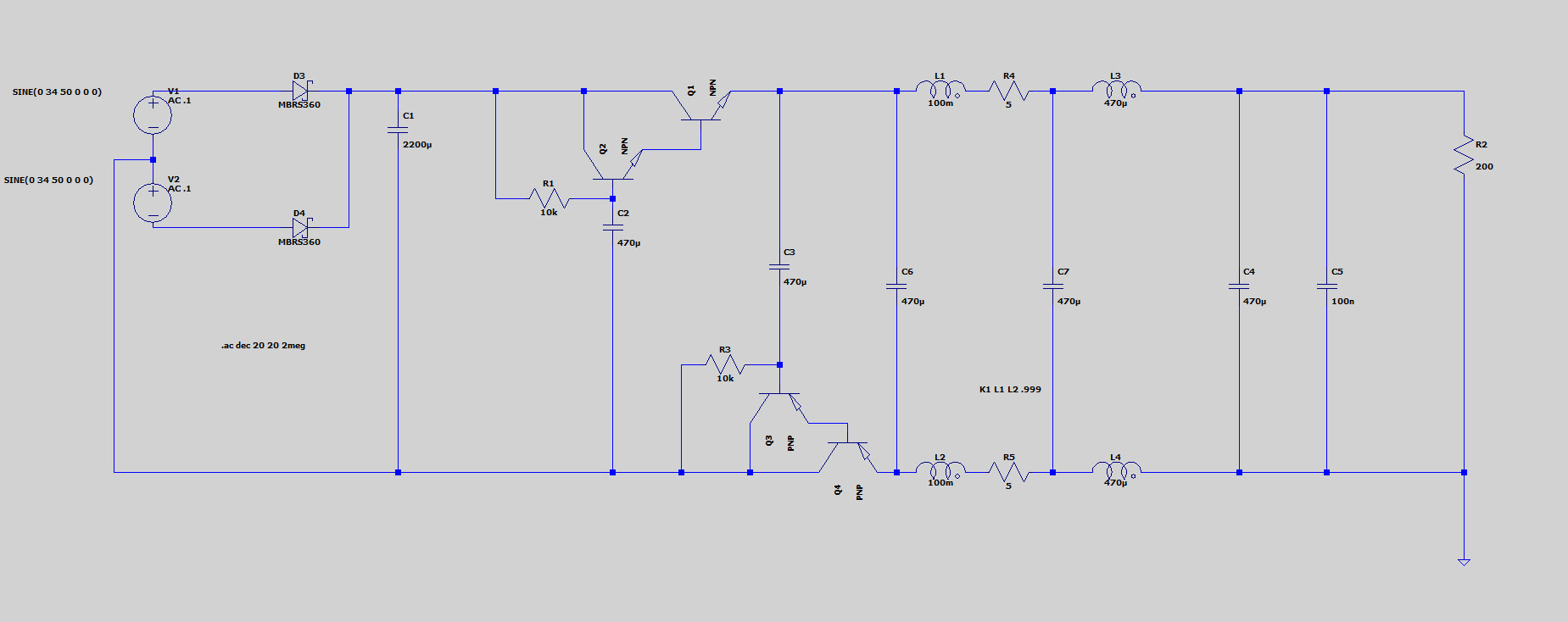

My current output stage is the CEN passive IV, which ive been using for a while now.
The 26V supply is fed by a capacitance multiplier using darlingtons in both the negative and positive lines. Attached schematic is similar to what im using right now. R2 was just to simulate the load.
For the +5V supply im using ecdesigns "charge transfer supply".
