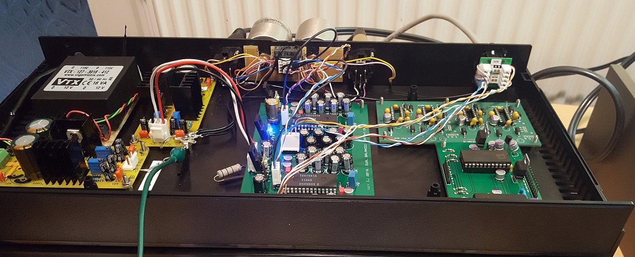

HI Koldby,
Thanks for sharing your experience in post #18
I'm curious about what BJT I/V Converter you like better than the single MOSFET and other I/V converters??
Thanks Peter
Thanks Peter
Hi Sven257HI Koldby,
Thanks Peter
It is actually one of my own design. It is a modified version of one I used for TDA1543. Discrete , no feedback and very low input impedance. I have attached the TDA1543 version so you can see the idea..

Thank you Koldby,
Very nice, I might give it try now that I am getting back into the audio hobby again...
Ur welcome, but remember to modify it. The two red LED's need to be replaced by a BC550 (in each channel) with collector and basis tied together and connected to the resistor and basis junction and emitter to ground. This is to ensure almost 0 VDC voltage @ the dac output from TDA1541A. TDA1543 needs DC voltage @ its output, hence the two LED's.Thank you Koldby,
Place these new BC550 close to the Q3 and Q1 and preferably with thermal contact.
