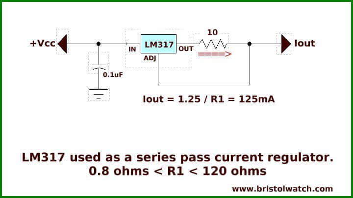

Hi Greg,
The LM317 (CC1) is a constant current source set up to output 125mA (1.25V/10R=.125A) as R22=10R.
So possibly Q3 is shorting or partially shorting and sinking too much current, exceeding the amount provided by CC1.
An explanation of the TL431/PNP shunt regulator circuit:
YouTube
If Q3 is OK, then possibly CC1 is not operating properly and not delivering enough current.
But I would suggest taking Q3 out and check it or replacing it first.
Ben
PS: Another possibility - a leaky capacitor, but I would check out Q3 first. What resistance do you measure across V-15 and Gnd? And compare with your other board?

Ben,
I just pulled Q3, voltage finally jumped up to ~17.5, then I dropped a new one in and voila, -15.01!
I have a chip installed now and letting it warm up and see if the voltages hold. So far, so good....
