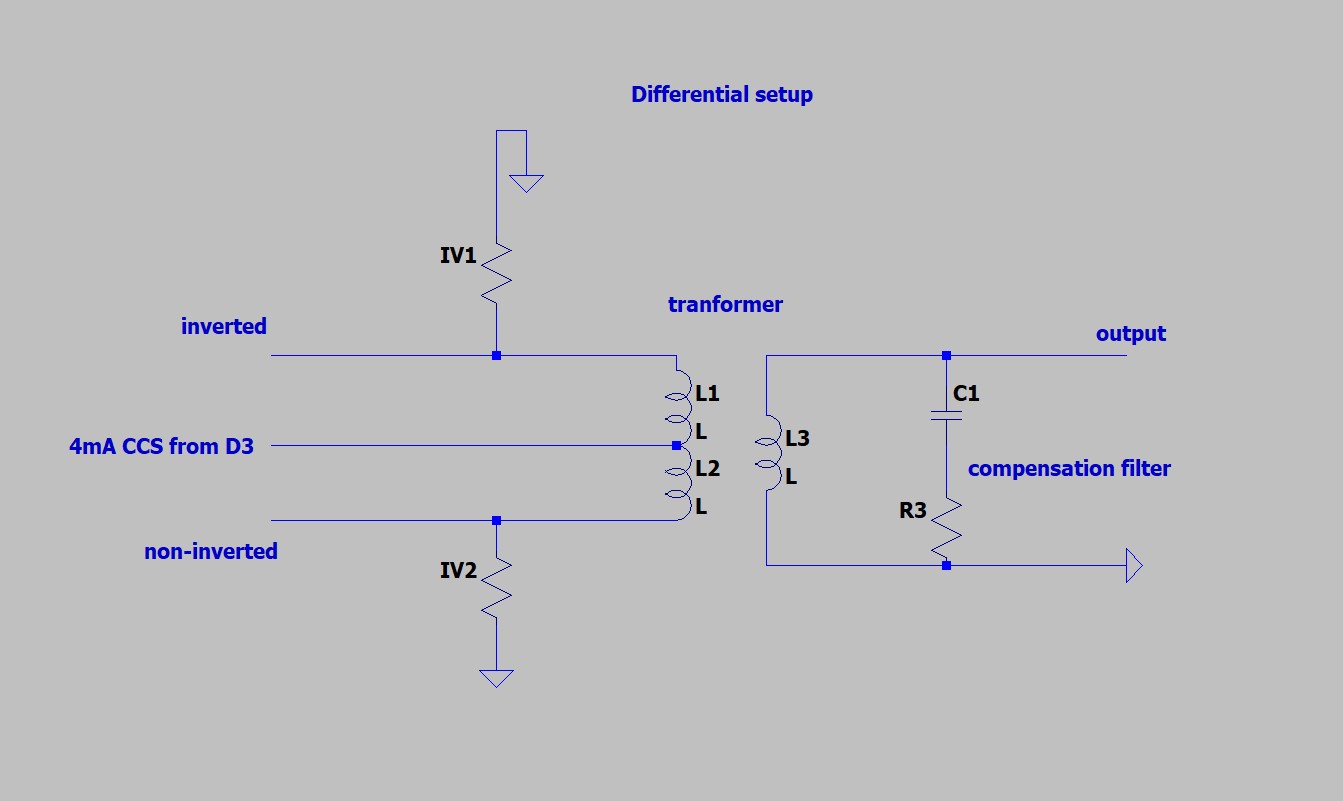

I just saw you PM to me - Are you planning on operating in parallel or differential? If running in differential mode you will need to invert the data lines, have you done this?
1st D3 needs:
LE, BCK, RIGHT DATA, INVERTED RIGHT DATA
2nd D3 needs:
LE, BCK, LEFT DATA, INVERTED LEFT DATA
Differential example
Horika,
Attached is an example of how to configure your DAC if you are using a transformer with a differential output. It seems to work very well in my setup.
The inverted and non-inverted in the example should be swapped around.
Horika,

Horika,
Thanks. I ended up. It works. I use it in differential mode. 100% made with recommended parts. Unfortunately, the jack voltage (50Hz) sits on the hand. I'm looking for the bug but can't find it. idea?
Hi horika,
Attach the GND on the secondary to the DAC GND. Seemed to get rid of the 50hz noise for me.
