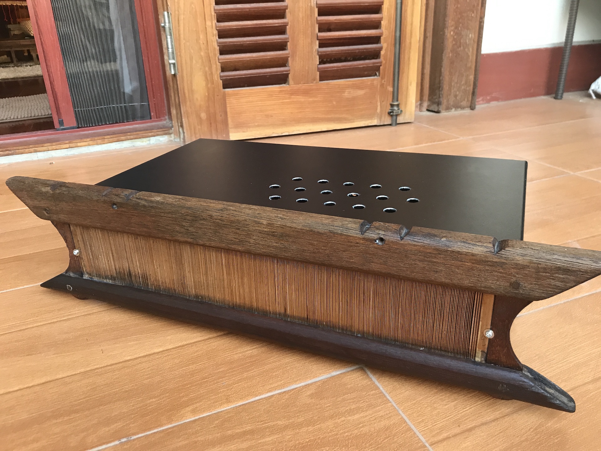

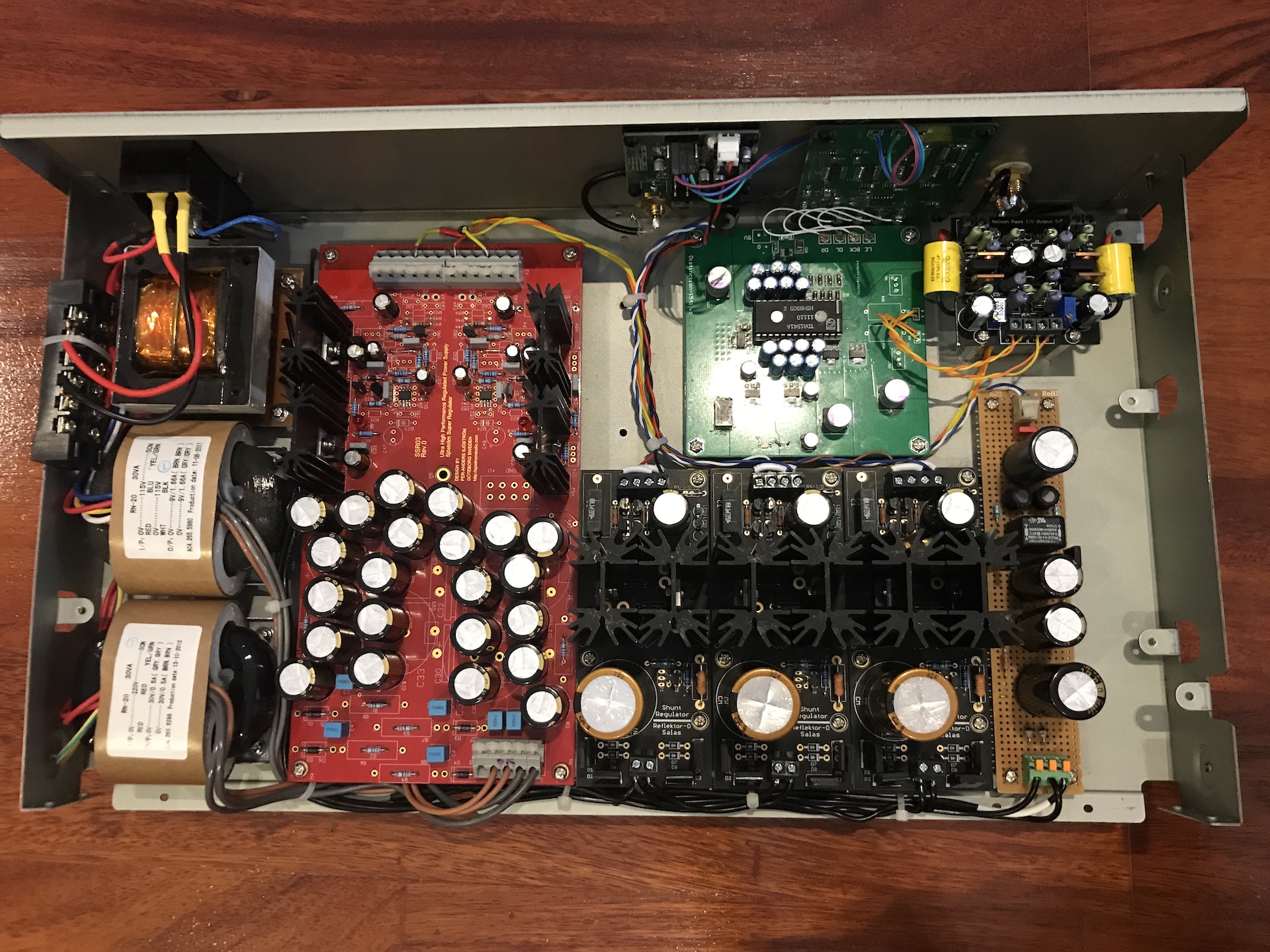

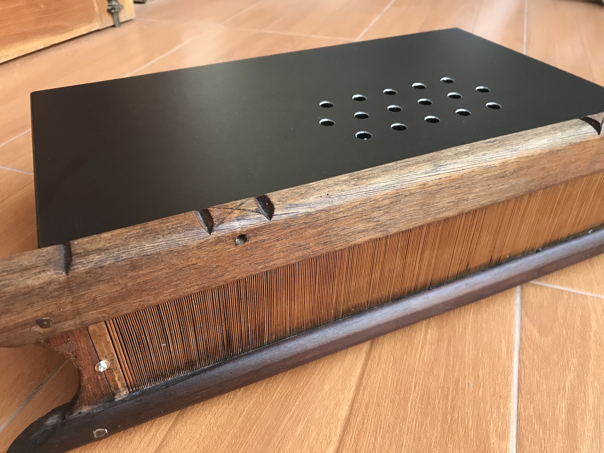

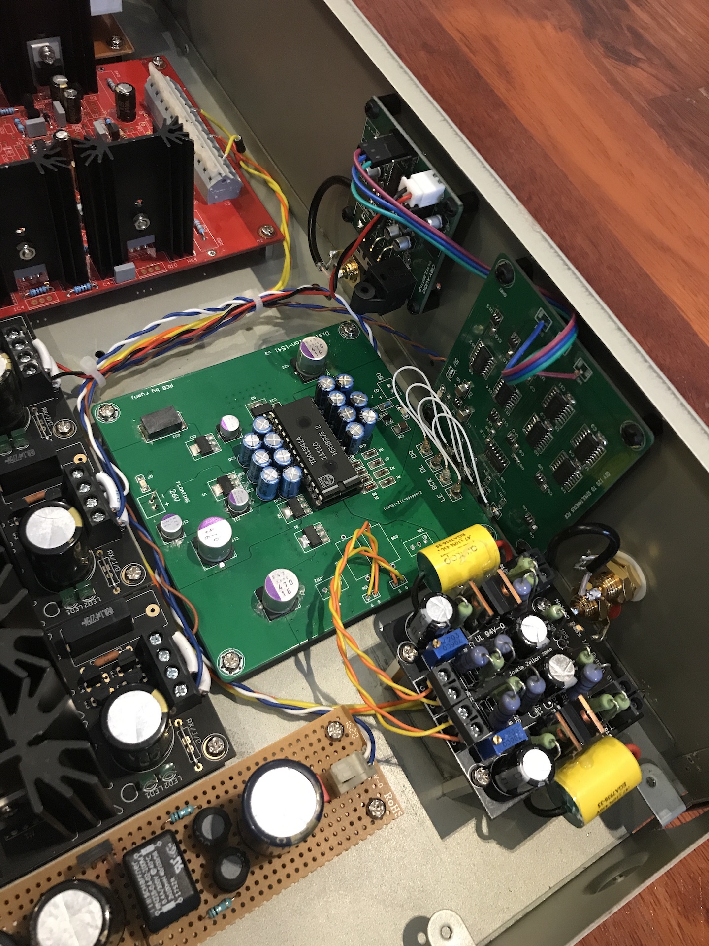

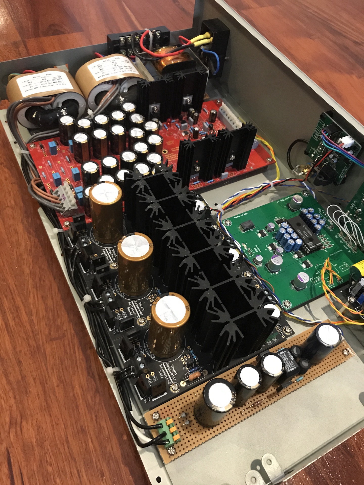

As promised some photos
The front is from a traditional Lao loom so the wood is probably teak, at least that bottom piece looks teak-ish not sure about the top rail.
I added some breathing holes to the top and because the whole front is porous on account of it being the loom piece it should draw some air there. I am happy how they came out using the step bit on my hand drill.
Before closing it all up I put in the S1 and heatsinked it; added some hot glue where I've soldered wires directly to the I2S > Simultaneous board; and slapped some SilentCoat around the chassis to make it nice and dull.
Hope I won't have to open it up for a long while - don't think there is anything else I want to do to it right now. But never say never. I've got a second D3 board .... parallel? differential?
