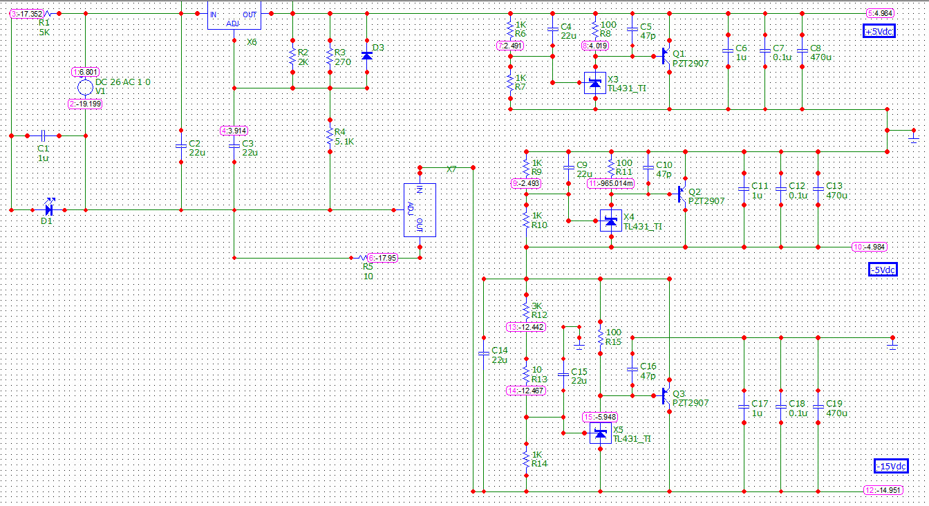

I tried simulating the power supply, unfortunately MicroCap12 doesn't have the model for LM317.

I was going to see what direction voltage flow through the 22uF filmcaps. Reason being that usps seem to have lost the package with parts my friend sent me.
I do have some nice 22uF/12.5V Panasonic polymer polarized caps (in the same package-style as a tantalum cap ) that I could use.
If the caps need to be bipolar, I could two os-con (47uF, not sure how close the values need to the 22uF) back to back.
Or I can use Nichicon muse BP 22uF.
A cap with a low ESR is needed here but I would probably stay away from ceramics, as a second choice to the film cap id probably go for a polymer. Just make sure you correctly orientate the polarity of the cap.
Interestingly, there seems to be no need for a cap in this position when running in differential mode as I just found out tonight. The power supply sees a mostly constant current draw now that the waveforms are inverse to each other so there is no need to have a supply with such a low output impedance.

The caps I have in mind first are Panasonic polymer caps, I believe these are the ones
Pana Polymer 22uF/12.5V
I also have some Nichicon Muse FG 47uF I could put back to back for a 23.5uF bipolar capacitor...no idea what that would do to ESR though.
The thing is, I don't know how to orient each of the 22uF/12.5V polymer caps. They are rather good, and now obsolete, don't wish to make them sparkle lol.

You will be right on the 12.5V rating for the -15 reg. The minus goes to -15, -5, and positive to the +5. The pads closest to the supply pins are the ones connected to the corresponding supply pins. Just use the continuity mode on your multi-meter to confirm.
I think I tried some 100u Muse caps in that position and they didn't really do the job, they only made a very small improvement, but you could just give them a go anyway. Try without any cap there first so you can compare.
For the 4.5V reg you could also use a 5V reg and it will operate just fine. The TPS7A4700 should be ok, I never really noticed much if any change in SQ when going to a great efforts in supplying a really low noise source for the attenuator supply.

Having looked at the schematic, I figured I could use LL4150 in the attentuator circuit and LL4148 in the power supply? As I wrote, I have 5 lonely LL4150 due to an ordering error.
Yeah do that.

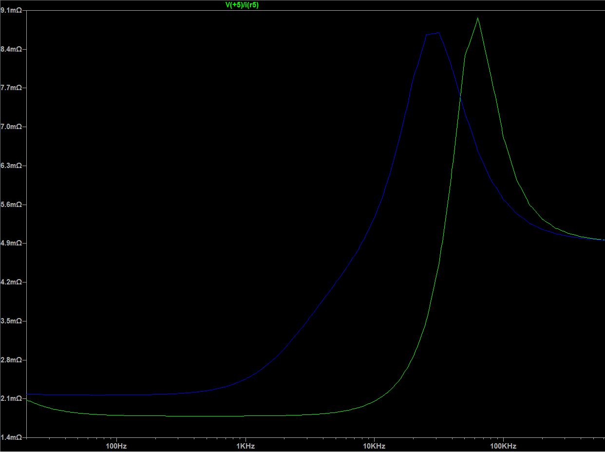

Hey, I finally found a model that worked and was able to simulate the D3 Power Supply, very nice and very close to spot on the target voltages.
BTW, I did the sim with 4148 diodes.
You could simulate the different types of caps you have and see what the output impedance is.

Ok, Ill have a go in LTspice, not quite sure what the ESR of the caps your using are though. Ill estimate a few numbers to get an idea of the change in performance.

I dont have very accurate models of either cap, but you can at least get an idea of whats going on, the blue trace is the zout of a cap with a high ESR and ESL, the green trace is a cap like the PMLCAP with low ESR and ESL.

The lower ESR ESL has lower zout higher up in frequensie.
