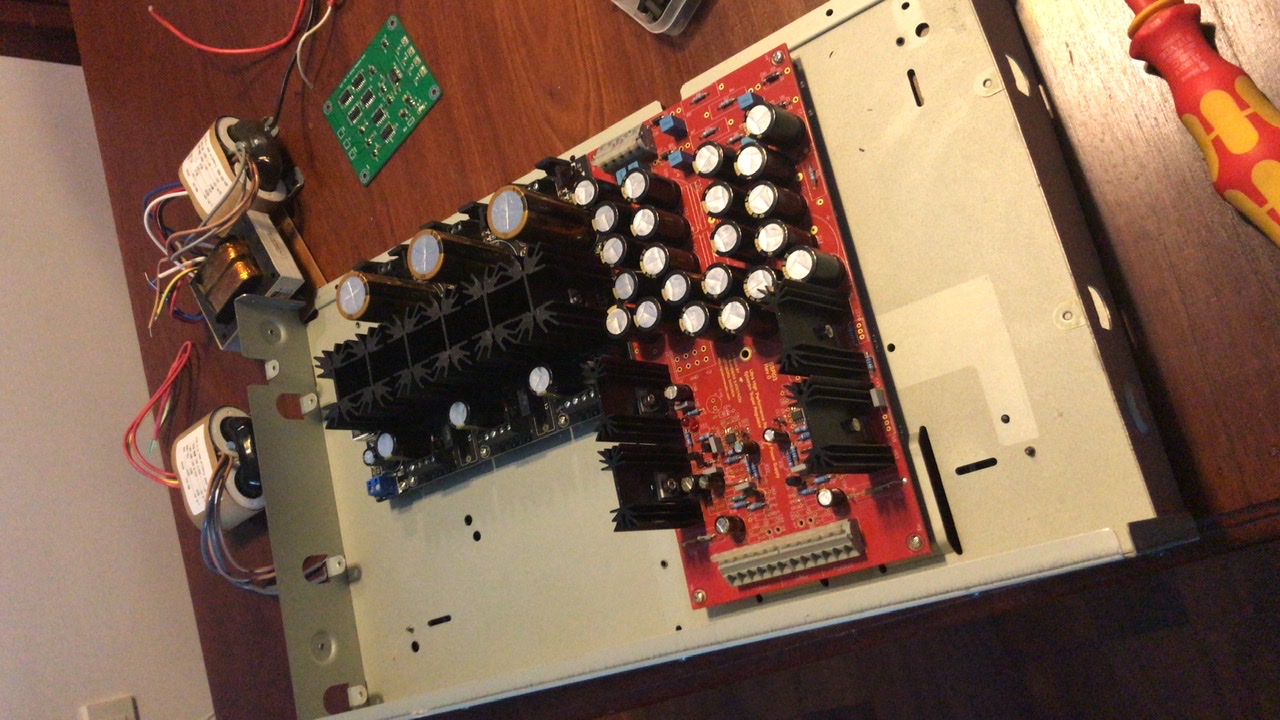

Early stages
Wife has gone away for work therefore ... the dining table is mine for the whole week!! should be well towards being finished by then.
So far in donor Onkyo chassis (be long term home but maybe not forever as I have other ideas)
Sjostrom SSR03 At 30v to power B1 output
3 x 5v Reflecktor-D = 2 for Receiver, 1 for I2S to Simultaneous
1 x 8v for the D3 board
I plan to fit D3, I2S and receiver vertically on back panel
Ok just had another look because I have D2 and D3 and now remember that D3 needs 5v not the 8v from D2
And D3 board is bigger than D2 so it is not going to fit as planned - back to the drawing board

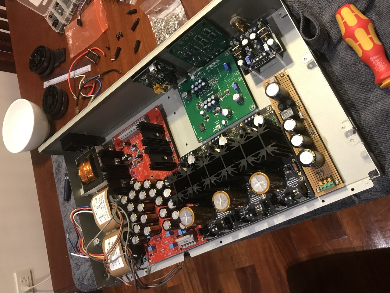

Happy with my days work.
All the drilling etc complete.
I had some ridiculously oversize output caps on the D1 and so this was giving me grief trying to fit everything in - so I swapped them out for some smaller ones which gained me more real estate
Wire up my psu and regulators tomorrow. I’ve tested them all separately already so hopefully there will be no problems. Only the D1 is completely untested.
