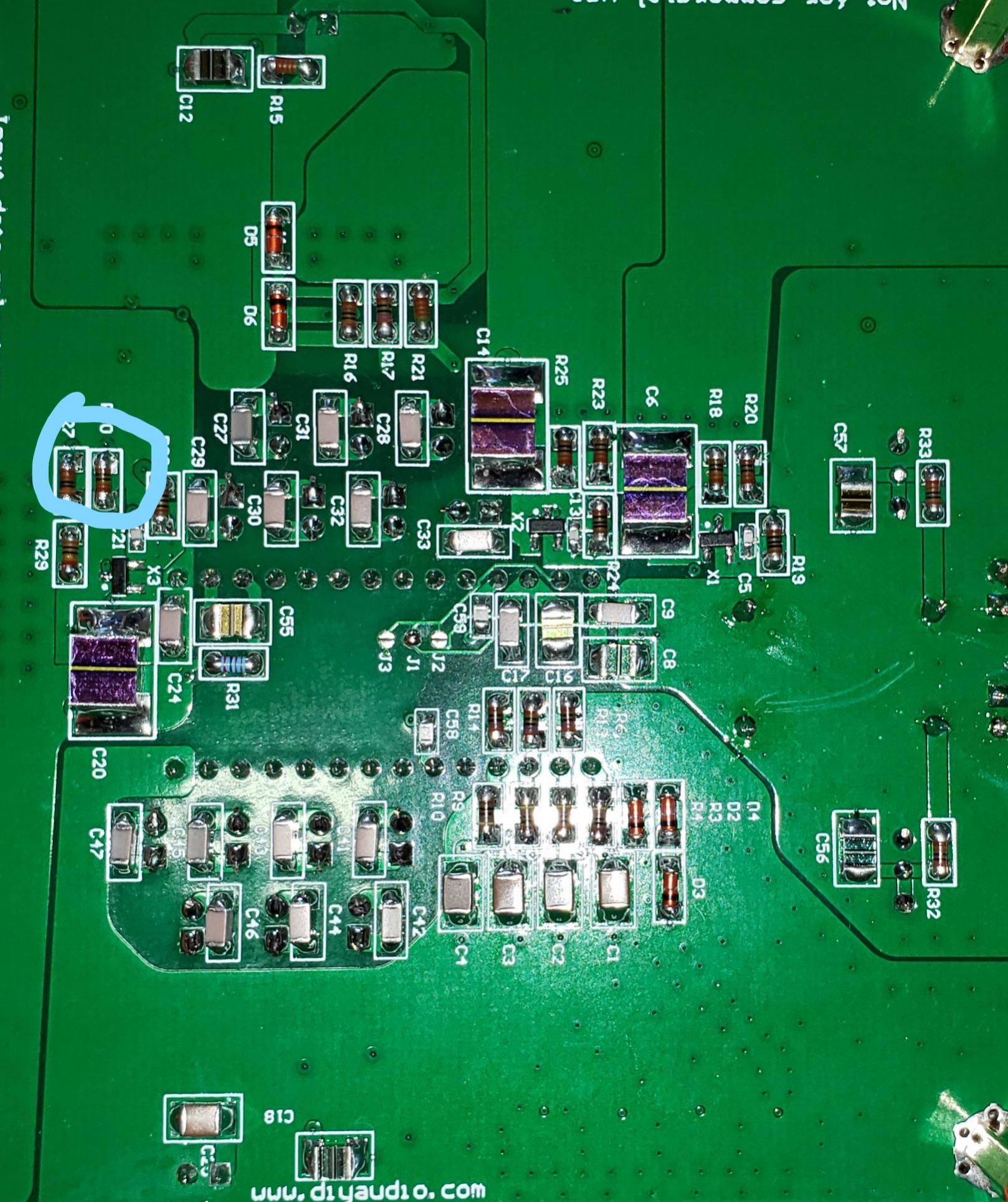

Hi Mark.
Please check r1 r2 r7 and r8. It looks like solder has not flowed on to the pads. This could be linked to your voltage offset issue.
Thanks ryan I reworked these and it seems to have made a difference in AOL. AOL seems to work now and can be zeroed but not AOR.

Thanks Ben,
With the TDA out all three legs of TR1 and TR2 show 5 volts.
With the TDA in and 2K resistors out I am getting approx 300mV across the IV resistors.
R32 and R33 test good. ~1.999Kohms.
Back together and after reflowing some spots I'm getting AOL to work but not AOR.

Hi Mark,
It looks like your are getting 5V as you should and the TDA chip is outputting 2mA as it should. That is good. So AOR not working is likely due to bad solder joint in the area of the pot, 2K resistor, and C56.
When you say AOR is not working, what did you do and what result did you get? It's hard to trouble shoot without information.
Ben

Hi Mark,
The Output bias circuit is very simple with only a few parts. If 5V is being delivered and the TDA chip is outputting 2mA, then something in the circuit is not working properly. It could be solder connections, or pot not working properly, or C56 not working properly.
You have already checked the 2K resistor. You also had measured 0.3V across the IV resistor when the 2K resistor was out of the circuit so the IV resistor and parallel capacitor are OK, and the TDA chip is sending out the 2mA current.
You can desolder the pot and test it out of circuit. You can desolder C56 and try the circuit without it. The circuit will work without the C56. Or if you have a capacitor tester, you can test it when you have the pot off the board.
Also check the solder joints again.

I desoldered C56 and it checked out at 1uf and I've desoldered and checked TR1 and it checks out at 1K.
I've desoldered and replaced C58 even though it tested good at 154pF. I've now tested everything in the Bias circuit so it must be somewhere else.
