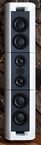

The two 11” bass drivers are high-ohmic, thus OEM drivers and the diamond tweeter most likely OEM too.
Developing cabinets and crossovers may take months, so it may be cheaper to buy a pair....
Without the correct drivers we can’t clone the Mårten design.

Basically he said F you. I felt like that would be his reply because he would assume his time is worth more than YOU could afford. he makes pretty speakers... Anyone with some opamps can do as well sonically. F him. lol
