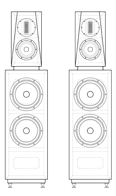

If you go fully active, then a speaker like your dream speaker would require 4 stereo amplifiers to get 8 channels of amplification, or you could get a couple of 5 channel theater style amps and use the 2 spare channels for subs.

6 Yes, the split box. That only has use if you actually place the subs/woofers in a different location in the room. Else it may as well be a single box, otherwise you are just getting extra complexity, but maybe better looks?? Given the pic you have and nothing else to go on, those are 'just' woofers, and so cannot be placed in a different location (they have to meet the mids you see), so no benefit at all from the split box, tho no doubt a good marketing department could convince you otherwise!
So in this cae, NO, definitely not better sound if they were split and located differently! Even then, what are you going to put the head on?? You need to make stands yada yada. Think you might have the wrong idea on that one.
Yep you'll need extra amps., active is kinda defined as any driver connected directly to an amp. So fully active means as many amps as driven drivers. You can do it in stages if you wish, add the subs for now (with it's own amp), keep the passive crossover in the mains. Maybe later make the mains active too.
BTW, I don't buy the 'active is necessarily/always better than passive'. If you have a good well sorted passive crossover, and you like it, personally I'd stick with that. Going active per se (with behringer etc etc) I don't think brings as much benefits as theory says it should.
BUT, using good dsp active does, but that is another ball game.

6: This is my dream design!!! :
See the split in the middle I made, to seperate the bass-box and the tweeter/mid-box.
Better sound with the split/seperation?................
