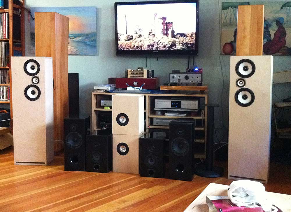

Don't need to imagine, i have an MTM speaker right behind me with a mid-tweeter that runs from just over 300 Hz up to over 30kHz.

other type. Fostex FF85KeN. And the new iteration of the FF85 so far has shown itself to be even better. IMO, getting the XO down to where all the drivers are within a 1/4 w/l of each other makes a big difference.

How is the dispersion of the FF85 vs a good dome tweeter. The other issue (minor) is that the FF85 is limited in SPL (Xmax and power handling). The old one was limited about about 10W.

i have a similar experience with 'typical' fullrangers, and this is the reason i tend to stay away from most fostex. My experience with these 'mini drivers' or extended range drivers between 2 and 3 inches is different though. The tangband w2-800sl for eg is fairly wide dispersion and doesnt beam to my ears any more than a conventional dome, could be xo'd below 1k with ease, and most importantly, sounds rather good. This is in comparison to my reference system which uses visaton g20sc 20mm soft dome. This tw is near as ive experienced for smoothness of fr, within +/- 2dB Across its range up til 15k. Undoubtedly an AMT would be transiently better, awkward to cross, and too expensive for me. The alpair5 has very good dispersion but needs some filter work around 5k, and the tangband w3-1285sg is similar, except more directional and can manage without a notch.
Ribbons and the like are nevertheless attractive, but for me its an exercise in economy: which driver would i rather cover the range 3-6k? Easy since i havent found a woofer, yet, that sounds quite right in that range. That leaves the tweeter to deal with it, the problem then is to drop the xo below 1k. Dome mids just havent met the standard in my experience, so that leaves a SMALL wideband driver as the obvious solution for me.

Dispersion is very good. One can consider the FF85 to be a 3/4" tweeter with a very big surround. We have not had any issues with SPL with any of our builds.
Xmax is not an issue when XOed above 300 Hz, and dyamic power handling is much higher than the 10w rating. Now if you are running it down to its limit (about 100 Hz) it will have issues, but still surprises almost everybody.
