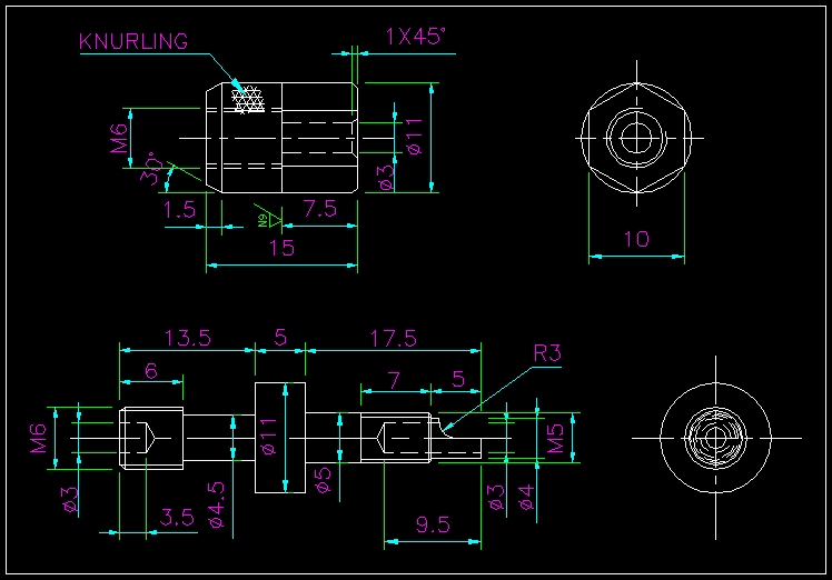

For starters the thread are too coarse, the cardas really stay when you bolt the spades in, these guys I am not so sure.
Then as Peter says there is no way to prevent them from rotating both when fastening them to the panel AND when trying to tye the spades to them.
They seem coarse indeed. While Music Posts don't have such a fine thread as Cardas, I didn't observe a problem with them to stay on. But it definitely a nice feel to Cardas, when tightening the nut. Feels like precision mechanism.😉
It is important to distinguish between the thickness of the threads vs. the pitch, . In this case I believe that the threads are massive, which is what is required for soft material such as copper but the pitch(how far the nut advances per turn) might be small.These two characteristics can be independent. IMHO this is the correct approach. The only risk is that they won't have enough inherent friction to stay tight. (vs. too fine a thread having so much friction that they jam) I guess you need to try the prototype.
Variac said:It is important to distinguish between the thickness of the threads vs. the pitch, . In this case I believe that the threads are massive, which is what is required for soft material such as copper but the pitch(how far the nut advances per turn) might be small.These two characteristics can be independent. IMHO this is the correct approach. The only risk is that they won't have enough inherent friction to stay tight. (vs. too fine a thread having so much friction that they jam) I guess you need to try the prototype.
I was referring to the pitch of the thrad which is not really independent from what you call thickness. A narrow pitch thread will always be shallower than a coarse pitch thread for simple reasons of the way cutting tools are.
Anyway, it shouldn't be too bad to add a couple of flats on both the knob and the shaft so one can use two wrenches when bolting to the panel and bolting on the spade.

Bricolo said:...could you post a diagram for your posts? with the dimentions and everything
Why not !! If require the AutoCad drg they email me.

My aim is to make available these posts on a non-profit basis to DIY’er on this forum. Any commercial intent beyond that will brings different issues. As DIY’er we can compromise a bit on certain things, which an average buyer may not be prepared for. I’d really feel great if DIY community can suggest changes on the basic design.
Grataku:
I think Variac got it right. The dia of the thread is large and the pitch is 26tpi. Soft copper threads may disintegrate otherwise. They appear coarse because they were machined. In the copper proto I’ve use threading die. The best option will be to tool up an get the threads machined on a CNC. But then we are moving onto proper production systems. For a handful of Posts such tooling and fixturing may not be cost effective. I have not yet don a costing, but if the numbers justify then we may go in for a CNC tool up. The nut has hex base.
Peter Daniel
There are several DIY ways I can think of to ensure that the posts remain tight. The Music Post method is ok if we go for a commercial venture. Do let me know if you want this way.
