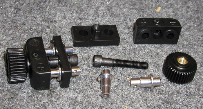

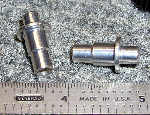

Just got those new design Cardas binding posts today, and I'm quite impressed when I actually had a chance to play with them for a while. Looking at the pictures on Cardas site they seemed a bit ackward, but in reality they are quite cool. Although it is a patented design, it may bring some inspiration to some more inventive diy members here, as doing their own binding posts according to this principle would be much easier. Basically all the parts can be made out of acrylic or some other hard plastic and the only metal parts are the Allen bolt and two pieces creating the contact area (good for spades only).
As Jonathan mentioned before, that type of design eliminates the metal nuts (which could be good), eliminates the tention from the posts, and creates shorter path through the posts to subsequent wires. They are also very easy to tighten or open (no special wrenches required anymore) as the large knob simplifies that. The knob comes in a variety of custom designs.
http://www.cardas.com/oem/index.html
