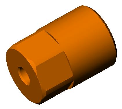

McMaster info was for local people who might also get inspired by that thread. 😉 For me, it's too expensive to get them machined locally.

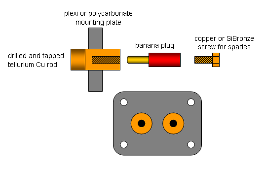

McMaster-Carr also sells oxygen-free copper (Alloy 101) and chromium copper (Alloy182 Specialty) also looks interesting but expensive. You might think about just using a standard rod size and only maching two opposed flats on the end for mechanical tightening. This would cut down on your machining costs. 😉
Im curious how you think you will be terminating your speaker cables. Being that your ready to take the leap and machine your own hardware, you have the opportunity to build something optimized for your needs.
The direction your heading looks great. I would expect that your using spade lugs with them. Have you considered over sizing the nuts or adding a knurled section to them to make them easier to hand tighten?
A very simple nut could be made by putting a threaded hole in the center of a piece of bar stock. It would be very easy to finger tighten. This of course will increase the spacing between the posts.
Peter Daniel said:He said, he expects the cost to be around $2. It is much less than Cardas. Comparing to Cardas, yours don't accept banana connectors, but this is not a big problem.

My current set of speakers have the lead soldered onto the cross over directly. But I think this binding post can be utilised at the speaker end as well. Please comment on this.Da5id4Vz said:...how you think you will be terminating your speaker cables.
Thanks for this very clear drg. Ok now I get it. Its either banana plug or the spade.ultrachrome said:.... here's a shot of what it might look like.

I think the majority of peole use spade connectors on their speaker leads. Maybe that's all you need to accomodate

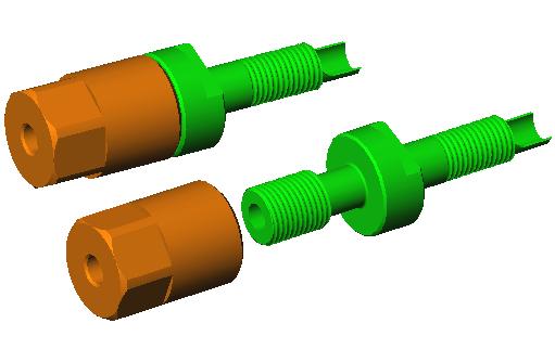

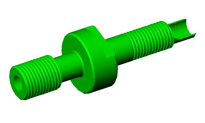

That is exactly what I think. A pure DIY approach. Having said that all efforts must be made to ensure a top notch build quality as well. After all we are cloning a Cardas here 😉Variac said:If perfectly functional but not as well made then they might be still desireable but have to be cheap.
I now have a pretty good picture of the Cardas specs (thnks to Peter Daniel), so should be able to present a revised drg for your approval soon.

Corbato: Based on my own informal listening tests, may I suggest that you make the nut from a non-conductive material? For the nut portion I would suggest materials like micarta, delrin, vaalox, and polypropylene.
