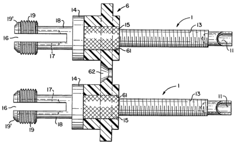

You might find the Eminent Technology MusicPost Patent of interest.
<a href="http://164.195.100.11/netacgi/nph-Parser?Sect1=PTO1&Sect2=HITOFF&d=PALL&p=1&u=/netahtml/srchnum.htm&r=1&f=G&l=50&s1=4764127.WKU.&OS=PN/4764127&RS=PN/4764127">United States Patent 4,764,127
Price; Edison A, 16/08/88 </a>
<i><font color=#804040>"Further, the above-mentioned components 1, 2, 3, 4, 5 are machined from grain-oriented tellurium copper rods, with said orientation identified by the mill of origin, and in recognition of the fact that the electrical conductivity of this material is directional with respect to the orientation of said grain. By manufacturing all these components 1, 2, 3, 4, 5 with attention paid to the orientation of the grain and hence the optimal direction of electrical conductivity, said electrical conductivity and hence sonic properties may be further maximized." </font></i>

As to mechanical design, I've been using both Cardas and Music Posts and find Cardas much more convenient and user friendly.
Jonathan, did you compare unplated and plated copper posts and do you have a preferrence here?
Peter:
>As to mechanical design, I've been using both Cardas and Music Posts and find Cardas much more convenient and user friendly.<
I agree. The shaft of the Music Posts tends to collapse in upon itself, and when it does, the nut no longer screws on properly.
>Jonathan, did you compare unplated and plated copper posts and do you have a preferrence here?<
Yes, and for my personal use, I prefer unplated copper, because it sounds better. But this is with the caveat that the copper will be polished periodically and kept in clean, untarnished condition. For a product that will hopefully be used by a wide variety of people, and perhaps even the odd amplifier/speaker manufacturer or two, I suggest plating the copper.
Gold plating is OK for a short time, but it is soft and can be scratched off relatively easily. Silver turns brown-black due to sulfides in the air, but is sonically better than gold. And it is somewhat cheaper to apply than gold. If Corbato goes with silver, I would suggest reinvesting the cost savings in the form of thicker plating, which will last longer.
Rhodium plating is much stronger than either gold or silver, and will result in a much longer-lasting finish. But it is also more expensive than either gold or silver. I mainly use rhodium for my own products.
So there are the trade-offs. You guys decide.
BTW, can I propose an alternative, "reversed" construction? How about designing the binding post along the lines of a screw-type terminal strip?
I would change what Corbato currently has as the metal shaft into a simple conductive plate structure, with a hole drilled in the center which is sized to accomodate a banana plug, and then tapped. The flat outer face of the conductive plate would provide a mating surface for spade lugs, while the inner surface should be formed into some type of grooved or extended shape that makes it easier to solder cables without requiring 50W or 100W soldering irons. This conductive plate would be captured within a non-conductive sandwich which would form the mounting surface to the amplifier or speaker. What Corbato presently has as the outer "nut" would be changed into a non-conductive "cap-bolt" that screws into the conductive plate, and can be screwed completely in (for spade lugs), and removed completely (for bananas).
This reversed construction would minimize the mechanical stresses on the conductive part, making it easier to use softer (purer) copper alloys, and will also minimize the amount of conductive material used (which in my experience is usually good for sonics). The outer surface of the conductive plate would normally be covered by the cap-bolt, slowing down oxidation, and since the conductive surface would be completely flat, it could easily be polished and kept clean. The inner conductive surface would be a soldered connection, and once the cable was soldered in place, oxidation could be ignored.
I reckon that the only real downside is that although bananas would work, they would be able to contact the conductive plate only through the raised edges of the screw threads, which is far from optimal. Depends on how important you think it is to try to get top-notch performance from bananas (personally I consider it largely a waste of time).
Comments and objections welcomed.
regards, jonathan carr

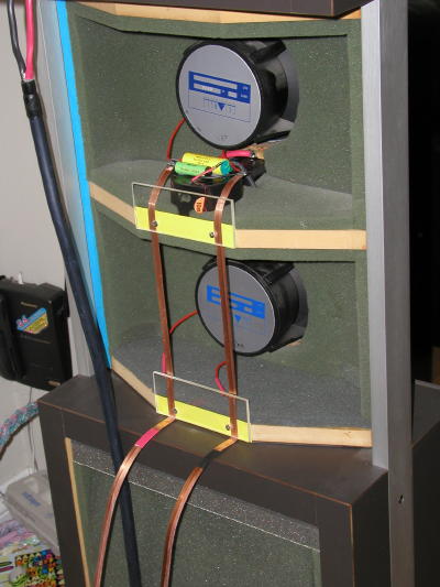

Are we here into something big, I mean the ultimate binding post?😉
While I also don't care much for bananas and consider them inferior connection, one way in avoiding the contact on bananas through the tapped groves only, could be tapping the hole to a certain depth only (maybe a 1/4"or slightly more) and leaving the rest of the hole untapped, with a size for banana connector.
Jonathan,
you read my mind, I am working on a binding system similar to what you described, hope to have photos posted by the end of next week.

why binding posts. as a DIy we can bypass posts altogether. i solder direct from woofer termail to XO and from XO to amp. If I need to disconnect I use a solder rod (it helps that my per & power amp are home made too).
