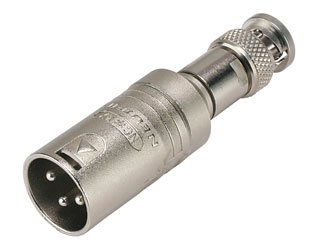

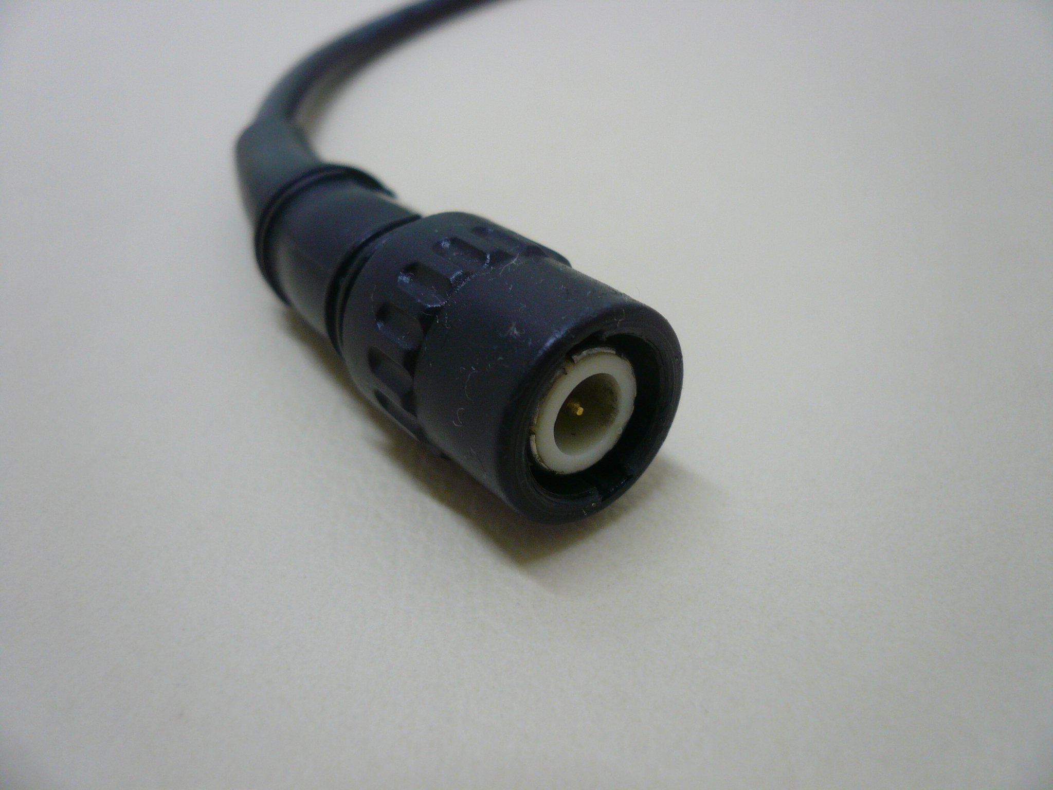

So, LEMO is the name... I have this type on a medical laser device. Very good, but the voice in my head told me to stay with BNC. Another device for ultrasounds has a very nice insulated BNC. This I would by if I could find.

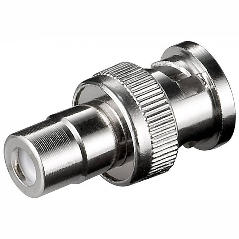

Thanks but what I'm looking for is the male connector that goes to the cable and the particular has the twist lock made of plastic. Good for testing signals with DC offset -this soundcard can handle 400V DC. Even more useful for a DIY tube curve tracer that is designed to work with the oscilloscope. Although it's floating and properly grounded when connected, it's there to bite when you hold it in the air...

Apologies for my misconception, I thought that BNC is the standard and then adapters like these

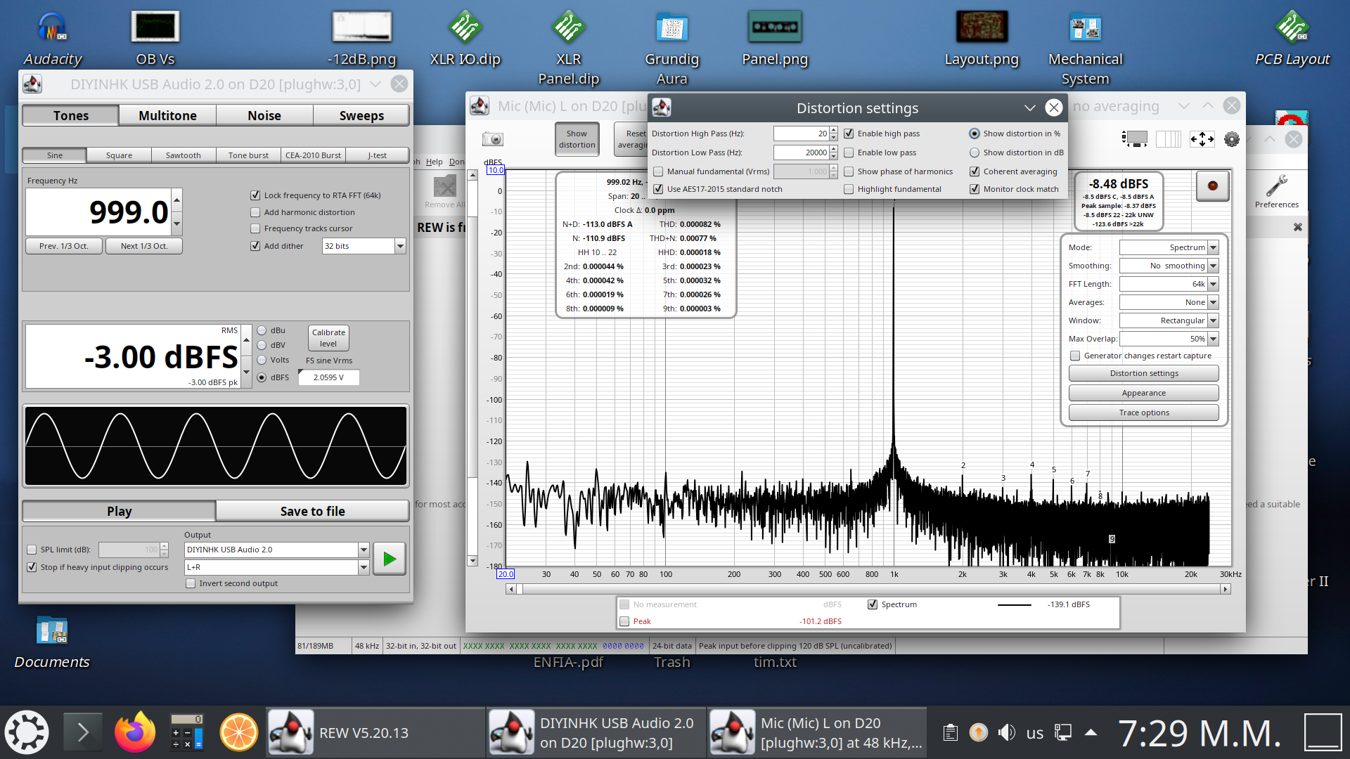

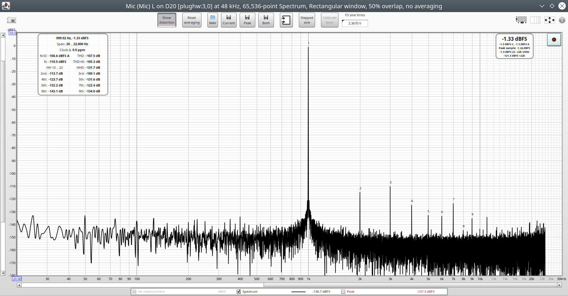

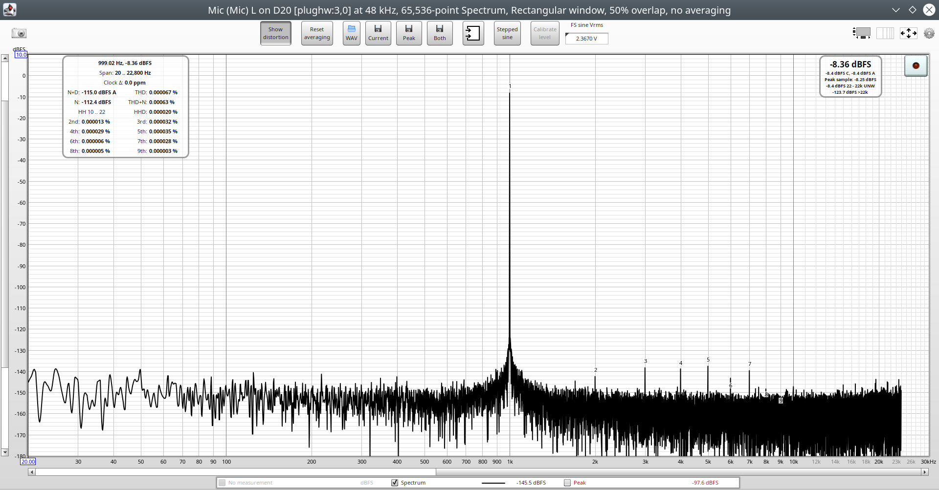

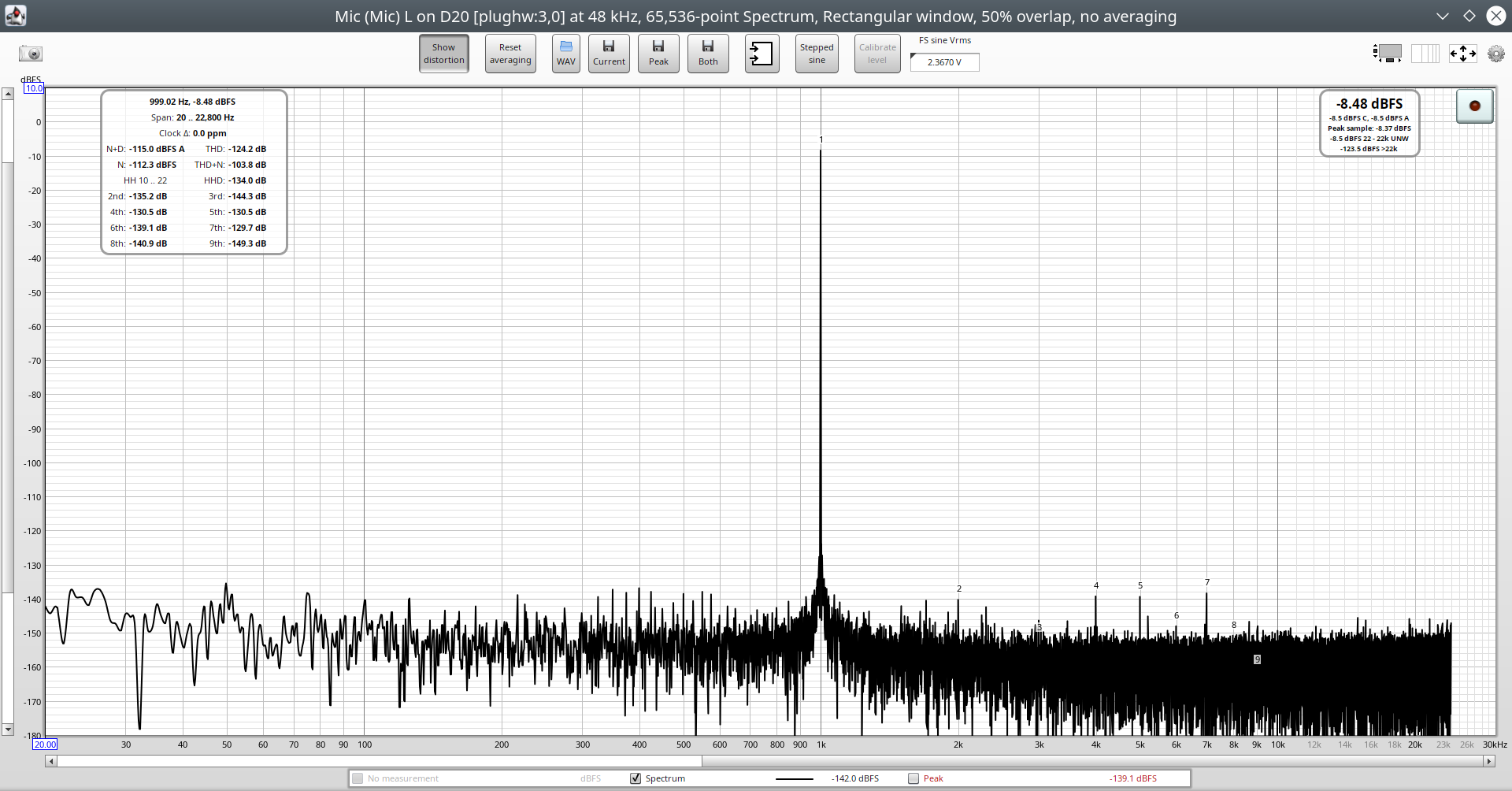

Sweet spots... I get a new one every time I attempt a re-calibration. I tried to move it to hardware domain. I increased the I/V resistors and/or reduced the output buffer gain. Result was just a new sweet spot... This is not what I had in mind. With the first version, I enjoyed most to crank it up at full scale for best figures. Anyway, I call this version an overall upgrade in terms of performance, simplified construction and not least, cost. I'm posting today's sweet spot. 🙂

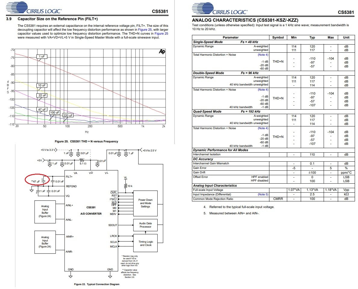

I replaced the 1μ output polypropylene caps with 10μ MKS2 and I'm happy to see that the low end bandwidth is restored without signal degradation. I didn't try better regulators. What would you suggest is the limit of CS5381 without notch filters and the alike?

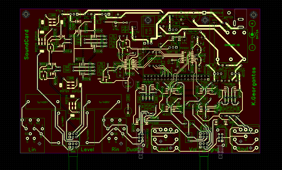

This is how the XLR option is shaping up. PCB dimensions are 183 x 110 mm. I had the chance to improve the layout a bit more and move the two opamps from the bottom side to the top. To the low left are the input XLR/TRS compo. Only pins #2 and #3 or tip and ring respectively are connected. No ground at any pin, not needed. For SE, connect the DUT ground to pin #3 or ring. To the low right are the output XLR but also there are pads for neutric style TRS. You can solder either of these two. Actually, both can be soldered, XLR on the top and TRS on the bottom side. Here ground is needed for SE output but may cause problems with balanced, so the bal/unbal switch is renamed to float/gnd. It connects pin #1/sleeve to ground. Pins #2 and #3 are always hot and cold.

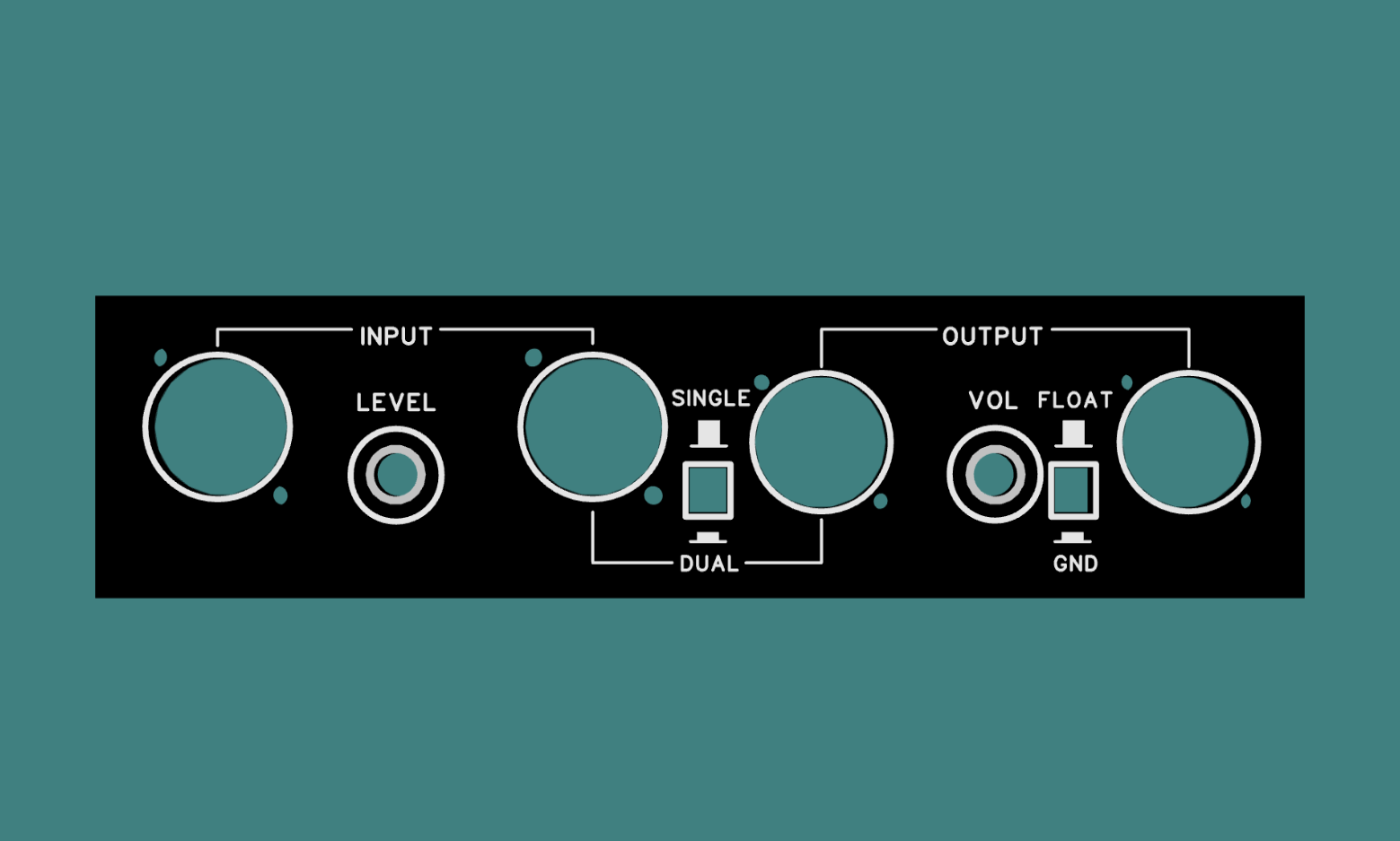

FWIW, I also designed a front panel with generic dimensions 200 x 50 mm. No channels assignation. Left is to the left, right to the right, or Arabic numerals.
Please let me know your thoughts about it.
With such conservative FFT settings, I read your measurements as very good !
