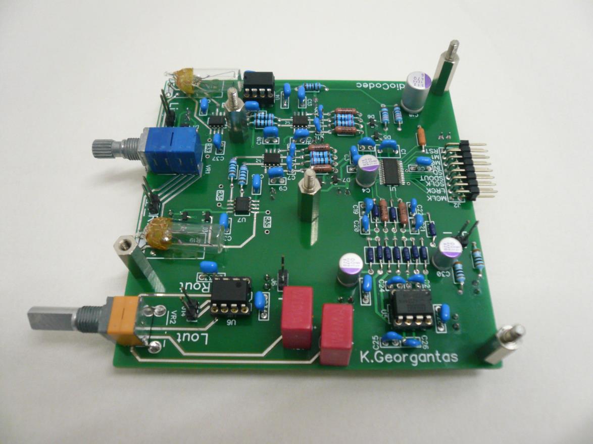

DIY soundcard intended for measuring amplifiers
