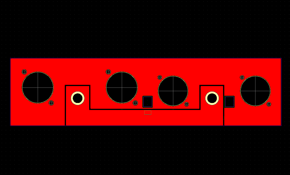

I understand. There are two criteria that do not meet easily. The circuit ground should not touch mains earth, while it should connect to the potentiometers' shafts. The first soundcard was put in a chassis with the power supply built in so it had to be connected to mains PE. The potentiometers were then connected to circuit ground and insulated from the chassis with nylon washers. This soundcard is designed to use external psu so it doesn't need mains PE. That makes it very handy to connect the front panel - and the whole chassis- to circuit ground and be done with it. In this case pin #1 is both chassis and circuit ground. If you are going for a custom chassis you should improvise so that these requirements are fulfilled. The question is where commercial XLR to RCA or TS adapters -if they exist- connect ground coming from the SE end, to pin #1 or #3?

So, switch returns as bal/unbal and connects pin #3/ring either to cold or ground. Pin #1/sleeve currently stays not connected to anything. I see the standard XLR to RCA/TS adapters to short circuit pin #3 and #1. And then, there is the neutric ring pin "G" also not connected. Depended on chassis/front panel configuration as explained in post #181, you could bridge pin #1 and G with a short wire marked on the bottom side. What do you think?

That assumes pin-1 and the housing of the XLR socket is always connected inside the plug or the cable. Is it?Pin #1/sleeve permanently attached to chassis via XLR socket ring.
I'd simply follow the standard procedure of connecting pin-1 to the chassis.

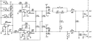

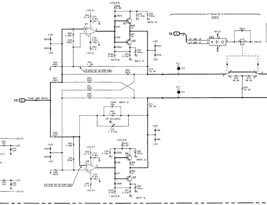

The output driver addresses a lot of connecton issues. I believe it is decended from the output driver of the HP 8903 with a self balancing circuit that adapts to a balanced drive, or short the - to ground and the output voltage adjusts to stay constant. It can also deal with ground loops if the low side is not grounded. The circuit actively senses the voltage differential at the load.

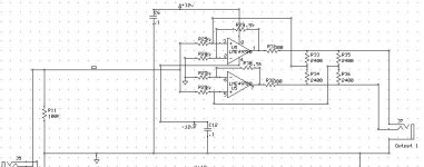

I didn't know about HP 8903. Here balanced output is straightforward from the DAC. The driver can do conversions but it's not asked to. Although it can stand outputs shorted to ground, for SE I prefer to move XLR pin #3 to ground leaving the driver's negative phase disconnected. It will deliver the same THD+N context but it can't keep constant levels. Ground loops are addressed by the ADC input and the isolated psu.

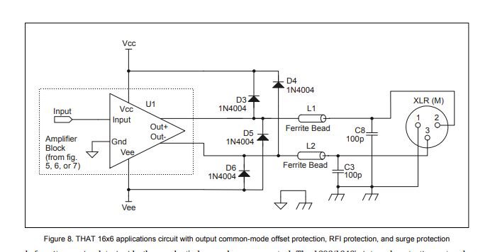

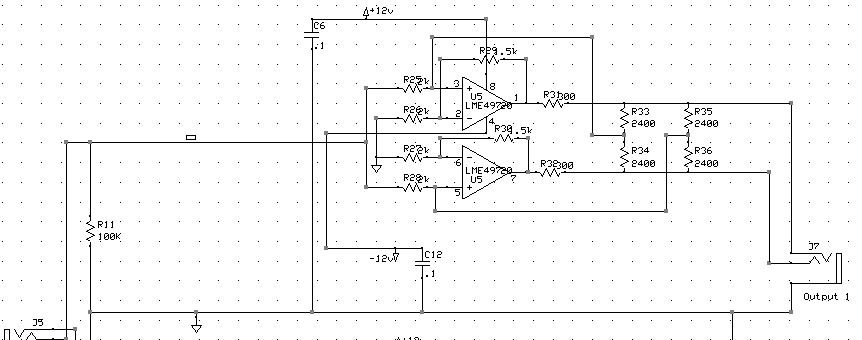

It's true the output is unprotected unlike signal and power supply inputs. There was not any protection in the first version either where THAT drivers were used. Not even common mode DC offset compensation. I think DC offset and RFI are not an issue since interconnects should be kept short for this job anyway. I understand that the diodes alone are good for a surge of an accidental 48V phantom power connection. Adding current limiters for more robustness defeats the purpose of this soundcard. That said, it's easy to add BAV199 diodes, but it should be made clear that it's not a forgiving protection.

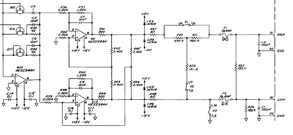

The output circuit schematic is in service V2 for the HP 8903. I clipped it and attached it below. Also a variant I made for the QA400 output. And the output for the first gen Boonton 1120. (Boonton made it to steal some business from HP in a complex military instrument setup. Its still in production.) What is neat is that if its set to drive 1V it doesn't matter if the load is floating/balanced or single ended with the - out shorted to ground. it will still be 1 volt. I find that to be very useful. The later Boontons made the whole output circuit + oscillator float. AP uses an output transformer to isolate the output but AP can still get you confused on what the output voltage is between balanced and unbalanced.

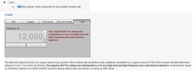

Then, I noticed REW software provides J-test. I did that too (x8 averaging).
