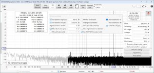

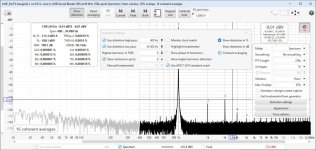

Jitter (phase noise) broad topic is not something I tend to explore here now.
Only a tiny bit of it:
Possible altering the jitter cancellation when loopback testing a soundcard through adding time delay on the analog signal of DAC-out/ADC-in.
On a specific implementation frame:
Just one sound card with it's DAC and ADC (Kosta's V2).
A few RGB58 cables of various lengths connecting the analog DAC-out/ADC-in.
REW's J-test at 44k1/16bit
If something comes up from those few tests, I'll report here.
