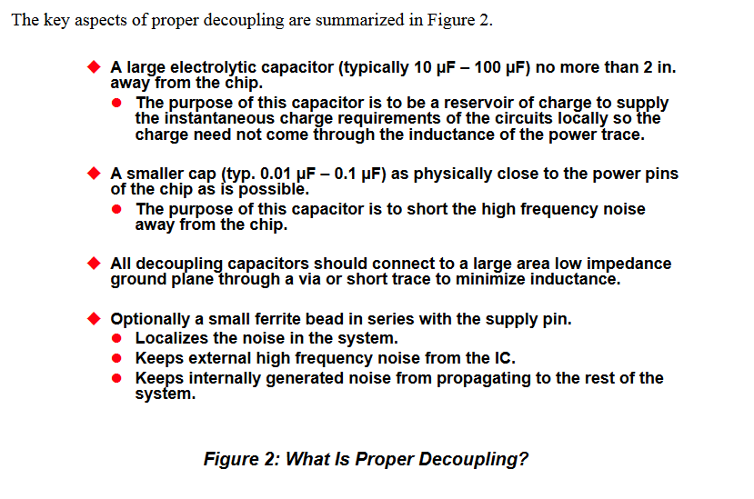

Actually going back and looking at the schematic, you have 0.1uF bypass on the opa1656 but no local resivoir caps. 100uF on each of + and - perhaps?
See below from Analog Devices app note on proper decoupling of opamps. https://www.analog.com/media/en/training-seminars/tutorials/MT-101.pdf

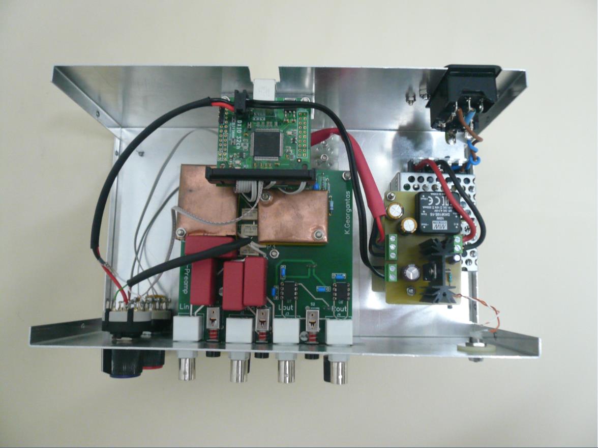

I've been sniffing on the psu last night. I took some FFT using another sound card. Trying to set up all this I found something interesting. While the XMOS psu -a simple LD33V regulator feels fine floating from gnd, the main psu with the LT3042/94 regs -the bottom deck- was very upset while taking these measurements if not grounded to chassis/mains PE. I need to see why is this happening. I'll be back.

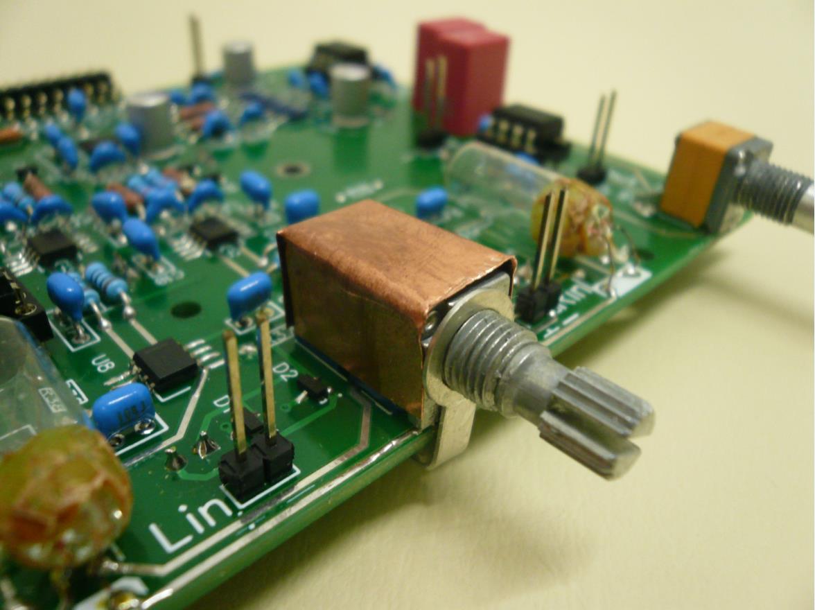

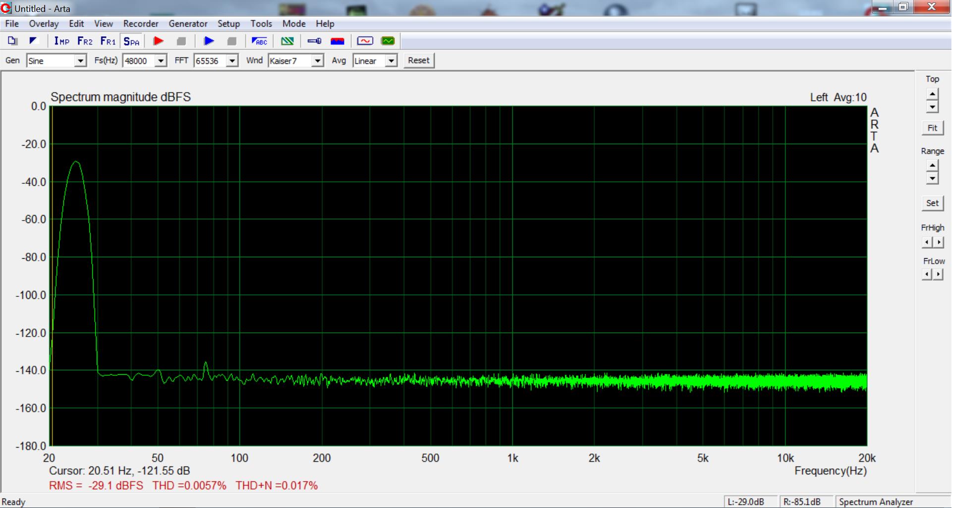

I'm getting there... slowly. The attached FFT shows the target when a couple of issues are addressed. One is solved! It was a ground loop. The metal chassis is earthed to mains PE, first thing done. The circuit gnd is not connected to the chassis to avoid ground loops when a DUT is connected. So far so good. But then there were the potensiometers' shafts. Grounding them became a necessity when the opa1656 came in allowing for much higher input impedance than the opa1632. Since they had physical contact to the chassis, I left them to mains PE rather than the circuit gnd. That was a bad idea. I took them to the nearest point of the ground plane and insulated from chassis with nylon washers. This killed a lot of noise! Also, I shielded the pot body with copper but I'm not sure it does anything. All this helped to reveal a lower level of noise coming from the transformers/mains wiring. The FFT was captured with all this stuff taken out of the chassis as long as the wires allowed. I have the impression that the culprit is the mains inlet and the wires to the transformers' primaries. I'm going to play around this the following days. It would be very handy if I could keep it mains psu.

A few issues I can spot:
1. Pot tracking can ruin your input CMRR. Not good.
2. If you want to be avoiding ground loops under all circumstances, I'm sorry to say you would have had to use I2S galvanic isolators and separate input + ADC / output + DAC sections each with their own mains xfmr or other means of providing galvanically isolated power. (And then there still is mains xmfr primary-secondary coupling capacitance to contend with, several hundred pF even on a smallish part. I don't think they make very many small ones with a shield winding, <20 VA usually is OK as-is but it can be a real issue up in the hundreds of VA and needs to be taken care of in integrated / power amps.)
3. Mains pickup from the primary section could be either electrostatic (-->apply shielding, run mains wire next to chassis) or inductive (--> identify loops in signal path and reduce loop area to a minimum via layout - usually that means keeping signal conductor pairs next to each other at all times, including any Ts like the ones for your bulbs, which ultimately may become an Achilles heel).
All good advice and much appreciated! Obviously, things can get insane for a no compromise design. But then, my limitations come into the game. For example, a better digital converter most likely would require I2C control port and that is simply beyond my handling... So, starting from something I could use and keep it within my budget, it could only be just descent at best. In other words the CS4272 sets the limits in this design and apparently the analog circuitry around it is tracking well.
At some early point I made thoughts about galvanic isolation. Although it seems easy, it requires reclocking and I put it aside. Searching for all this, I found that there is no electrical continuity between usb ground and PC chassis/mains PE. Meaning that usb can pass a lot of digital hash but is not responsible for ground loops(?) Indeed, my findings are pointing to this direction. The low frequency noise is more like what you describe in the third section of your reply.
The input attenuator/buffer took the most of my effort. Not meaning the best it could be done... I realize it can take a lot of improvements for the very best loop measurements. But what I needed was a handy tool. So, even if a stepped range selector is used in front of the ADC, there must be a potensiometer somewhere in the test set up anyway. This is where I think the low cost rigs suffer. The motivation behind this project was to build a device ready to use, plug in a rough prototype and have it measured. It's not intended to compete the top class bench equipment. It takes it from the soundcard point of view, the weak link.

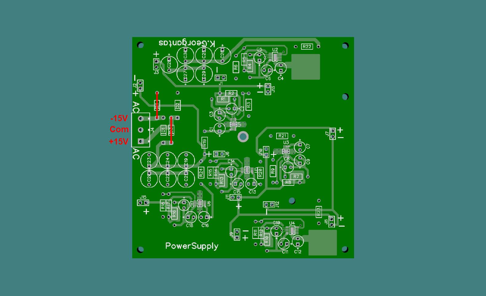

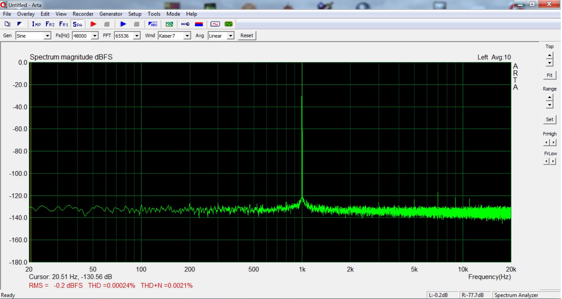

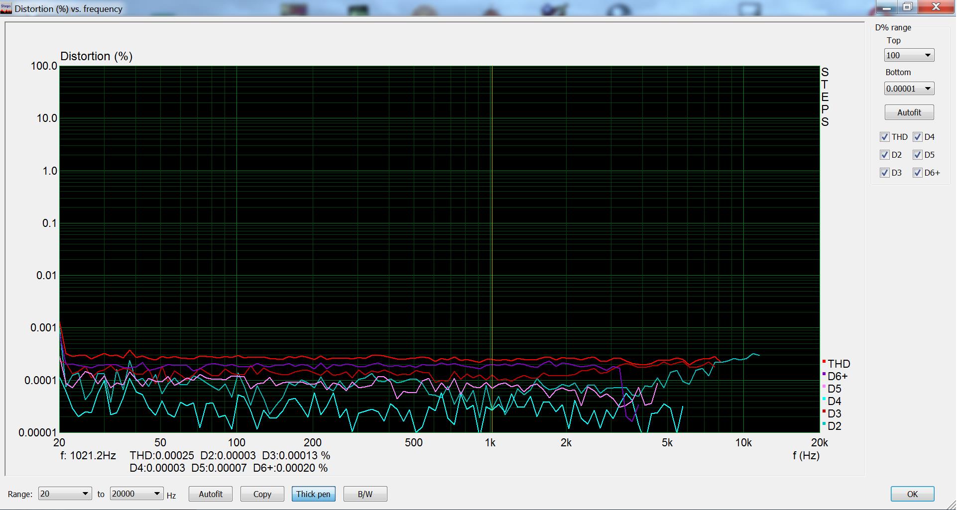

The toroid transformer's magnetic shield works really good eliminating 50Hz interference but there was another problem. A tiny 100Hz peak barely seen on the noise floor yet waiting there to get excited by anything around it. Something to do with the center tap/rectifiers obviously. Anyway, trying to stay with plan A -one box, one power cord- I replaced the transformer with SMPS. I used MeanWell for availability and cost. One RS-15-5 from mains to 5V/3A DC and then split to a linear 3,3V reg for the XMOS and a DKM10E-15 to boost at +/-15V. The reservoir caps on the psu deck cannot stay as they exceed the max load capacitance of the DC converter by a lot. I left on 220μF per rail. And the input takes 47μF because this was mentioned for the RS-15-5. See pic for the conversion of the psu. Just bridge D3 and D4. Pcb for the SMPS is not mandatory but I made one and gerber files are attached. Lay out is for LD33V which is different from LM78xx series.
Everything works a charm, tested with real DUTs as well. Now it gets seal of approval!
