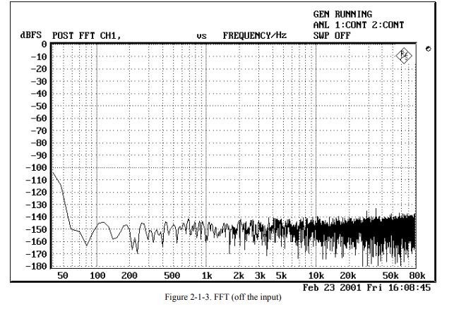

Yeah, good performance at higher frequencies is not a simple and cheap task. Most vendors do not publish any data, for the chips as well as for the end products. I believe for a reason 🙂
Rising noisefllor is tipical for CS4272, but not all ADC/DAC's are the same.

Most audio ADC's do have that noise shaping rise in the band above 20 KHz. Only the recently discontinued AK5394A is low through to around 80 KHz or more that I know of (see below). The measurements of the Asus card suggest limited bandwidth regardless of sample rate.
