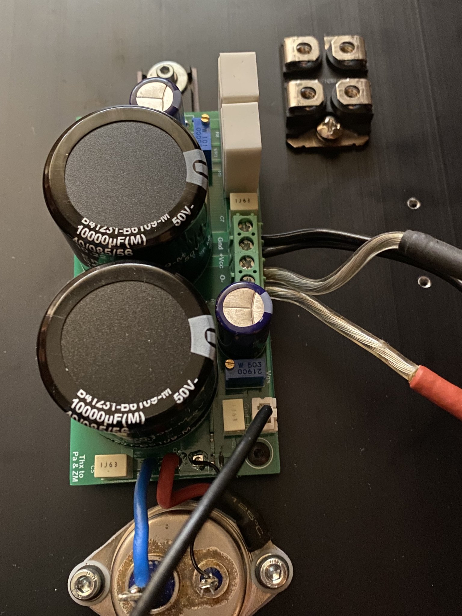

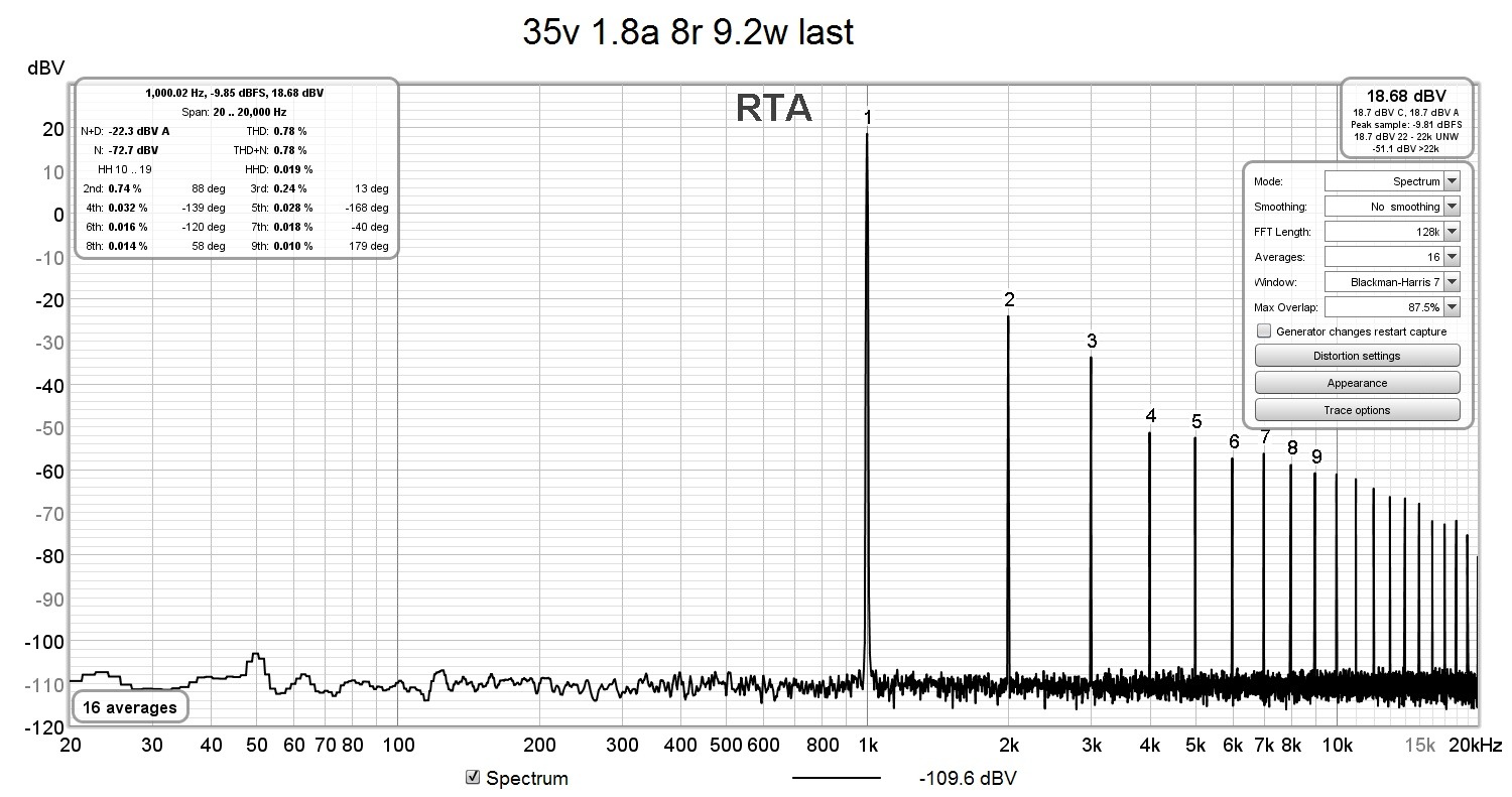

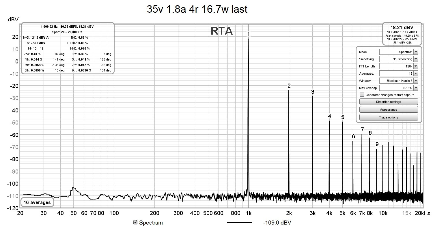

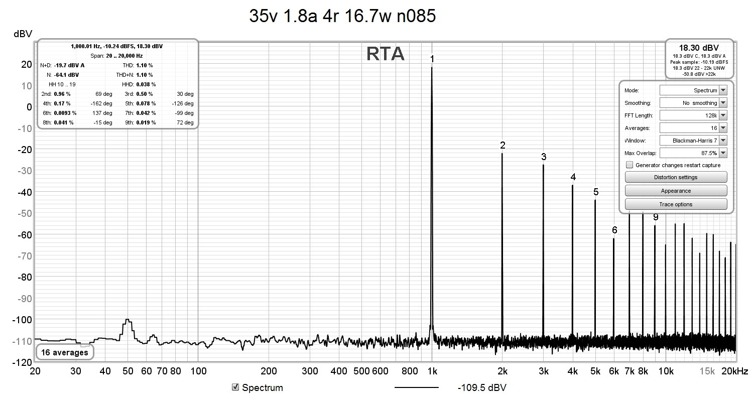

I’ve had some more fun today.

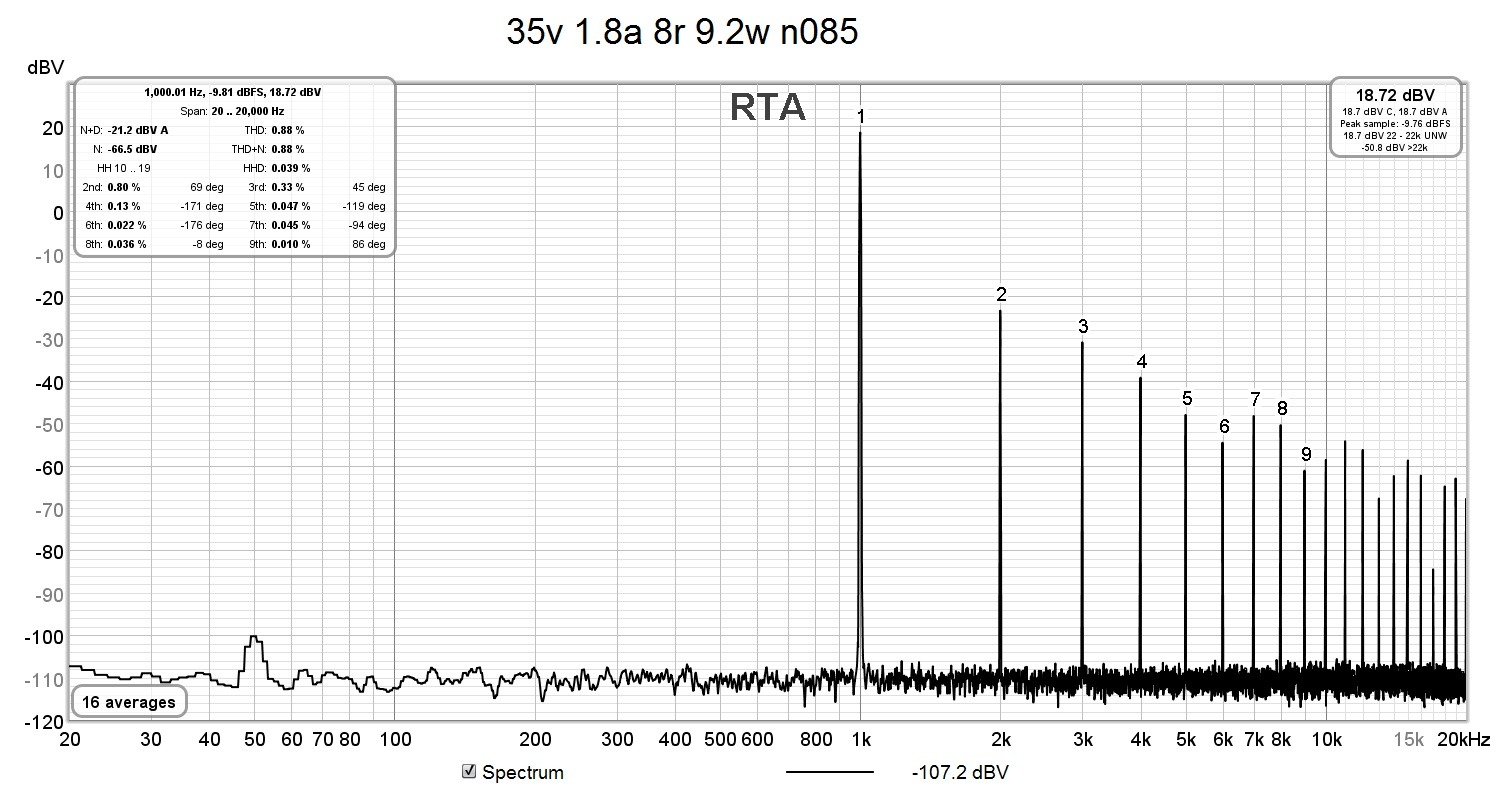

I replaced the irfp150 in the ccs with ixfn280n085. I have lots of these pucks and the curiosity of trying them was huge.
At low power(1w) the results are very close the difference starting to creep in at higher power levels, though not much. This at 1khz, at higher frequencies the difference will be bigger.
So my conclusion to all this is if I need more output power(which I don’t) and the dissipation on the irfp goes above 40-50w I have to resort to the big pucks with some penalty in thd.

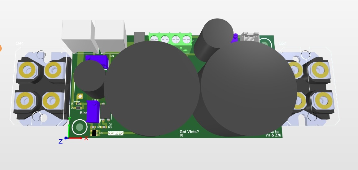

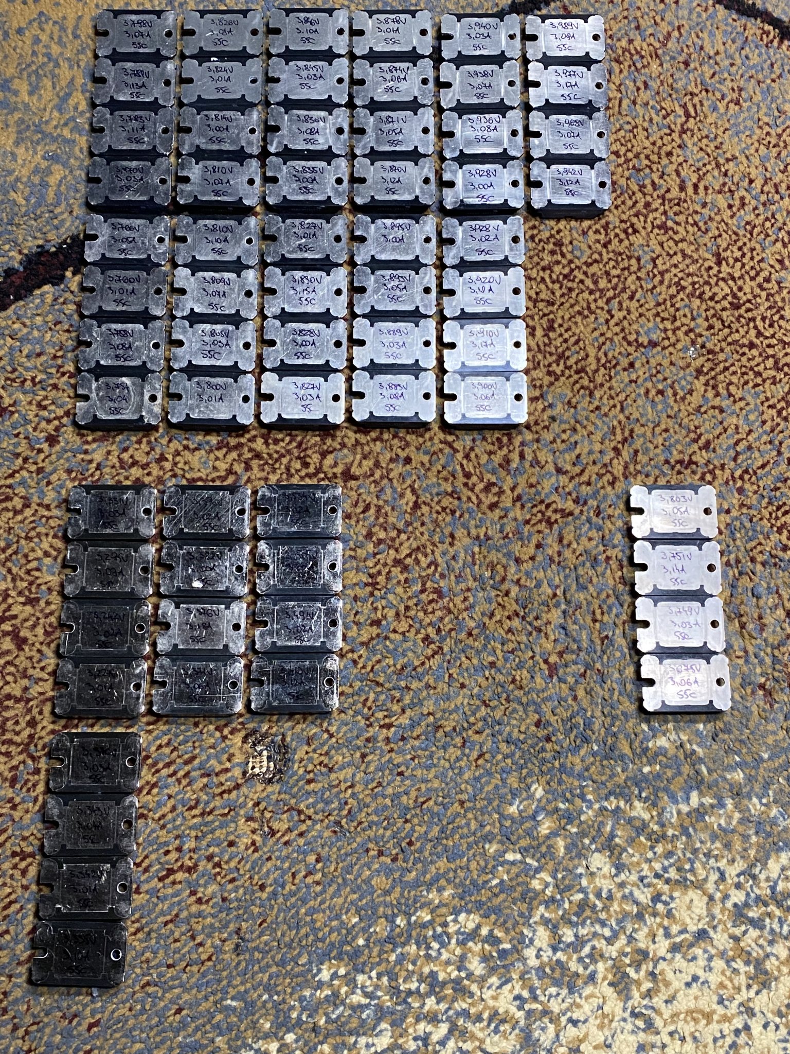

I am back 🙂
Yesterday I decided to match for vgs all my puck mosfets. I got a few quads so this gave me the idea to make a new pcb to accept the pucks(if needed also the to247 mosfets).
With this pcb you could build a full mos follower needing 4 pucks or vfet/mos needing only 2 pucks.
I have more than 10 quads of matched pucks and was thinking that if there is enough interest I can give these for cheap together with the gerbers for the pcb so you can build the amp. I can divide them also in matched pairs.
You can argue that matching is not needed but I did it to be able to have close min/max currents when adjusting the ccs and hopefully close transconductance for the gain devices when going mos/mos.
What do you think?
What do you think?

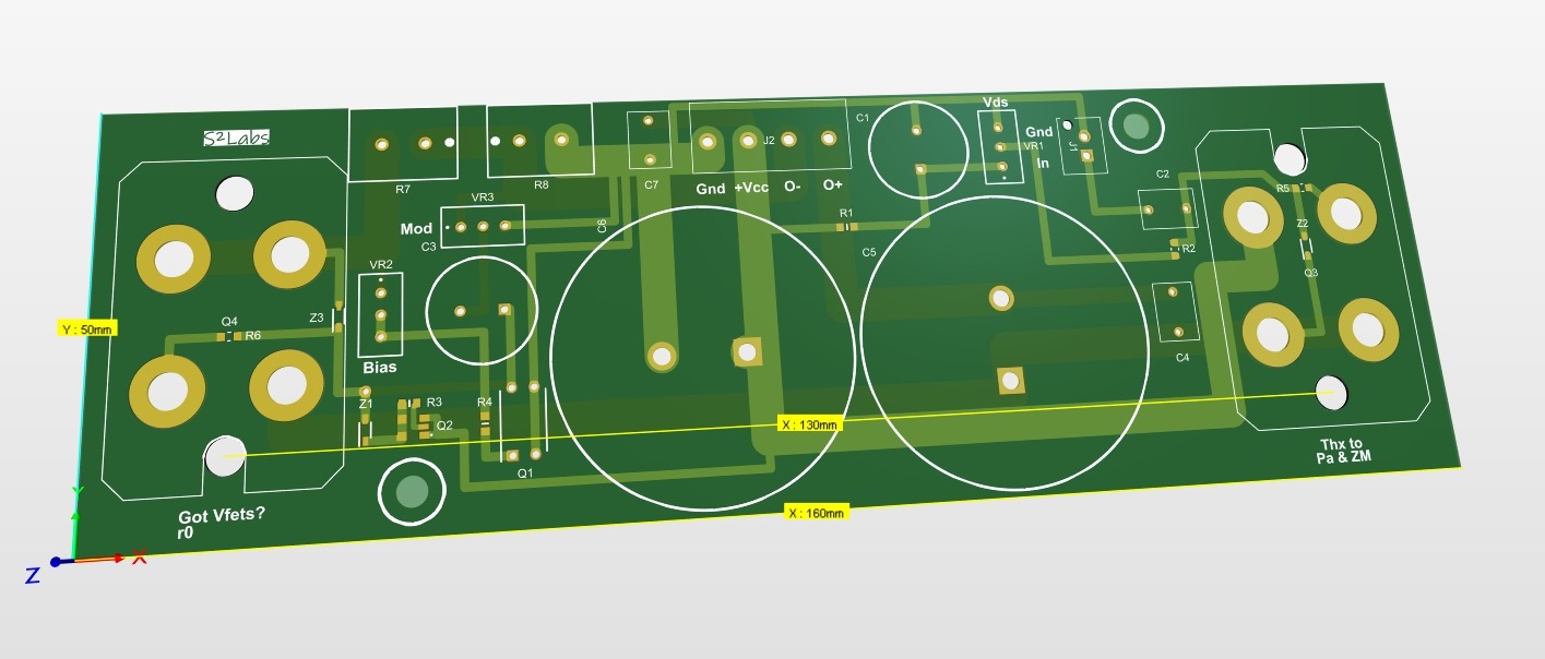

Since I already ordered some PCB of your original PCB can the originale one be used for both type of amplifier, meaning MOSFET/VFET and MOSFET/MOSFET ? Or, is there components that are different or added between the 2 configurations?

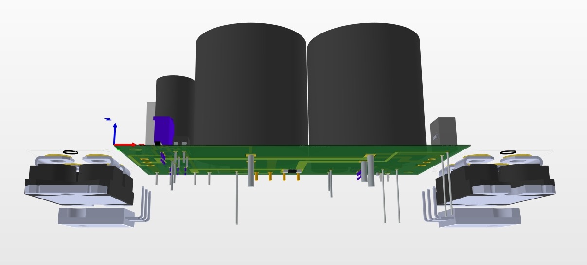

Thanks Eric
Yes both pcbs work with mos/mos or vfet(or jfet)/mos.
If you want to use the pucks with the older pcb you will need to use wires for the connections.
The pcb for the smaller irfp mosfets works only up to 45v.
This one is able to go higher, has an extra zener in series with the ccs.
The pucks need lower gate resistors than the irfps. At ZM’s suggestion I will add some series ferrite beads together with the resistors.
Also I have to add pads for the vfet at the suggestion of nautibuoy.
No thermal pad needed for electrical isolation.I dissipated ~120w/device without even adding thermal paste. Well now some thermal paste you can add in there 🙂
