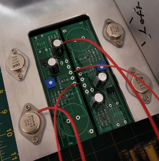

Funnily enough I was just looking at a spare board pondering the task of getting the final hookup correct.
…and that cut out for the pcb, was that also curtesy of your mate’s bandsaw? Thanks.

@maximax77, my mate's bandsaw was only used for slicing the heatsink, everything else is done with a pillar drill and hand tools.

Almost there! I've been doing the internal hook-up wiring today and have done some initial checks/adjustments/tests - voltages are what they should be! I just have to connect up the input phono sockets now before I can finish checking and, hopefully, listen to some music - sadly that will have to wait for a few days as I'm out of time today.
I've been listening to my VFET project this afternoon and it is already making exquisite music - I say already simply because there is definitely more to come as I'm only using a Samsung Galaxy phone as the source and my Noir HPA to drive it for now.
I listened initially with my workbench speakers but the gain of the Noir (9dB IIRC) wasn't enough for anything but a test listen, but once it was clear all was OK I moved to my listening room and hooked up my Lowther BLH speakers - these were efficient enough to have a good listen at a reasonable volume. Firstly thing to note, bearing in mind the efficiency of the Lowthers, was that with nothing playing there was silence, absolutely no hums, buzzes or whatever...
I have to say that the VFET and Lowthers seem to have a really promising synergy; with my SE-OTL amps I always had a nag that the balance was a little forward and the bass a bit light but not with the VFET, which delivered a robust but sweet and subtle sound quality - I had one of those listening sessions where you start to go through your recording library! Tomorrow I will try one of my DSD DACs as the source.
I've not quite finished the build as I still need to contrive some sort of front panel for the chassis - maybe get something 3D printed.
A big thank you to Papa Nelson for sharing this design and enabling me to enjoy such a positive experience.

A quick re-arrangement of the system and I'm in business with the Valve DAC as the source. Big step up, delightful music.
And earlier this morning, I designed a front panel in Fusion 360 and ordered it to be 3D printed - I'm giving JLC's new service a try.

Just about finished the project today with the addition of a front panel (3D printed by JLC).
Onto a preamp for it now. I have a Borbely EB-1198/116 board that I purchased from a fellow DIY Audio member - I tested it last weekend and it seems it will be an excellent marriage.
