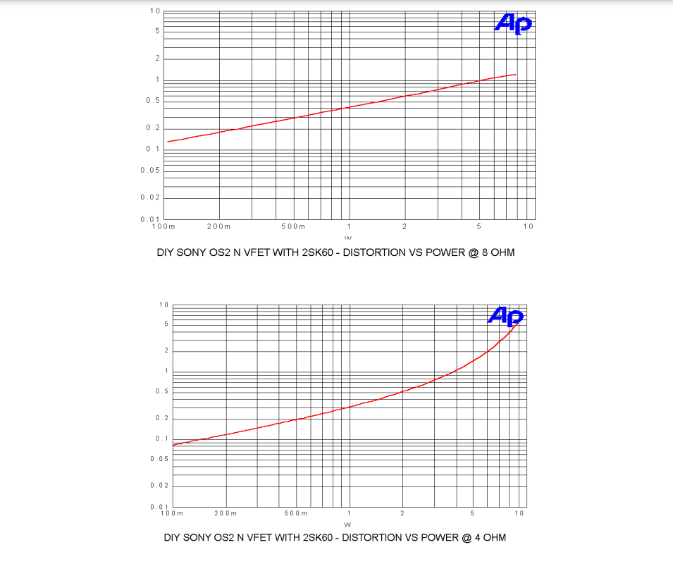

The 2SJ28/2SK82 have higher current capacity because of their double die versus the single die of the 2SJ18/2SK60. The Part 1/Part 2 amplifiers were single ended whereas OS2 was mu follower. In single ended all of the gain is from the VFET whereas the mu follower has the Mosfet providing some of the gain (some push-pull) to make up for the lower power of the 2SJ18/2SK60.
Here are the distortion/power plots of the Part 1 amplifier and the OS2 amplifier taken from NP's writeups:
Part 1 - 2SJ28
OS2
Part 1 - 2SJ28
OS2

Is there a distortion vs power plot for the 0S2 with the 2SJ28 in a P channel build or is the distortion vs power plot the same since the N vs. P is just more of a polarity characteristic for the designed Vfet circuit.

If OS2 board is built with 2SJ28, R1=0.75R, R2=0R, then the distortion/power would be as Part 1 amp.
