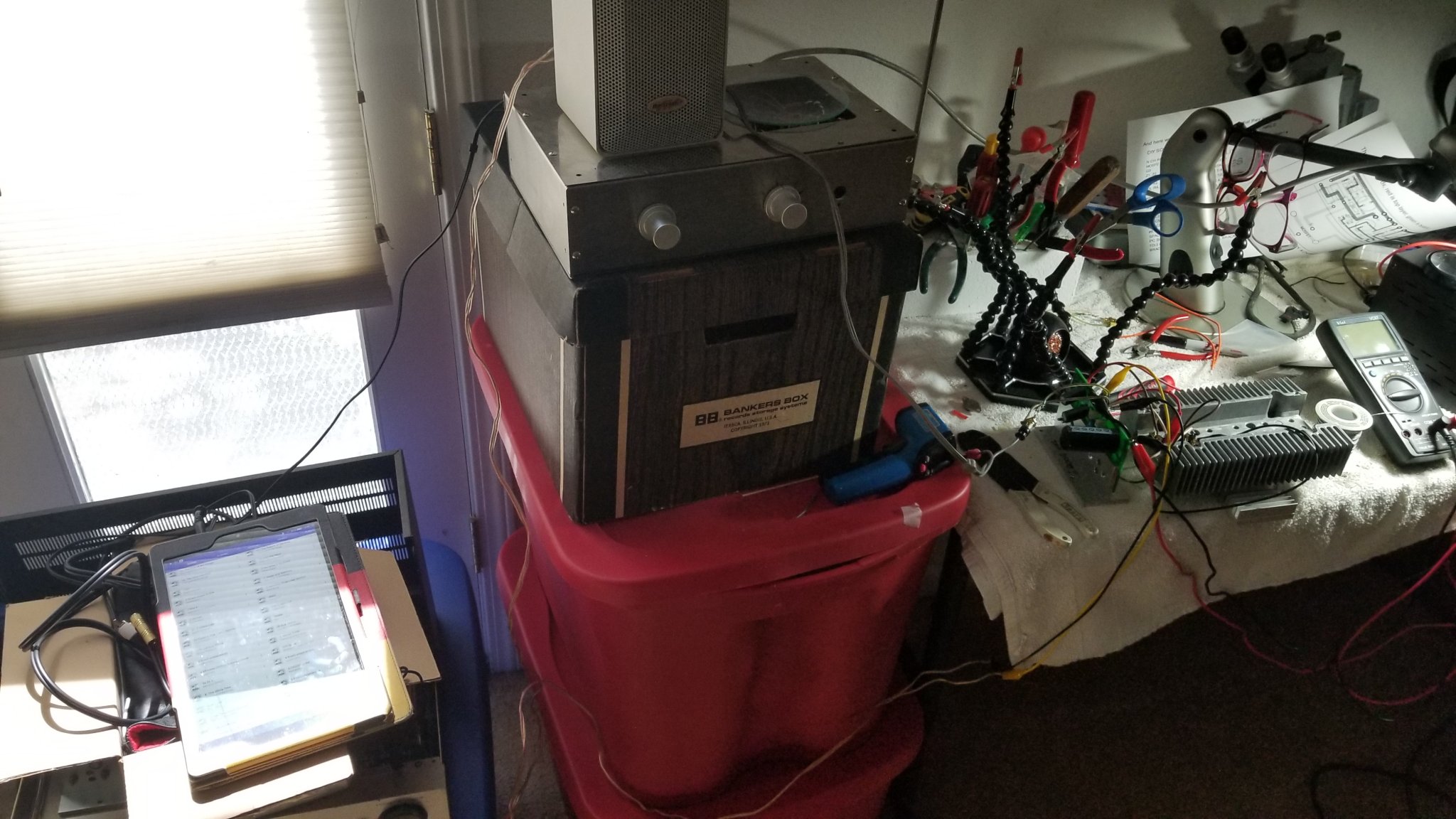

Well, here the bench device N channel 2SK60 is on its maiden voyage playing music from one speaker routed through the Pass Korg preamp and using a Fire tablet as source (mere .375 V output). Even without warming, up, sounds extremely precise and has a pleasing character in mono. Not extremely loud at present, but a reasonable volume output. I will try a more robust source later. Of course, reservations about ultimate sound until final product is built and working.
I have decided that although a single heat sink would work, discretion is the better part of valor. I will use two heat sinks and make the amp a direct amp without the Bulwark boards (no room), relying on external preamplification and/or the internal 4650 preamp. NP in his monograph said that input impedance is high and it can be used this way without a dedicated front end. Hopefully, the heat sink surfeit will keep things between 120 F and 130 F. Internal Sony preamp for the time being. This 4650 internal preamp is no slouch, even though simple, and I played it through my 'big rig' and it sounded excellent, and also sounds excellent through headphones, though it is markedly inappropriate for headphones.

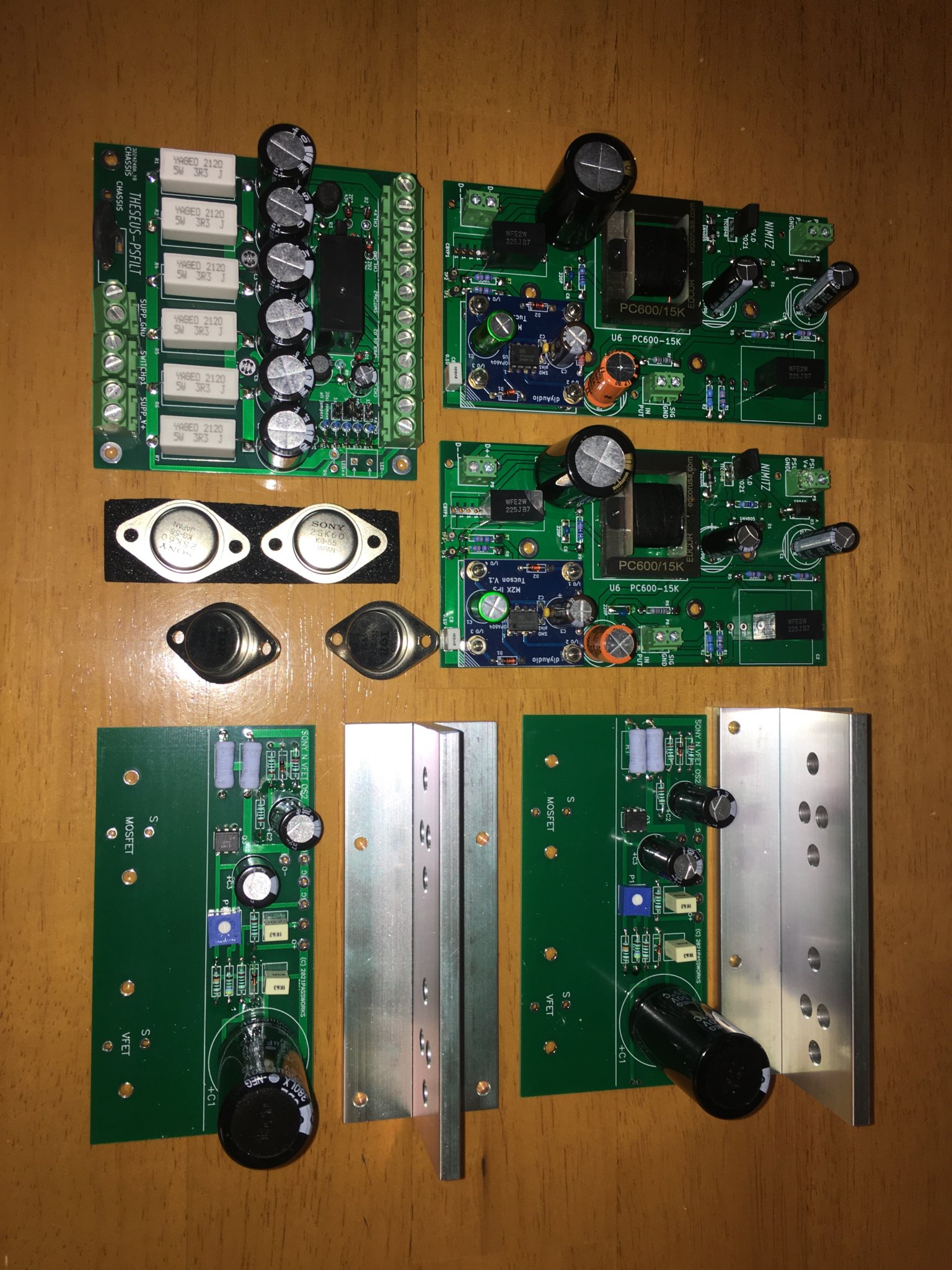

I completed as far as I could with my N channel VFET (SONY 2SK60) amplifier. Output boards completed, along with Theseus P/S filter and Nimittz input PCB's. Tuscon daughter boards are installed, I have two others from my M2x to choose from. I have the power supply brick and back panel parts with DPDT switch, waiting for the enclosure. I wanted to finish these items as spring chores have now arrived, outside I go for a while.

Second card tested and working in mono bench setup. Spooky effect noted, even with raspy hookups and ad hoc alligator clips. Female vocal heaven? So that is two working cards that can make music.

Now, place transistors in center of two heat sinks, and test second VFET/Mosfet pair with a card to make sure they are working, then contemplate chassis stuffing.

Second set of SK60/MOSFET mounted on heat sink bias easily around 16v, so that makes two sets of SK60/MOSFET that seem patent. Second set makes music in mono using the built in Sony TA 4650 preamp, which has good gain overall, maybe as high as 20 db or so. I will have to listen to it later because my wife is clunking around kitchen blaring news channel.
Ran the audio signal through the Sony TA 4650 preamp (powered by small 20V SMPS attached to internal 4650 input wiring) and one channel to bench VFET to single audio speaker. That had a marked hum production. When I went from 4650 preamp output to Korg preamp, and then to single bench VFET amp input, no hum. Headphones on 4650 preamp output sound great, no hum. So, I don't know where the hum comes from, the Korg gain stage seems to mop it out. Hopefully, when all under one chassis instead of external power supply with alligator clips, it won't be there any more. 4650 preamp seems to have a gain of about 20 db or so at full output.
Heat sink with VFET/MOSFET attached in middle of heat sink in cool room after an hour gives variable T across the heat sink with a high of about 115 right over the VFET area out to 106-110 F VFET outer limit on heat sink and 94 Mosfet outer limit on heat sink. Heat sink adjacent to VFET seems to stay around 106-110 F or so, so a single pair VFET/MOSFET on a single heat sink seems to be OK. I can keep my finger on heat sink fins for 10 to 20 seconds adjacent to VFET, and almost indefinitely adjacent to MOSFET. I'll try again when the air is warmer.

I think the sound from the single speaker (Radio Shack Realistic mini AV, maybe about 88 to 90 db efficient, but with limited output below 100Hz, but a very good quality soft dome tweeter) sounds quite good, with a very smooth and timbre-ally detailed upper midrange, even with the ad hoc setup and I can't tell that the 4650 preamp at full output damages the sound quality (as long as the hum isn't there).
