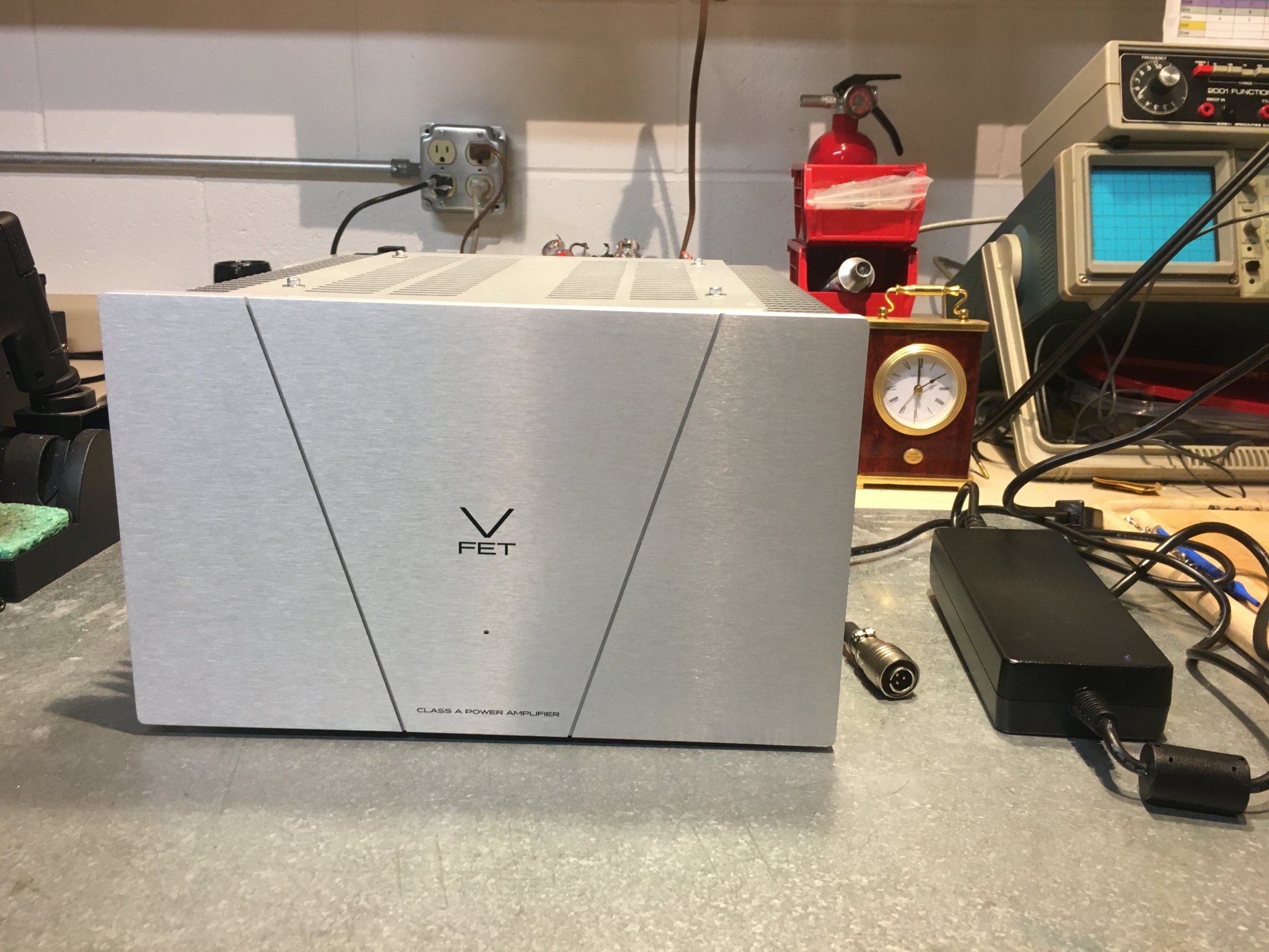

I finished my 2SK60 VFET part 3 amplifier today, it's been playing music for hours now. I have the Theseus PSFLT and Nimitz FE with Tucson daughter boards from my M2X build. I also have Austin, and Mountain View to try out later. Dead quiet and sounds awesome! Has to be the easiest amp to set bias!

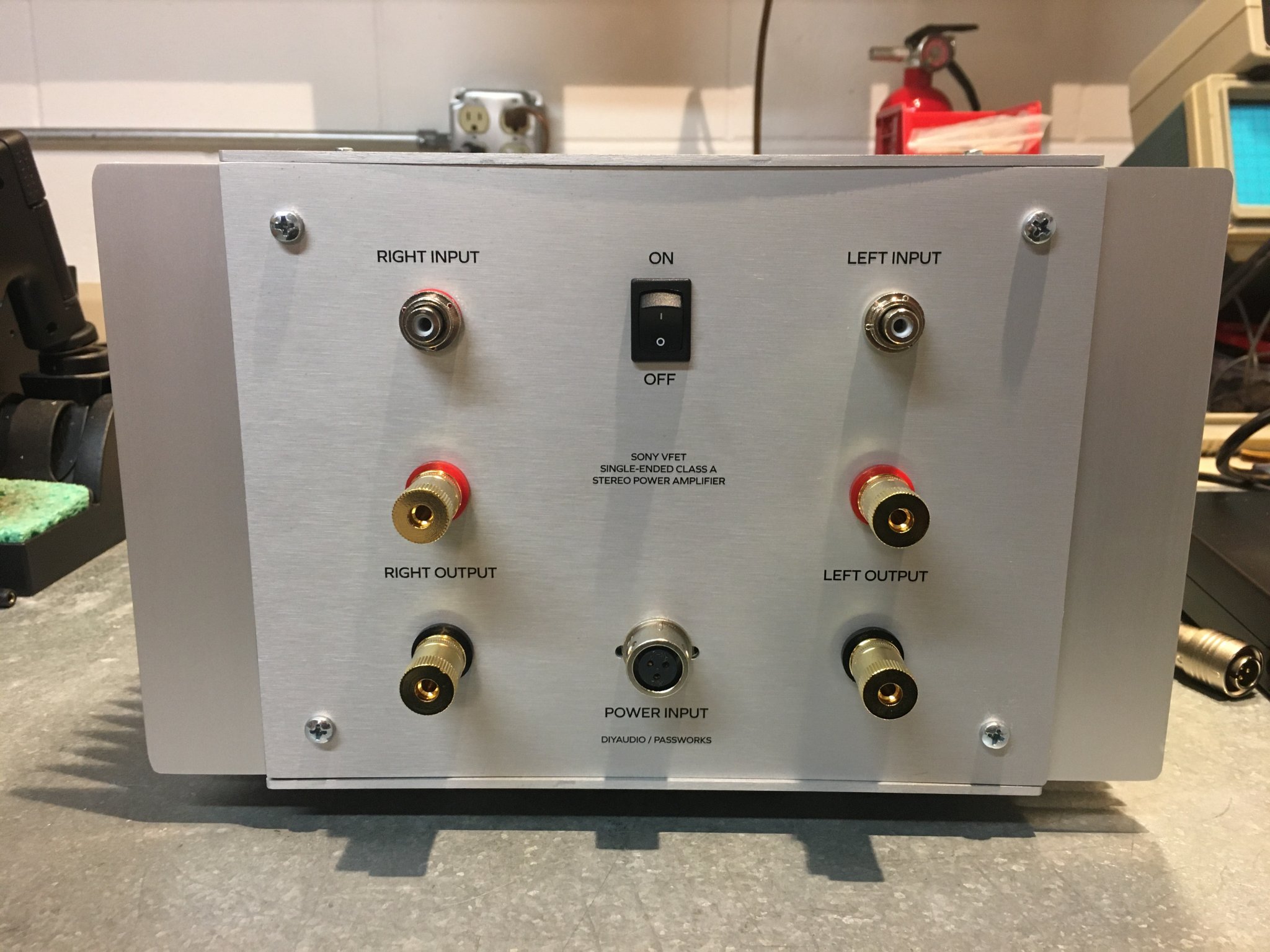

No turn on or off thumps with Mark Johnson's designed PSFLT set to 5 seconds. The only changes I made were using Nichicon capacitors since the Panasonic caps were on back order. I did use mica and goop instead of the silicone pads provided in the OS kit and Nichicon LKG Type 3 (Super Through) output caps on the Nimitz FE (I had them in stock). The DPDT rocker switch is from Mouser (P/N 629-GRS-4022-0021) and the DC input connector is a Tajima 3 pin locking ring I found at Misumi USA.
Many thanks to Jason, Gianluca, Mark Johnson and of course Nelson!

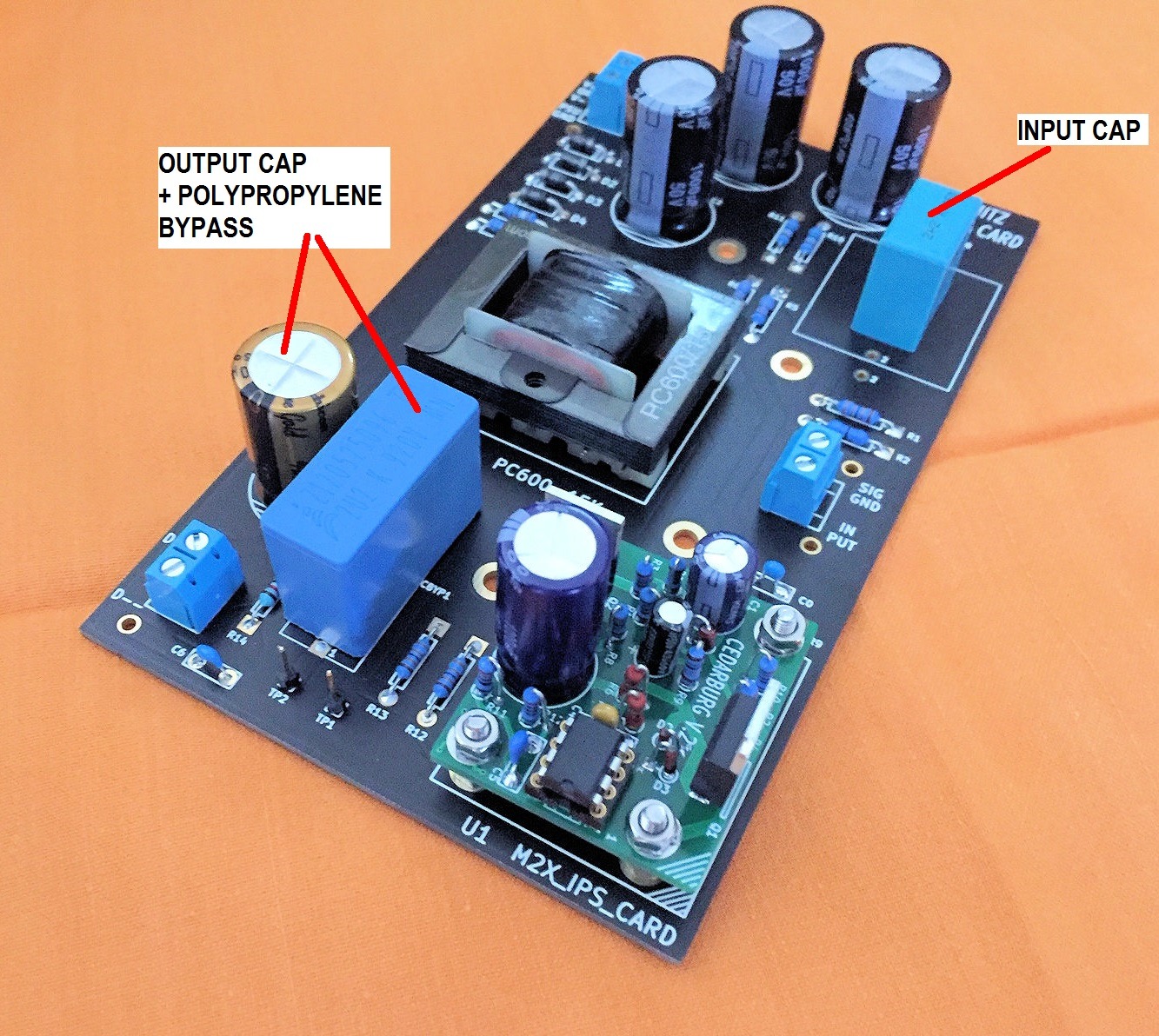

Moderator and hellof-a-good-guy 6L6 predicted that builders would really enjoy auditioning their already-built M2x input cards in the VFET amp, therefore Nimitz would be popular. He also predicted that builders wouldn't be able to resist the temptation to substitute different, possibly boutique, capacitors at input and output. Because Nimitz provides such big PCB footprints -- yer forced to!

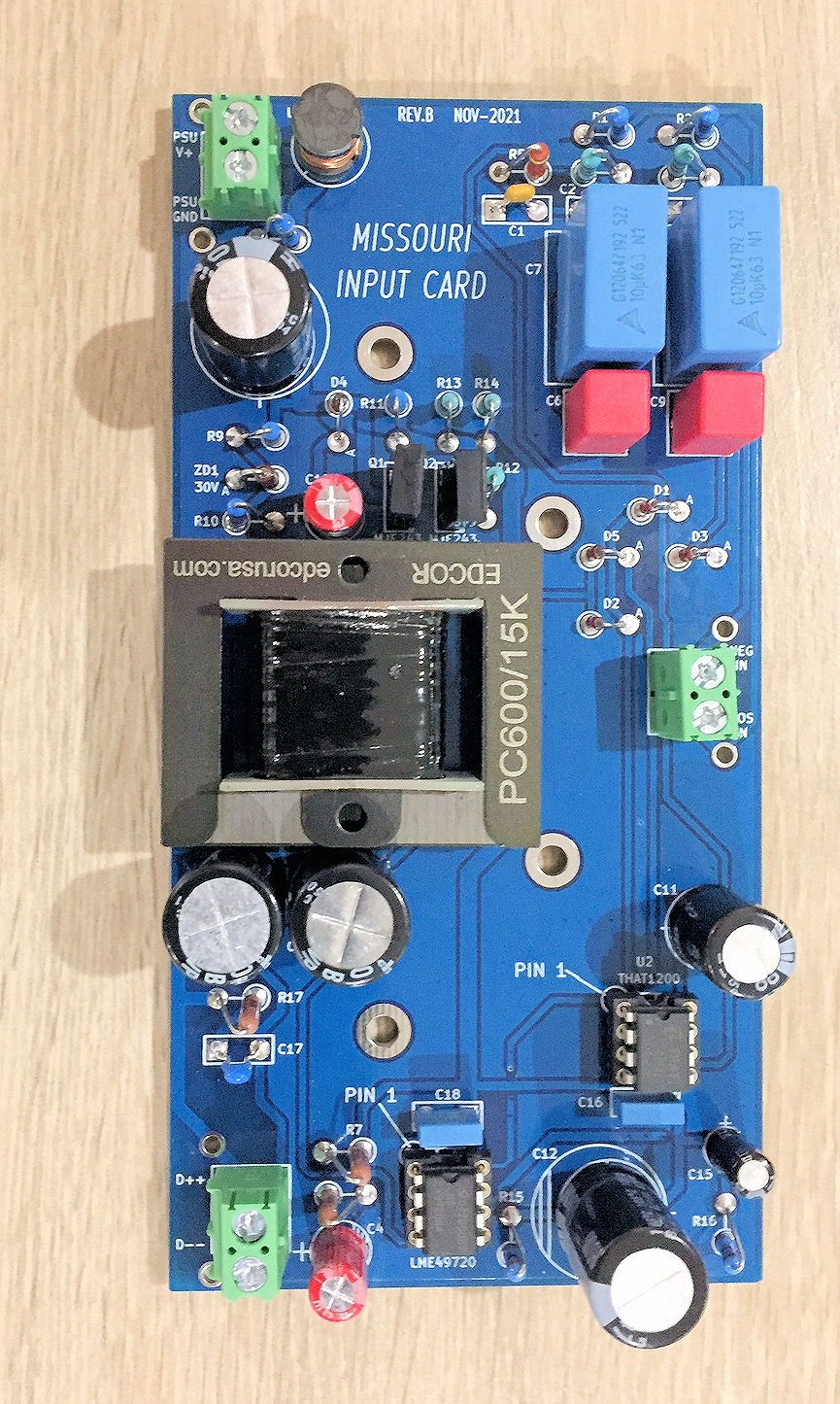

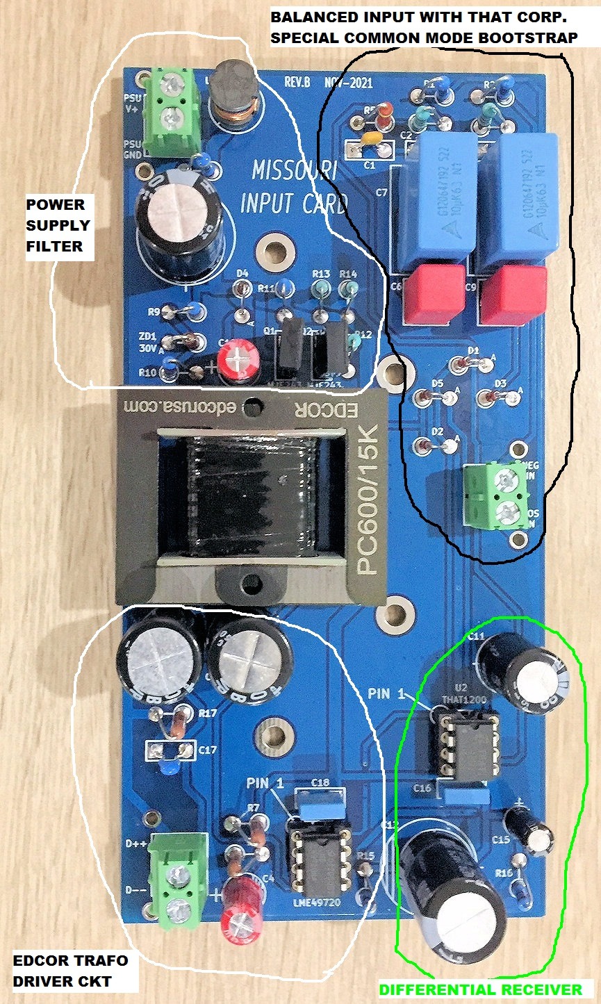

Here's the Missouri balanced input card. I wouldn't call it a terrifying mountain of infinite complexity.
The quad of input capacitors (primary + bypass) are at upper right (2xBlueBox & 2xRedBox).
_
Hmm, well that certainly looks doable. Thanks Mark.
I note that in the block diagram that there is a Power supply filter block on the board. If one uses this board does one need to use the stand alone PSU filter kit that you designed?

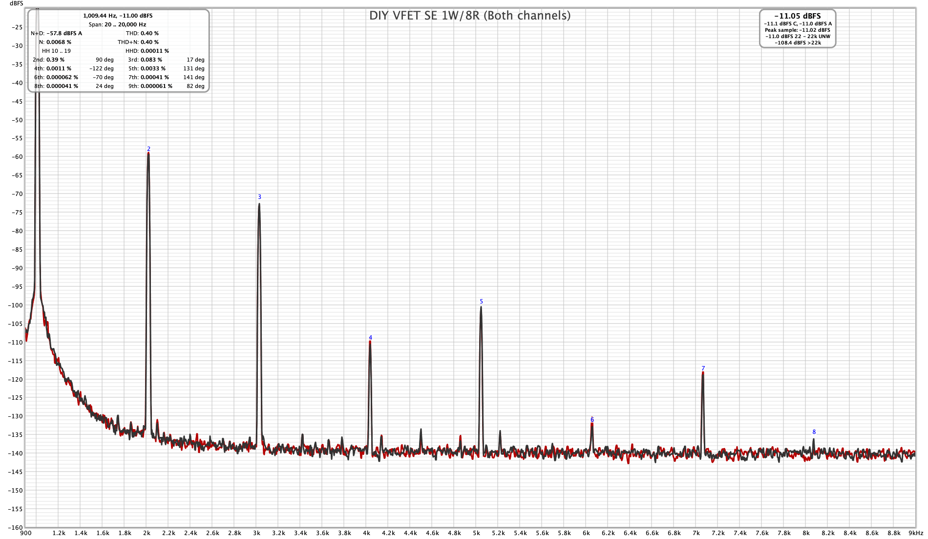

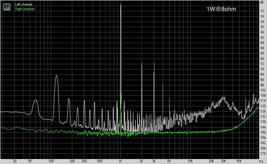

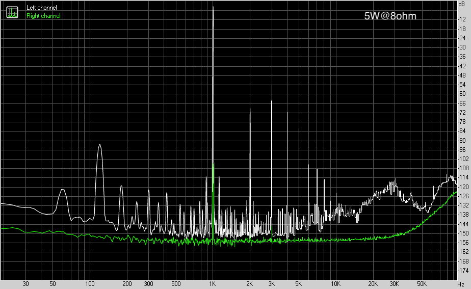

Just finished my build with 2SK82 and was doing some measurement to confirm operation. I don't recall seeing any distortion spectrum published. When I see 3rd harmonic higher than 2nd, I'm a bit surprised. Is this normal?
Running at 1.6A bias and 14V at Mosfet drain as documented. +V at VFET is just above 33V.
