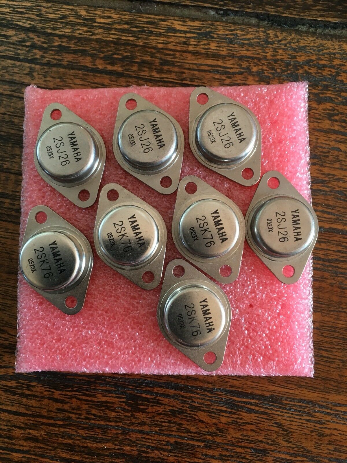

Look what I found in AU. NOS never been used, they come from someone who stashed a few for repairs... smart guy. :wave:
I have a B2, fact going to pick up another that is suposed to have bad outputs. I can keep them for spares, repiar the second B2 or make something entirely new. '
What say you Pop, you got something cool stashed in your head for the likes of these? 🙂

@Zen
I have enough of the spec FET for both the P&N channel amps Pop gave us and will be doing those for sure.
I'm not sure where these will go, but was thinking maybe something mono maybe with more ouput. I know Pop has limited his output on First Watt stuff to keep out out of Pass Labs wheelhouse, so I would, most likely, would have towork with others here if I go that route.
I'm not sure where it's going, yet, just through I would toss it out for forum input like yours.
