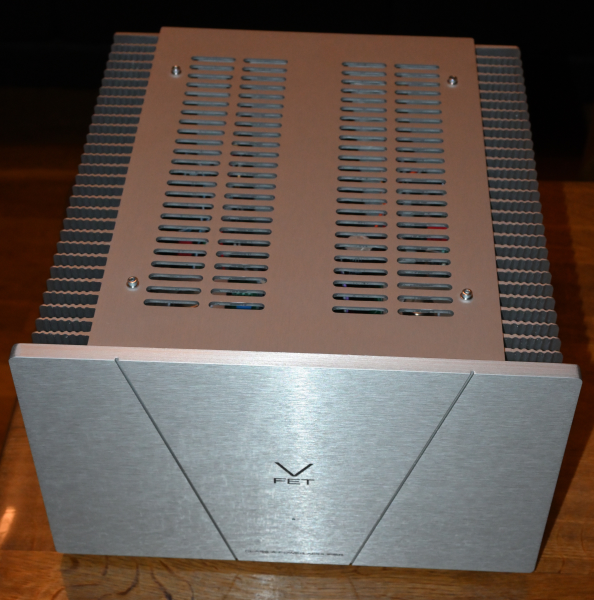

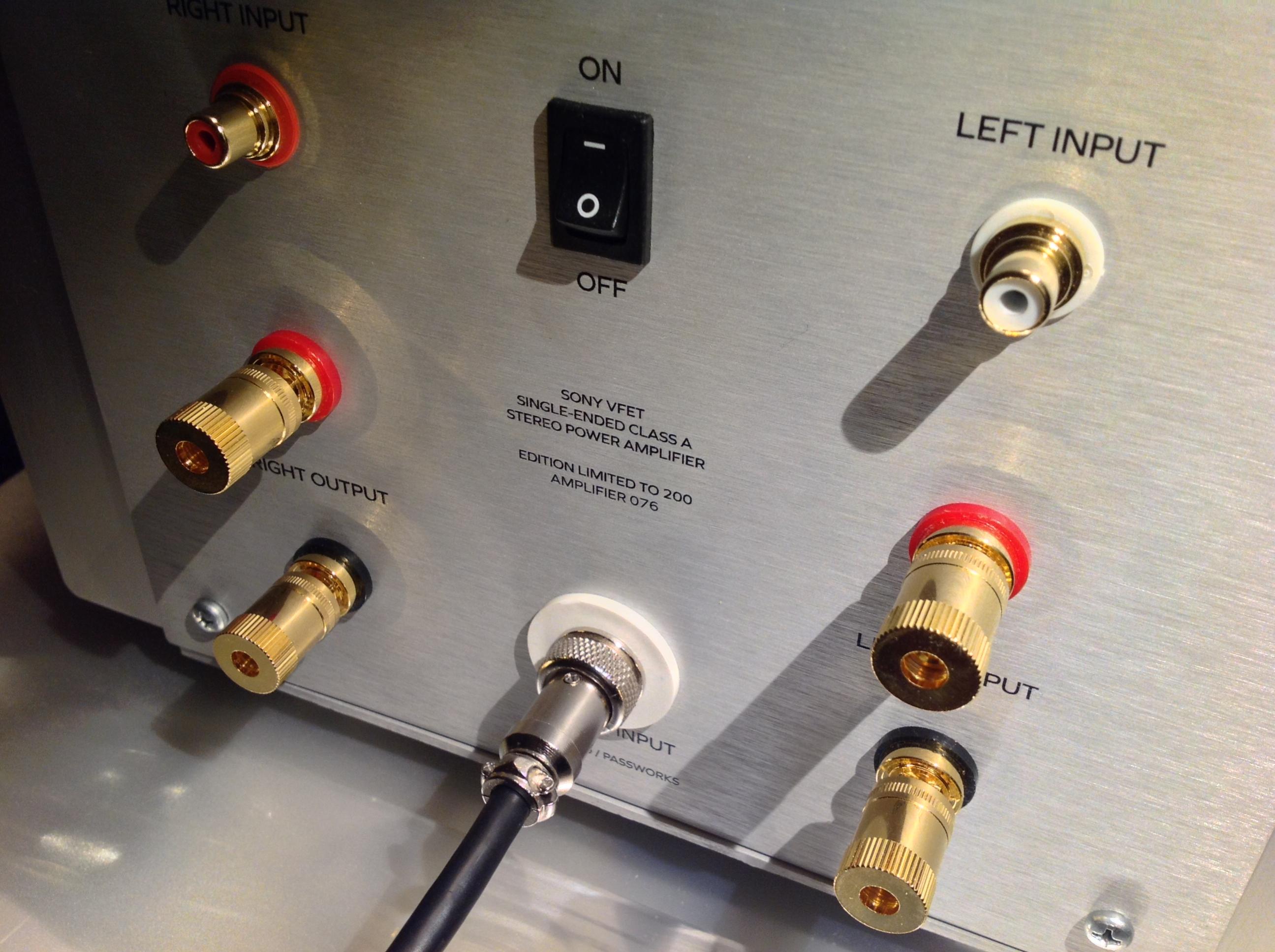

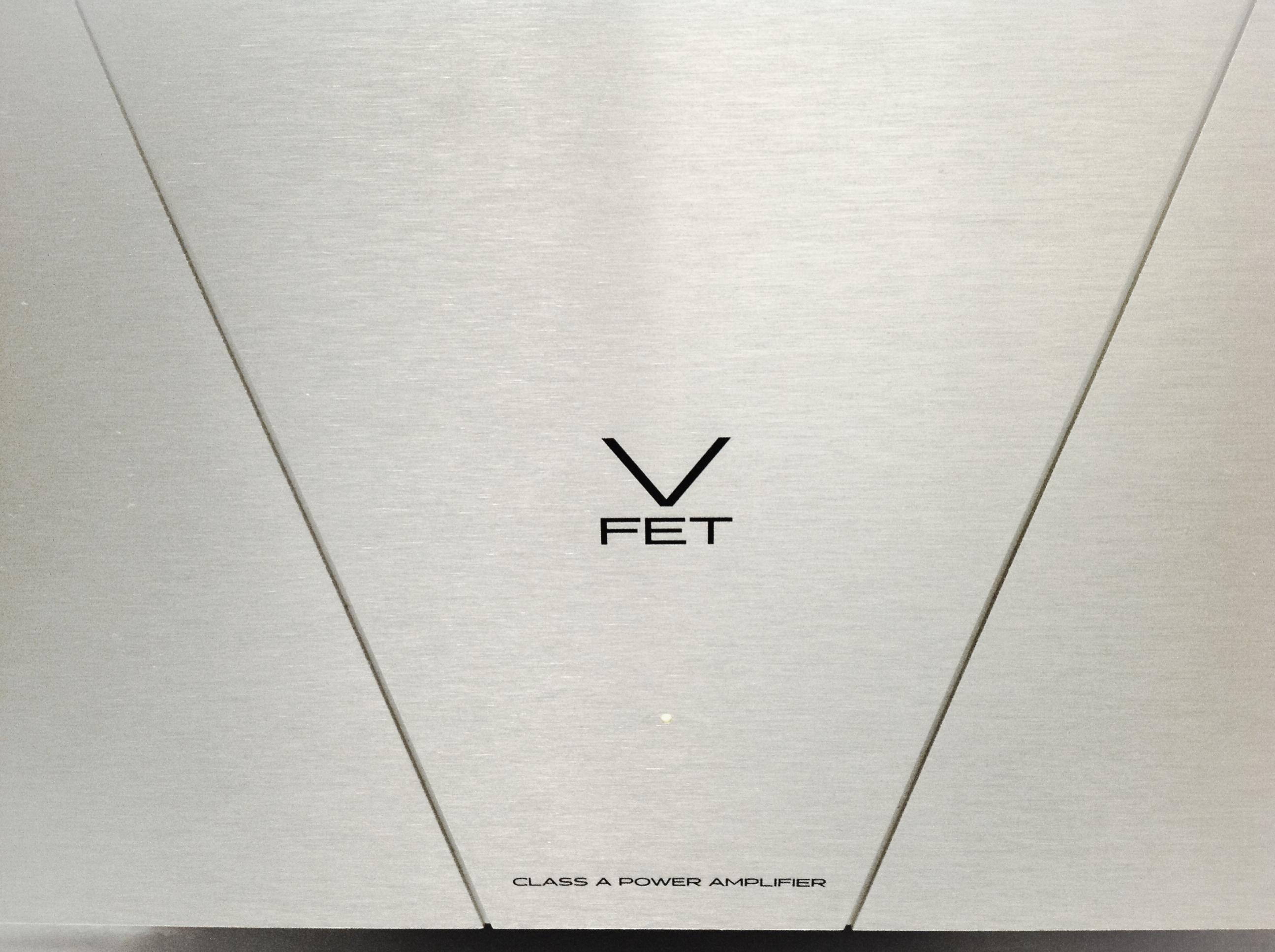

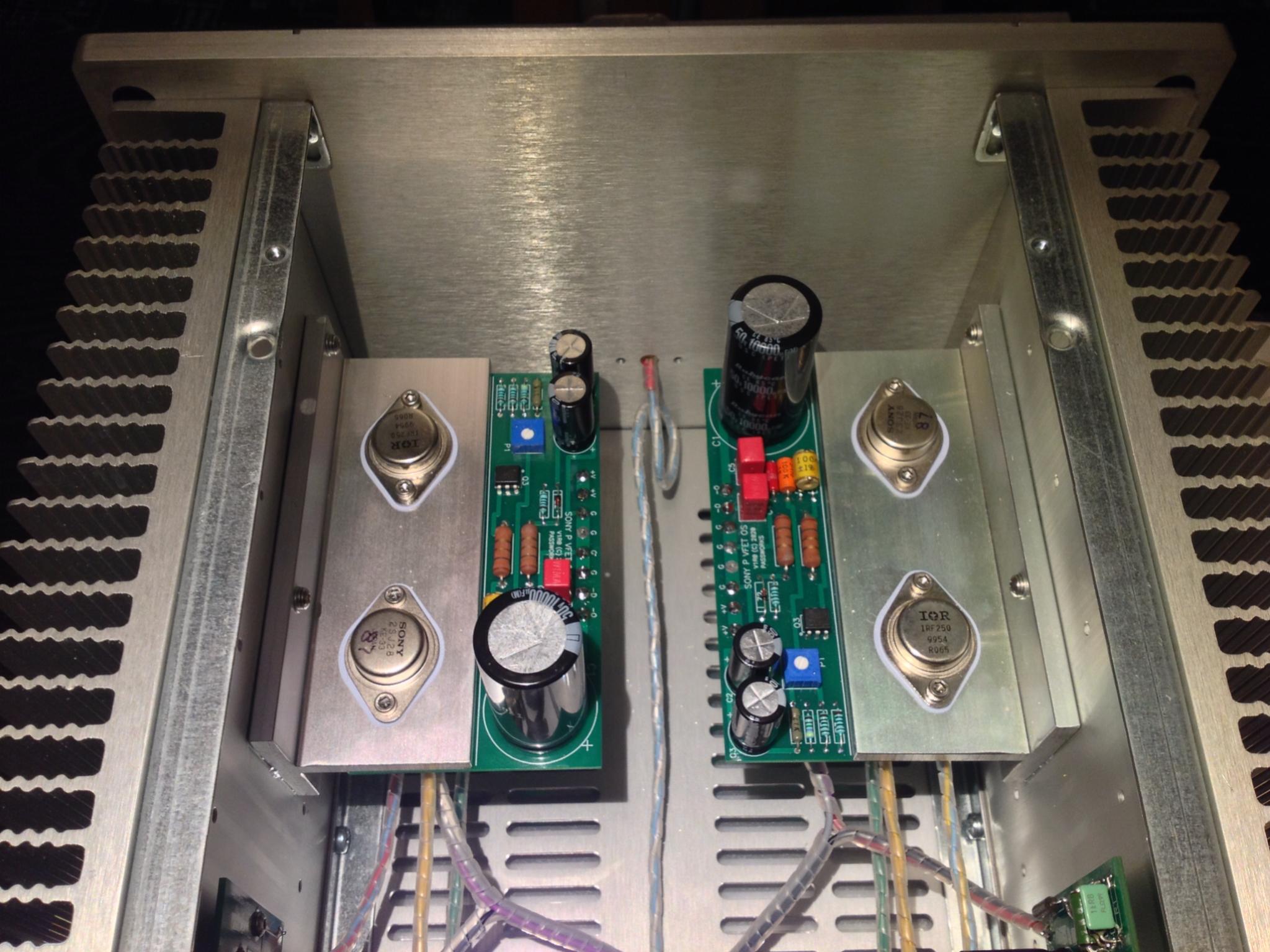

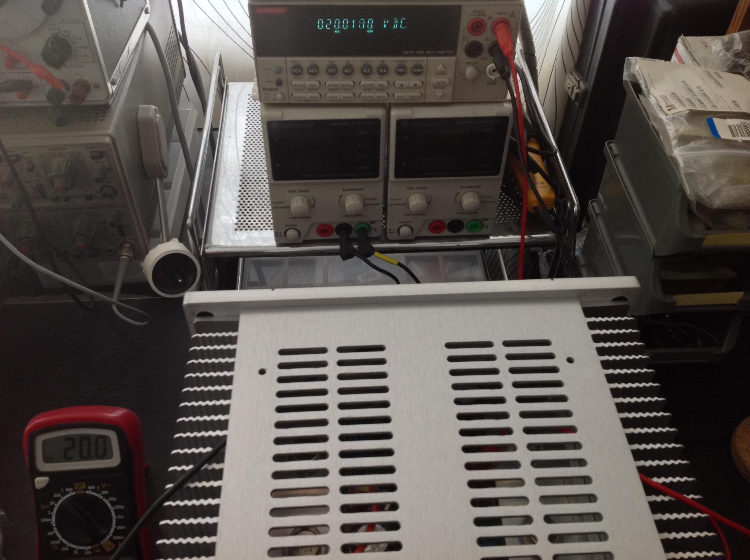

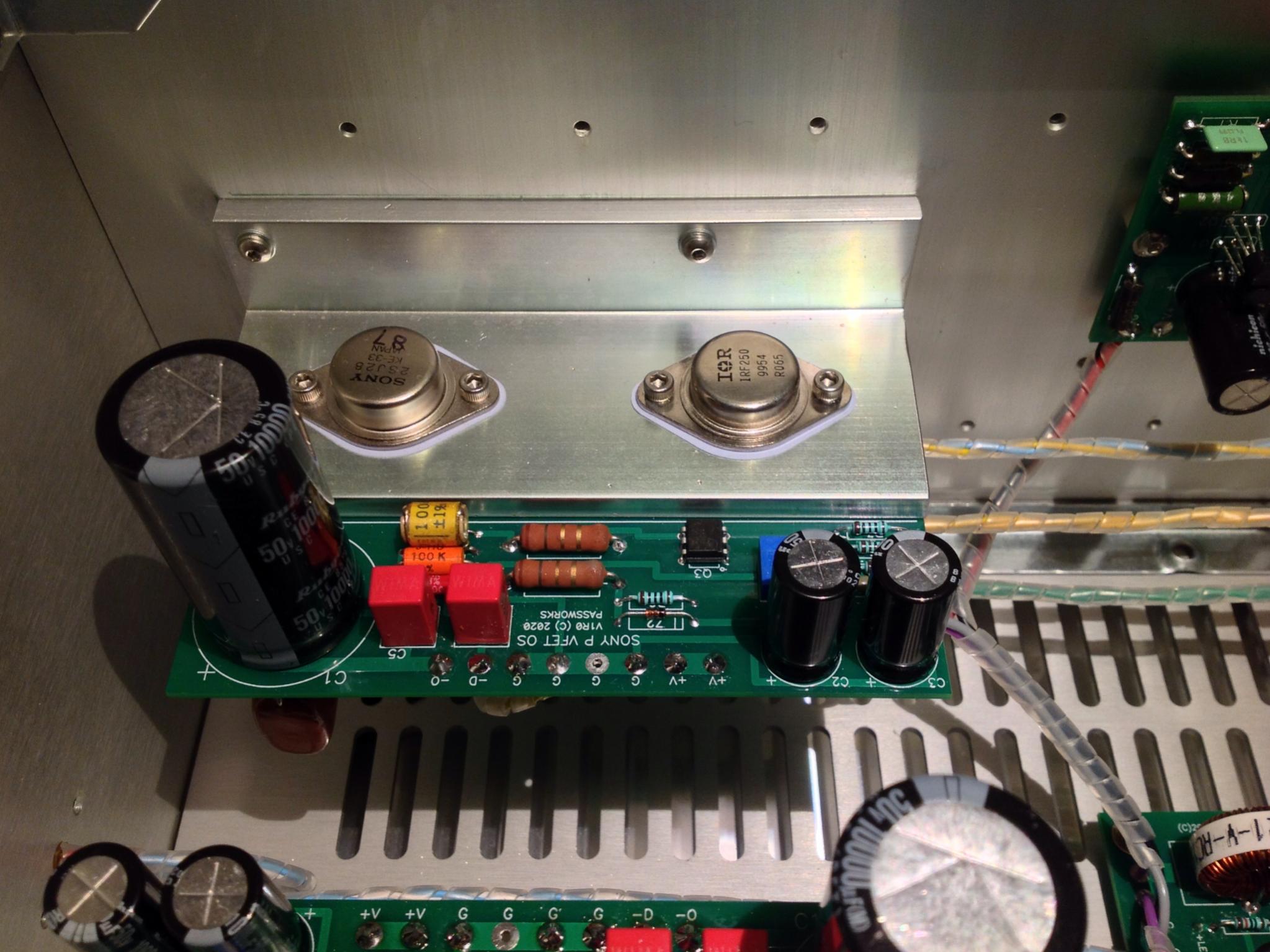

Build Vfet SE with friend Xavier :^)
Thanks to Mr. Pass was great honour to finish and complete this new amplifier,
special thanks to Jim aka 6L6 for build guide , Jason & Variac & DiyAudio Team and Gianluca & Modushop.
We enjoy a lot and are conscious about a lots of work involved.

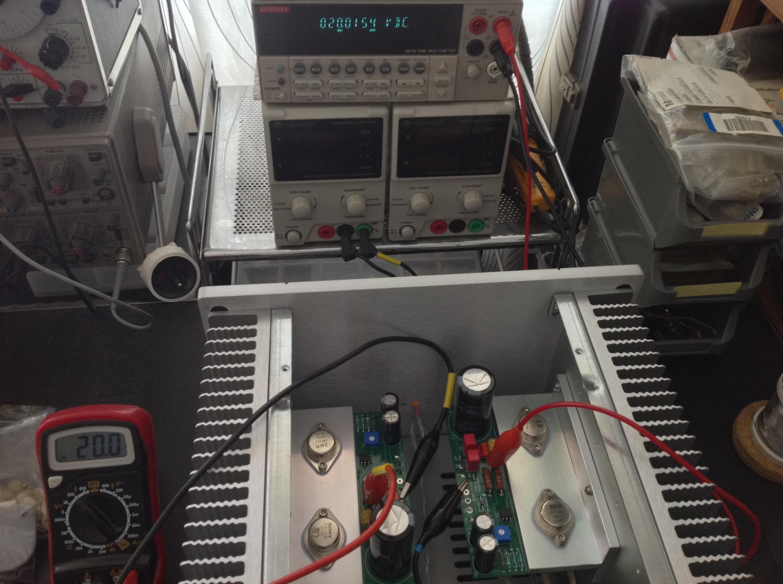

After my lottery kit win I talk with an old friend who was interested by build this amplifier with my technical assistance.
We organized " Vfet amp camp" included Papa who have done components soldering work,
mounting TO-3 transistors, Vgs match, bias veryfications and positive vibes included
Thanks to Xavier was for us a joy on the hobby bench , is now first time class A Pass
audio experience in new family home
Best regards from France

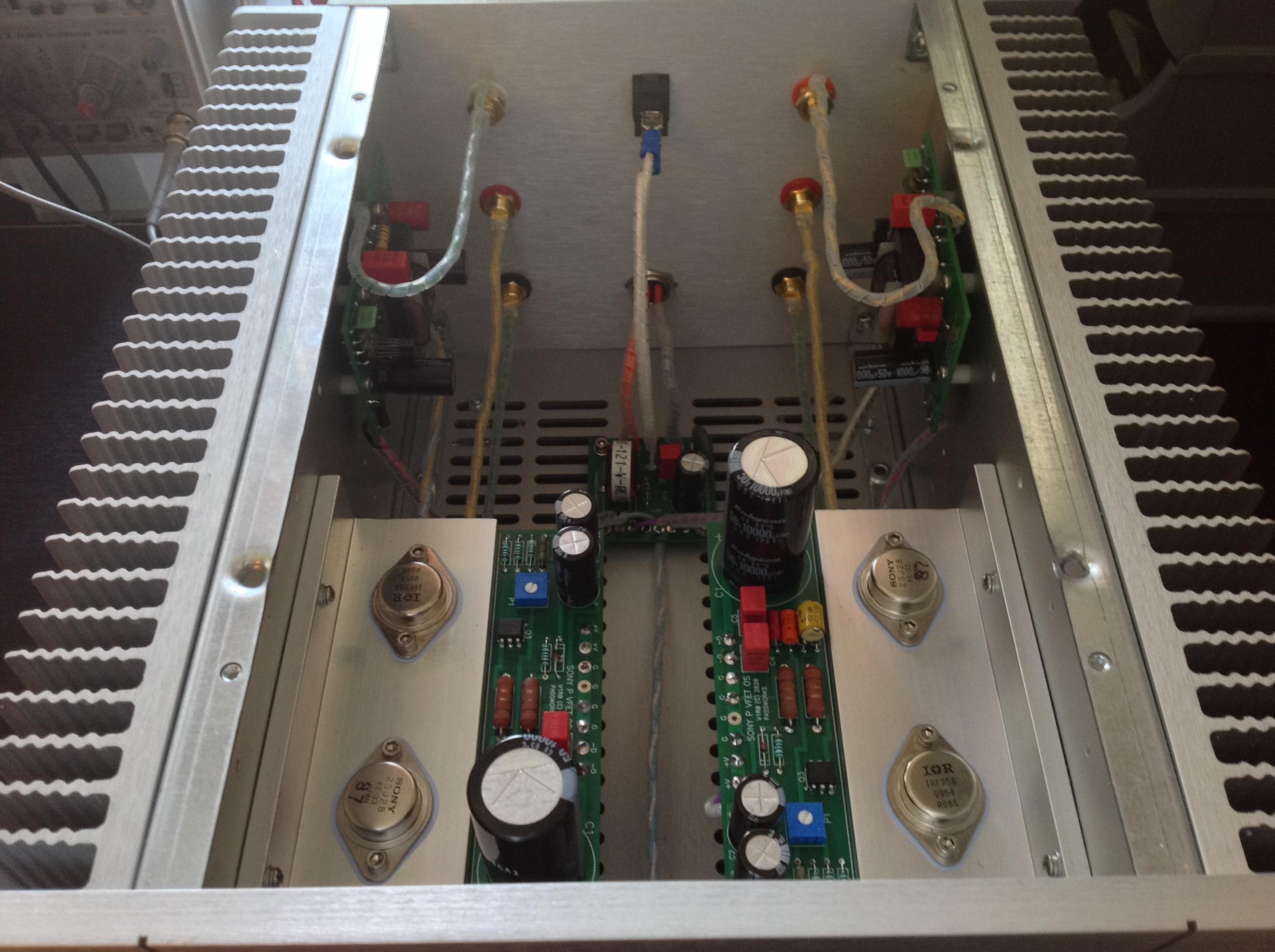

It looks brilliant!
Where did you get these wire wrappers from?
@ Thompsontechs
Thanks for kind words I appreciated 🙂
@ Quertyl
Was long time in the past I get this in my drawers..
the product I don't know precise link reference but this one look similar with output diameter = 3mm.
Anyway ask the seller 3mm 70.5FT (21.5M) Spiral Cable Wire Wrap Tube Computer Manage Cord clear | eBay

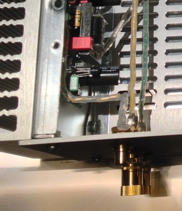

One more thing : I my build solid core copper wire is SYT AWG20 thicker than kit ones,
can be bend 4~5 times without break and isolant material don't melt easyly with higher iron temperatures.
Make this style wiring = work with patience
Good luck

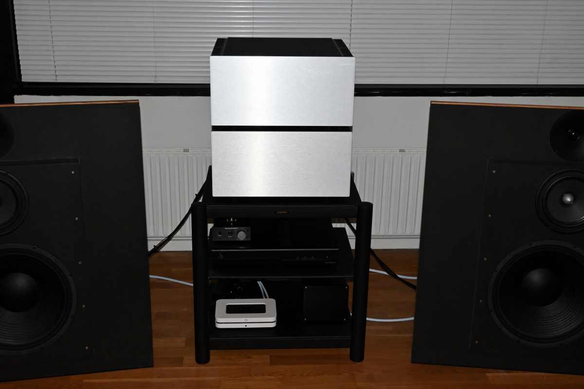

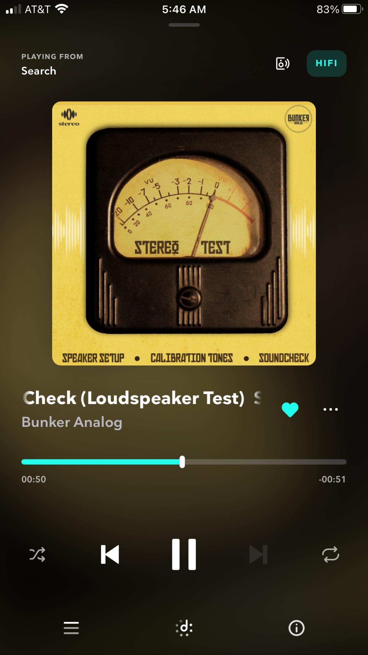

For fine tuning my setup of speakers in my listening room I found this Stereo test CD on Tidal. There are probably many but I found it very good to find the best compromise of speaker placement vs. listening position.
https://www.amazon.com/Stereo-Check-Loudspeaker-Test/dp/B08H4PR4XN
Now I am soon ready to try out the VFET amp and I have the M2X amps as sound reference.....
I managed to find a "hot spot" for speaker placement and listening position using the "CD". The test tones from 40 to 20 kHz and also the sweep from 20 to 20 kHz is very useful to hear if there are any dips or extensive room gain of specific frequencies.
Other useful tracks also for check of stereo imaging.
This can really give a change in sound.....much more than trying another amp.

I don't think it is "very off topic" as speaker placement need to be "perfect" before any amp review takes place.
In my case....after re-organize of my listening room I need a stable reference with my M2X amps before any assessment of the VFET amp.
@Nelson:
I did not move around with amps that much. The M2X blocks are heavy! 🙂
The VFET amp much nicer to move around.....
But where to place it.....it will look stupid on top of the M2X amps....so probably at the floor between the speakers......to begin with!
I have to decide as standalone or in a bi-amp configuration with M2X. Probably best to start the VFET assessment as standalone amp!

I could place the M2X amps behind the speakers.....back to back then I only need 30 cm (1 feet) of speaker cable......or so.....
