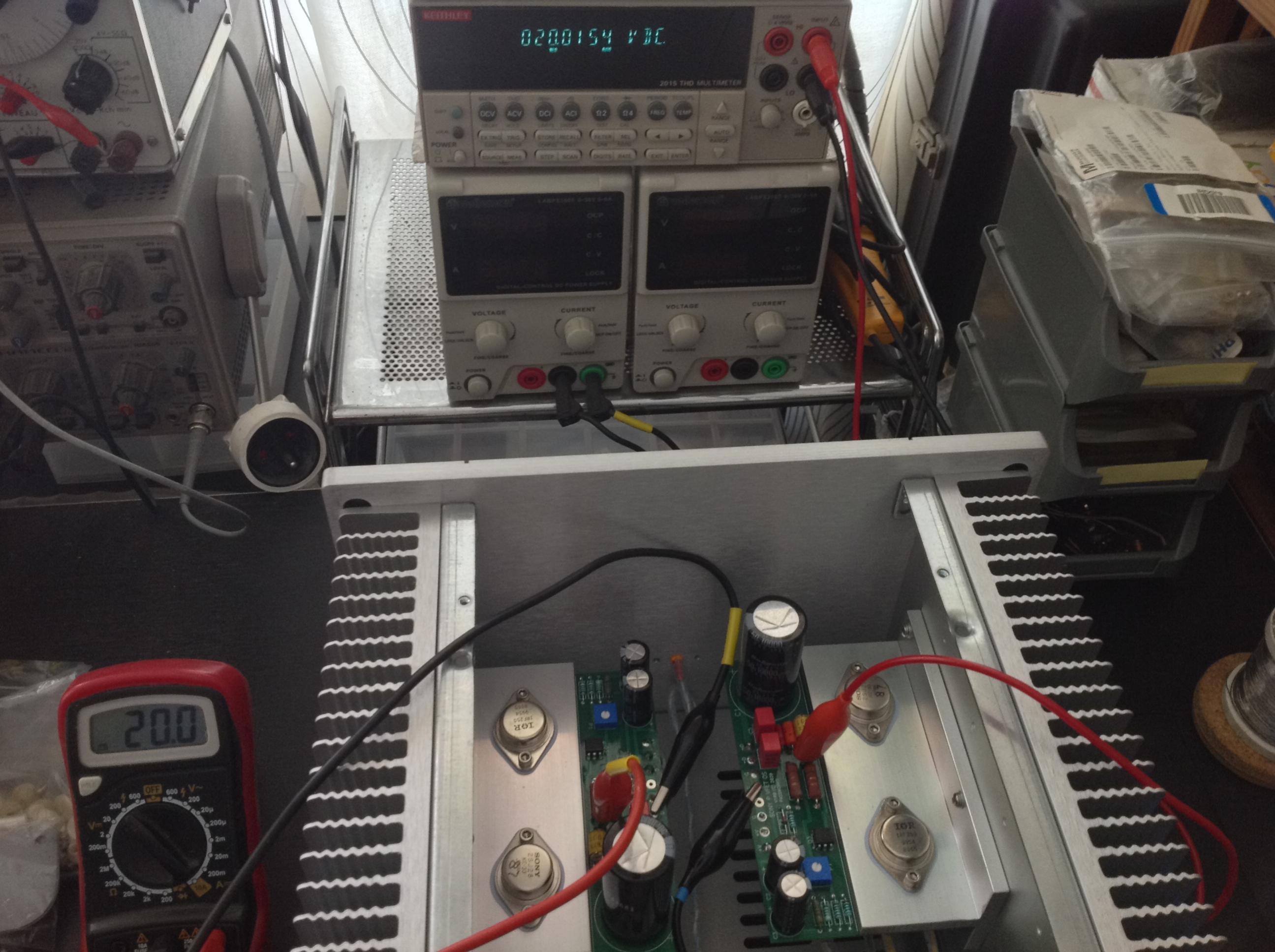

Is my reading correct that the 20V don't need to be adjusted and that the boards are supposed to be mounted as delivered, already fine adjusted by Papa?
That would be great news and somewhat different from some early builders which seem to adjust it...
Thanks for your confirmation!
Claude
I soldered mine in as is, and did not turn them ahead of time like some others did. When it was time to check them and adjust… they barely needed an adjustment to achieve the 20v reading.
Mine came with a 16,5v setting with the pots midway, but I think I do have high vgs devices (123 markings, or somewhere there)
My modules was adjusted to 18.8 VDC from "factory" so I gave it just a tiny adjustment to 20 VDC after warm-up.
I wonder why the difference as Nelson adjusts to 20V when he builds them? Is your meter reading correctly or is the Meanwell putting out less than 36V? I see the Meanwell spec. is +/- 3% so maybe thats why.
So are you saying you didn't adjust those pots to midway and they measured 16.5V or you did adjust them and they measured 16.5V?
I also wondered.
My Meanwell is close to 36V (36.2)......but I did not measure it at "full bias" so I can't say exactly.....but I assume that it is close to 36V. There is some voltage drop over SMPS filter. I do not use the on/off switch on chassis so at least no voltage drop over switch.
My "factory settings" seems to be on the "high side" most others measures about 16-17 VDC?
My pots where incidently (?) set midway, I did not fiddle with them, and when turning it on as is I measured around 16,5V on both channels.
Suited me well, some bias with headroom to start with..
EDIT: That said, I don't get the fuss about the "factory setting" thing, it's a kit, put the meter(s) on, fire it up and set it according to the article
My bad, I forgot that I tested the boards with an external bias voltage for 20V.
Your pots are in separate in a bag with the setting at the midpoint...
Err, sorry, I didn't get that last one...
At the end, is the bias adjusted with your (much greater than mine) skills and top equipment... or should we in fact check voltages with our voltmeters for mere mortals... and possibly dare to alter your initial adjustment?

I am sure that with 36 VDC Meanwell the DC voltage at VFET Source shall be 20 VDC as building guide and documentation indicates.
I am thinking of Nelson setting the bias on "your" output board, with "your" pots , then desoldering them to put in "your" bag 😛
..or should we in fact check voltages with our voltmeters for mere mortals..
@ Claude G
Yes, we need check voltages.
Start with trimmer position in the middle, then adjust to 20V,
after 1hour warm of the Vfet amp adjust one more time if needed.
My was easy and quickly stable. Read Mr. Pass article..
