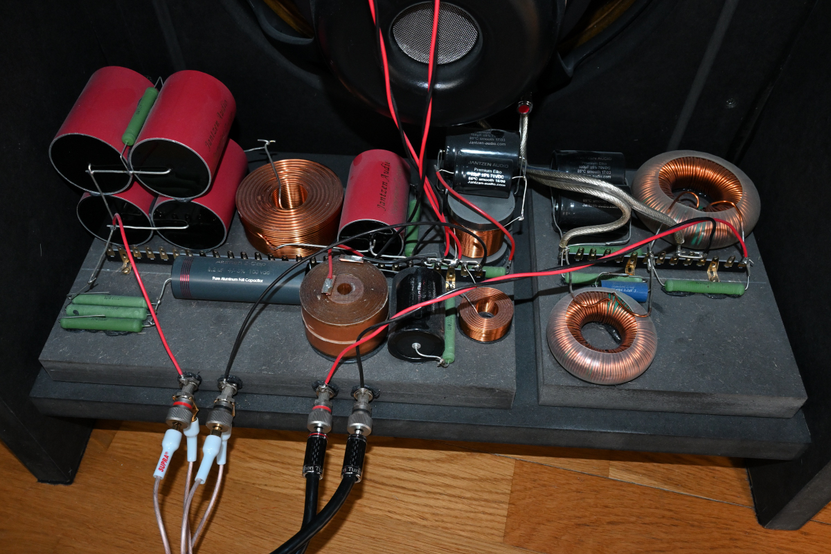

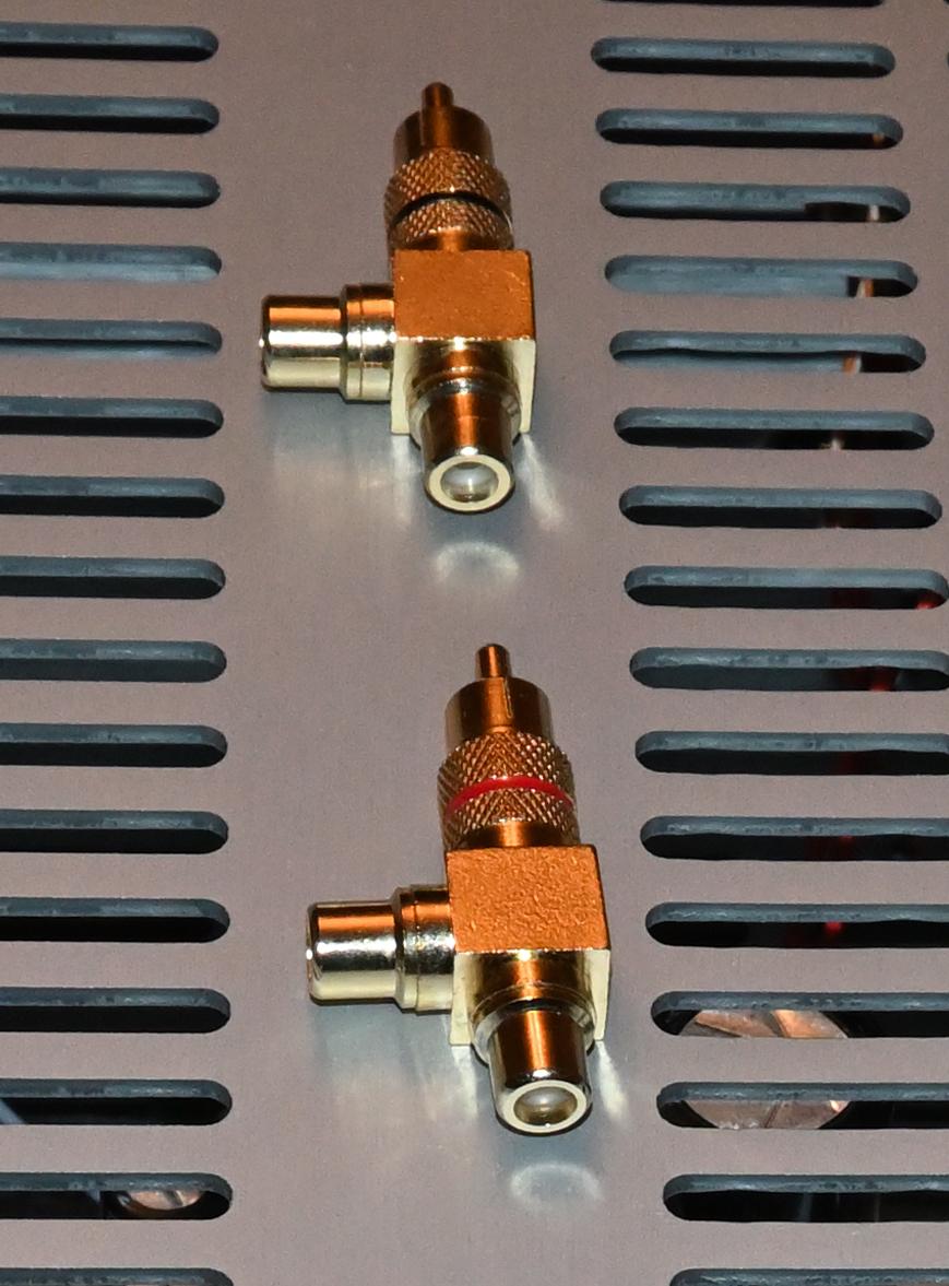

I am fine-tuning speaker placement and listening position after I re-organized the listening room. So I need to get this into place with M2X amps before I switch to VFET. I have these RCA splitters and the crossovers are prepared for bi-wire / bi-amp. Now I only bi-wire. But tempting to try out how bi-amp would work. M2X is better to drive low impedance than VFET (I assume) and the 15" woofers has a dip to about 4 ohm (else impedance curve is nice around 6 ohm). The preamp in use in the moment is SSII and this amp should have no problems driving both amps as SSII is made for driving headphones.

Perhaps I missed it, but how will you adjust for the difference in gain
between the M2x and vfet amps?

Yes, the filter is the 1. grade version of Troels Gravesen OBL-15 speaker crossover. The two filters are maybe like $1000......or so in components.
I will try first without any adjustments and listen how it sounds.
To adjust levels I could maybe insert a passive preamp between preamp and M2X. I have a 24 stepped 10k Goldpoint attenuator in my passive pre. A simple voltage divider could maybe also do it......?
Another wilder suggestion......I have two SSII preamps. The preamps has high input impedance so I could just use two of them so my Bluesound Node 2i (with upgraded PSU 🙂 ) could drive both SSII.....but not easy to adjust levels when it is a pot instead of a stepped attenuator where I could just count "clicks".

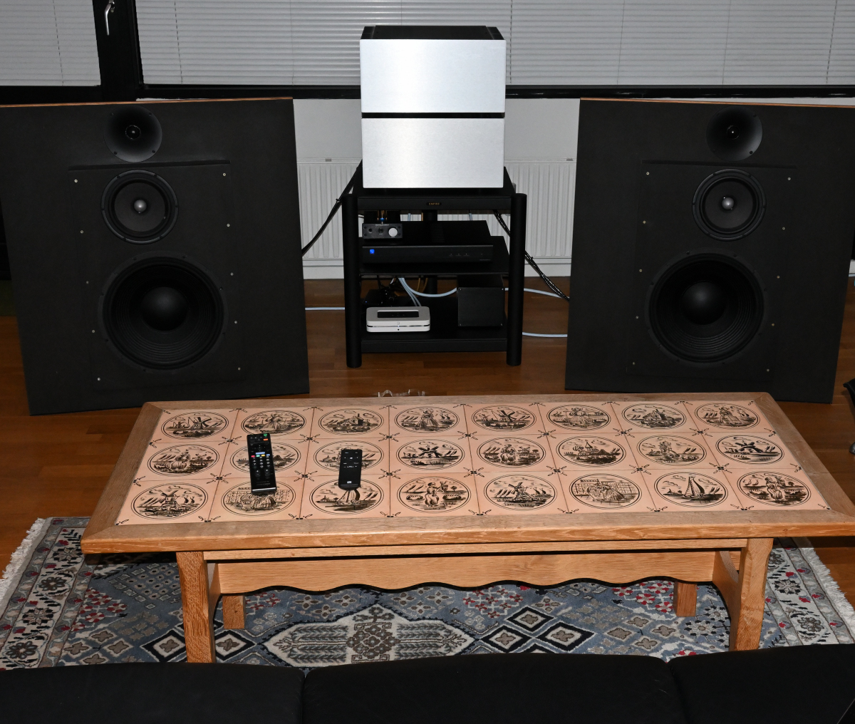

Move that coffee table out of the way, the sound will be better. Try it.
I can try......then I miss a place for the red wine.....or coffee....
There are some "music" in the table as I got it 2nd hand and the owners was the parents of a member (the vocalist) of a famous "former" Danish rockband "Big Fat Snake".....
