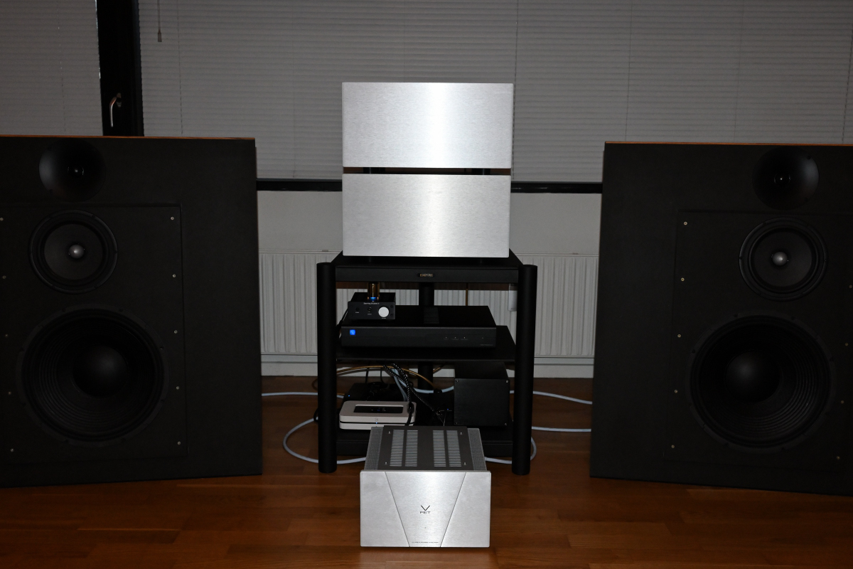

I now got the VFET up and running as stand alone amp. The two M2X are powered off.
As expected the VFET needs a bit more "juice" from the preamp. 9 o'clock with M2X then 11 o'clock is needed for VFET which could be a good thing.
The temperature is about 50 C at the hottest place at heatsinks. Front panel is about 43 C.
There is a difference in sound compared to M2X. VFET more relaxed and less "harsh". Deep tones sound more "rounded" and there is a feeling that it reaches deeper. Same experience as when I connect my 300B amp.
Amp is easy to listen to.
A music example where I observed the biggest difference was this recording:
Rinaldo Alessandrini Releases Third Bach Harpsichord Recital On Naive
It exist on Tidal. So maybe try it out......
1st time I played it on M2X I was nearly fallen down the chair as I was expecting a Grand Piano but this one is Harpsichord!
It has some "nasty" overtones and these are much more pronounced when using M2X. On VFET much more "ear friendly". What is the most "correct" sound I don't know as I have never experienced these instruments live (at least not a "concert grade" instrument).
Imaging etc. is on par with M2X. Voices very nice and also a bit more "polished" as compared to M2X.
I may move the M2X's away for a while and place the VFET on top of the rack.
It can play plenty loud for my use!

Awesome report. Very similar with my experience moving from an F6. It feels as if goes deeper, and very relaxed. Even my wife's first comment as she listened to Nick Cave was "wow, less harsh. I like it". What are your speakers? Looks big
And thanks for sharing an album link. I love Bach and the harpsicord. I can strongly recommend to go and hear one live. It is a brilliant and warm instrument.
I can add that the "turn-off pop sound" is very very light. I switch everything off at a central place (a PS-Audio power plant) so switched off at the 230 VAC side.
The same here Light thump, very short time.
No thump switch turn-on = silence in the speakers

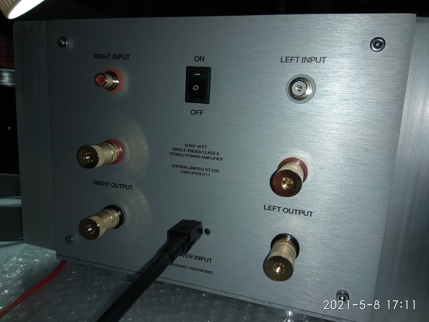

Kit # 059 finally up and running!!
I am very new to the site and was pleasantly surprised to win an opportunity to build one of these Class A kits! I took my time with the build, checked everything twice and about an hour ago, I plugged in the AC cord, and flipped the switch. Voltage rose toward 20 volts and then everything died -- no volts, no blue LED. Turned out that in my haste to get the amp fired up, I neglected to properly seat the AC plug tightly into the power supply. As soon as I started drawing current when I flipped the switch, the connection opened and the amp died. Simple fix and now up and running. Next step is to start stuffing my recently received ACA+ preamp board. Thanks everyone for your helpful posts.

is speakers are Troels OB...nice that can drive it
Yes, those are OBL-15 using the Ciare 15".
CIARE ITALIAN SPEAKERS - PRO AUDIO B2B: NDH 15-4 S SUB-WOOFER
It seems that VFET drives it with no problems.....probably many will say that it is not possible and the 15" needs a 1000W class D amp
