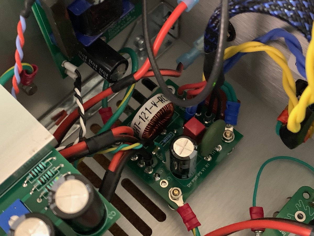

X, you used yellow/green wires for safety earth connection. Can you confirm that the chassis IS safety earth via the MeanWell brick?
There was some debate as to whether the brick output is isolated from earth or not. I cannot check mine, as I still have not received my parts kit.
There was a comment from NP about this and the Meanwell brick is connected to earth via the connector.
Hi Mbrennwa,
The Mean Well jack has 2 pins for 0v and 2 pins for positive 36v and 2 pins for shield or earth ground. I confirmed that the earth ground on the mains IEC plug is connected to the 0v internally at the SMPS brick.
If you look carefully at the bundle of wires from the 4pin jack, you will see 4 wires coming out of the braided cover: 2red, 2black, and 2green.
At the inside of the 4pin DIN connector for the Mean Well are 6 pins total. I have two wires on the outside which I assume are the shield/earth ground and they are connected to the 0v pins. I have the two shield earth wires going to the chassis via crimp loop connectors. The reason I bond the heatsinks to the chassis is to prevent the reliance on the screws that hold the heatsink and bottom panel together to form a good chassis ground. Grounding the heatsink usually makes the amp quieter. Not that this amp is noisy. It’s silent.

Brick output is not isolated from safety earth.
After my continuity test the safety earth pin is connected with V(-) two wires.

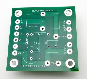

In 6L6 build guide you can see safety earth is soldered to SUPP(-) = G
source: Sony Vfet (P, 2021) - diyAudio Guides
on the psu filtering board then thermistor to the chassis with the screw 🙂
Edit: All chassis parts: Heatsinks, transistors aluminium T brackets, front panel etc.
tightened with the screws is automatically all connected to the safety earth with thermistor like on the original schematic.
