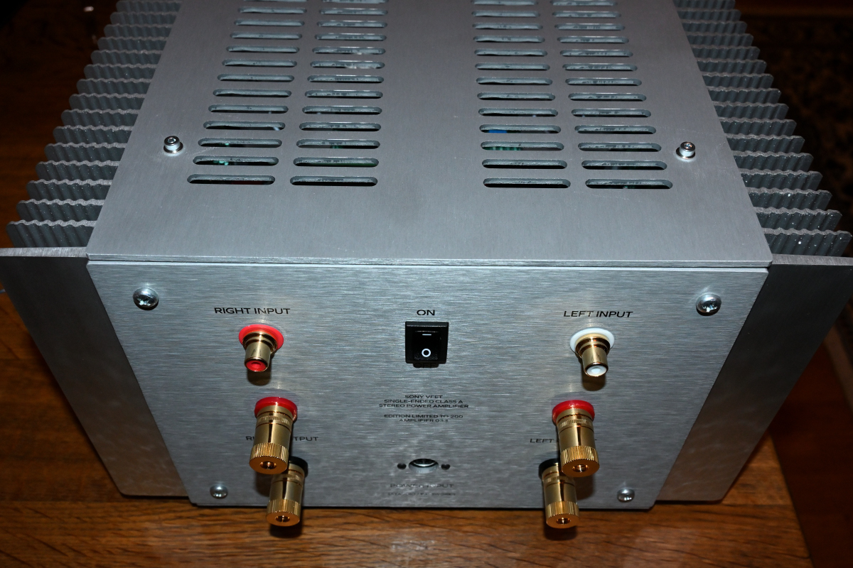

Looks like you have put together another tidy build.
Thanks Codyt and TungstenAudio 😀

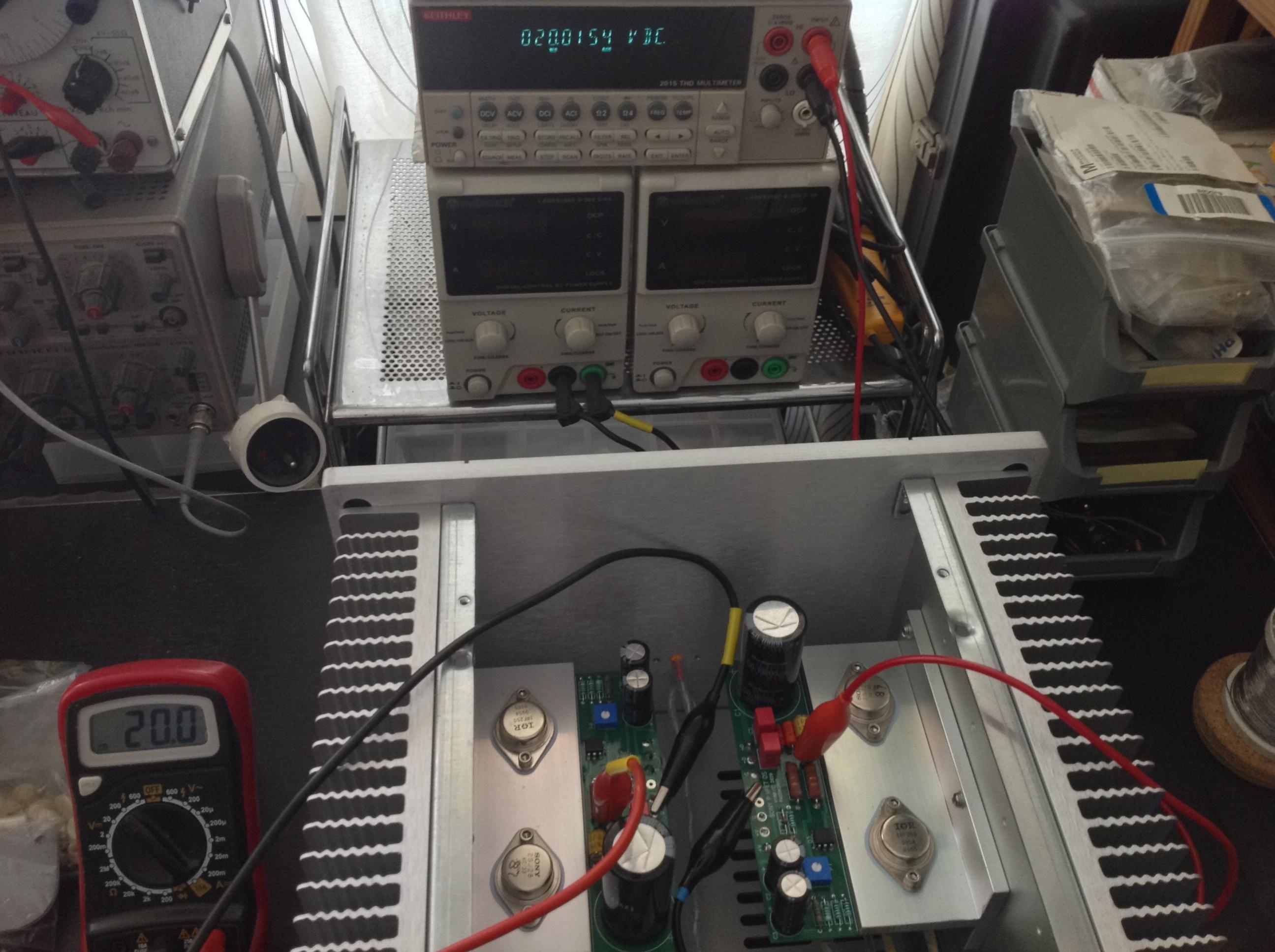

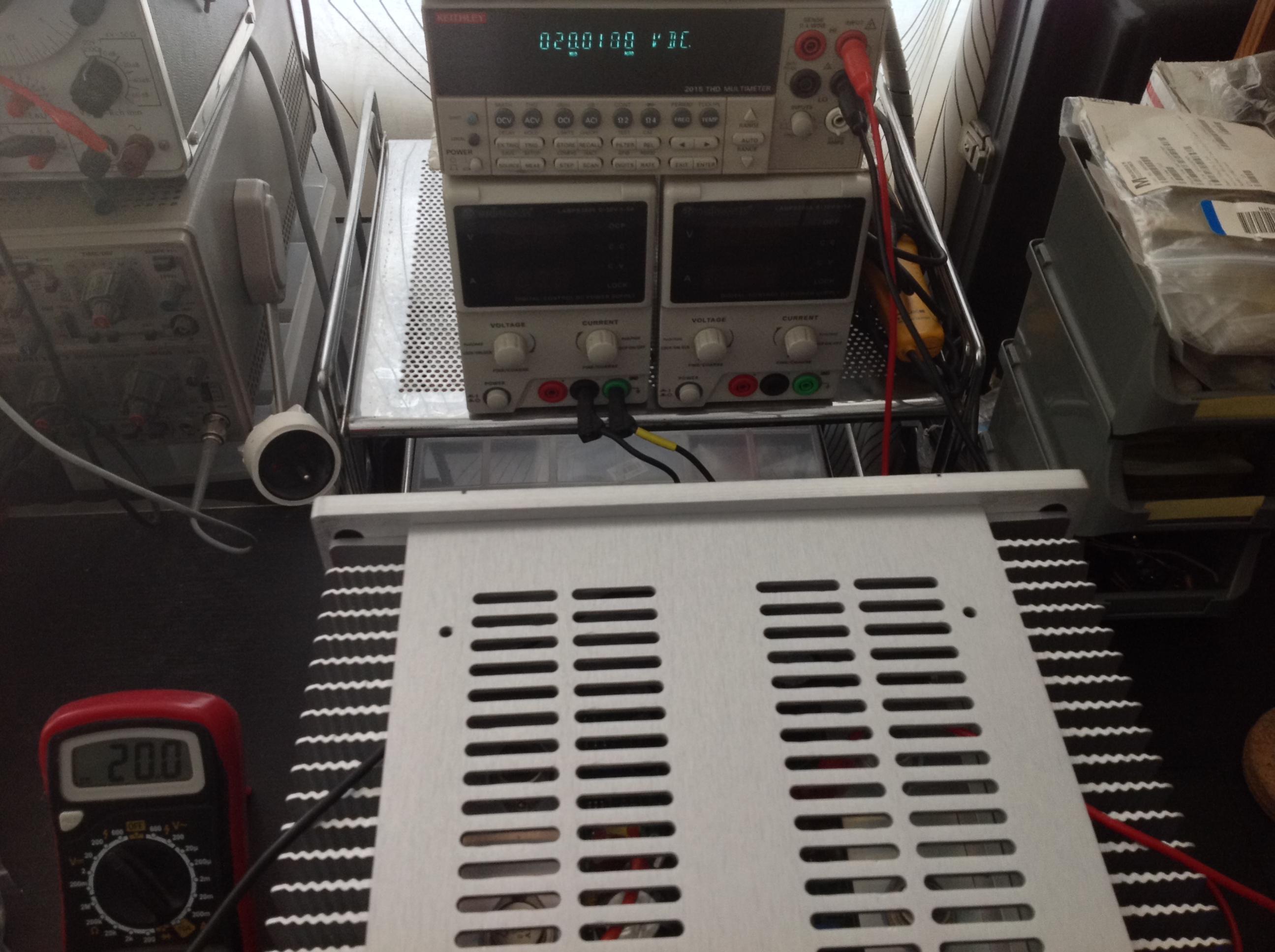

Bias is stable like a Himalayan mountains
