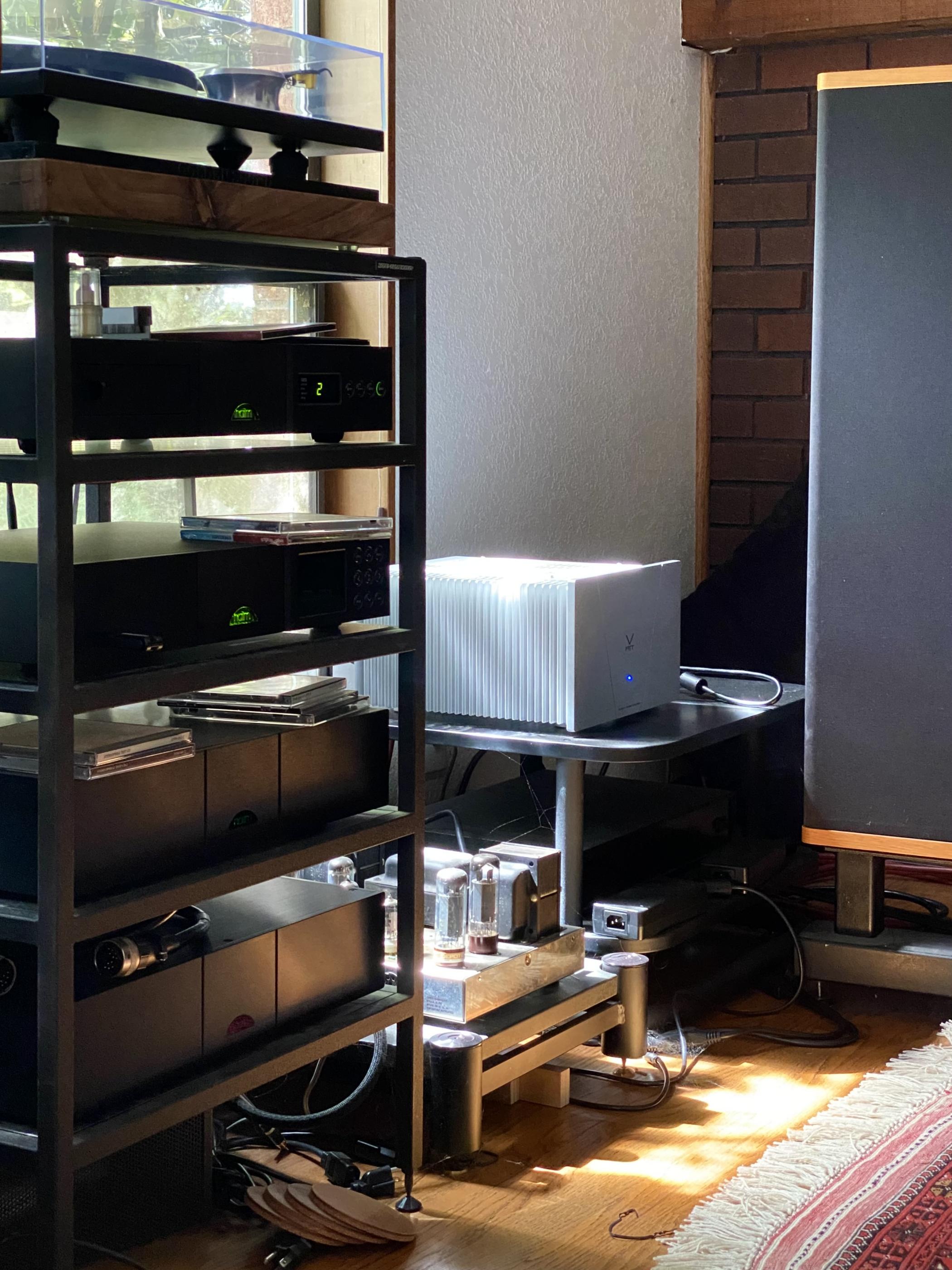

Listening Impressions: Sony VFET pt 1
My recently completed VFET amp (#055) has been occupying the pedestal in my system for a week already, and has been keeping me busy with early morning, mid morning, late evening and mid late afternoon listening sessions. 😉 This amp does take a couple days to run in before it really starts to sound its best. So getting to know the amp's signature sound is a process best savored over time.

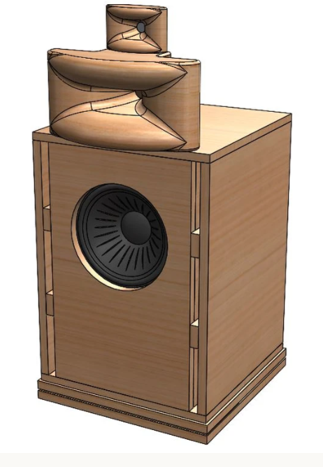

The cross-over point for my speakers is around 900 Hz. This means about half the music range is covered by each speaker section.
I believe the XO has to be near 650 Hz to have 5 octaves with one driver and five with the other. (20–40, 40-80, 80-160, 160-320, 320-640)

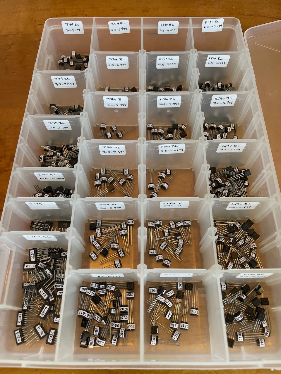

Yes, it is now me. In the last two days I matched up 1600 irfp140's for Aleph J's after 800 2SJ74's.
15+ years ago, I snapped up a small stash of the Toshiba JFETs while they were still available from reputable / authorized dealers. Then serialized and measured them all... my colleagues thought I was nuts.
Now I don't feel like such a weirdo. 😀
Still, matching parts is a lot of work... a few hundred is plenty, but 1600 + 800!!
Some tips if you decide to do some matching of your own... build a little test jig, it goes much faster. I found it was necessary to handle parts with tweezers to avoid body heat transfer affecting the measurements. ZIF socket for quick cycle time & low stress on the part leads. I used a simple push-button activated one-shot timer chip to apply the test pulse and trigger the bench meter for consistent timing / self-heating effects from part to part... overkill perhaps, but easy enough to wire up. If you really want to go over the top, hook up GPIB or RS-232 from the meter, and log your results straight to the computer without typos!
The end result is worth the effort...
