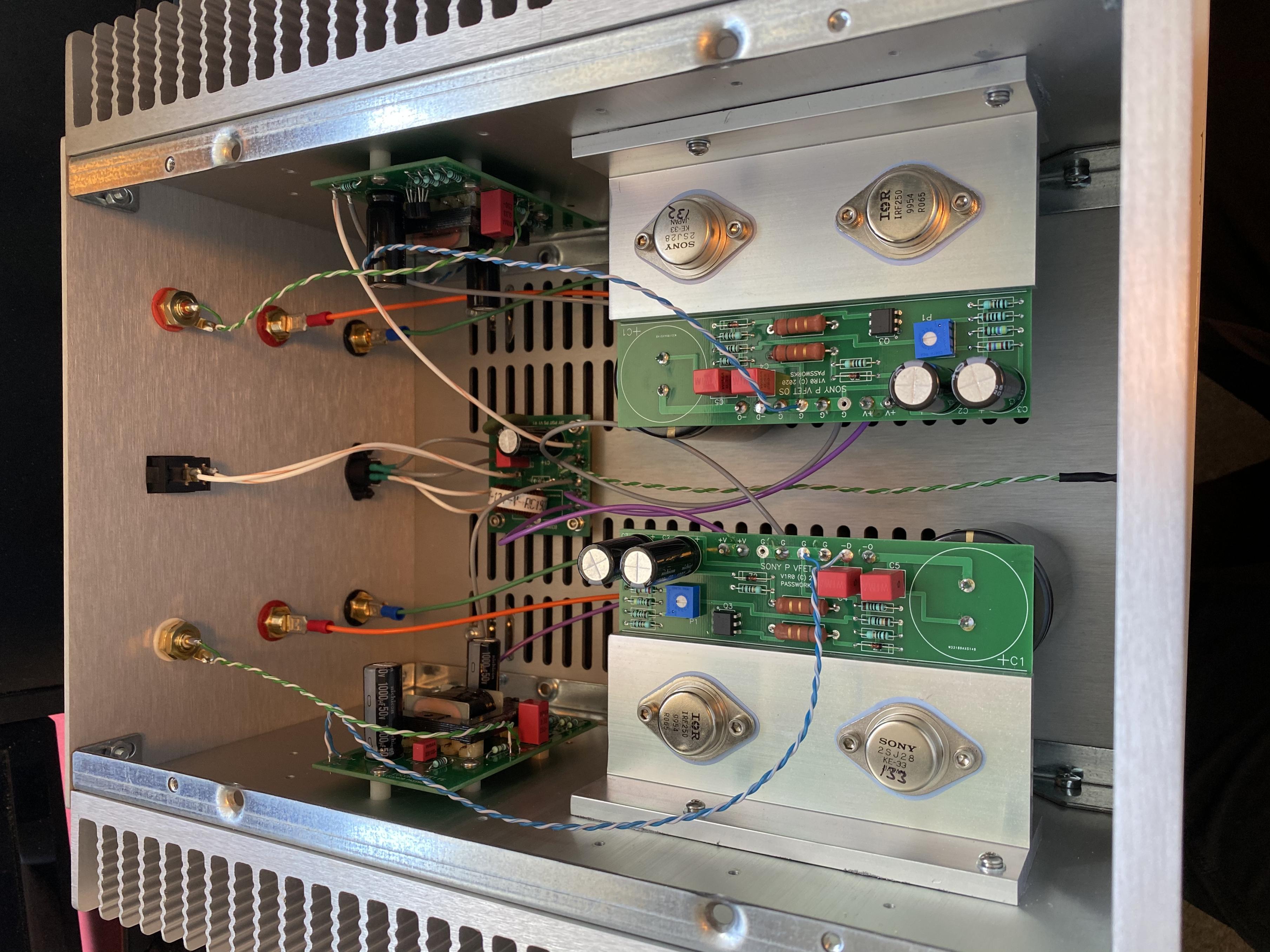

re: its silence. I've used SMPSs (clearly) in a bunch of "smaller" applications previously for audio, but this is my first power amp. All potential misgivings have been eliminated. It is dead silent in my system, and the amp is just amazing IMO.
I have to say, this amp project has made a convert out of me as well 😀 I've used a number of SMPS over the years and have always been disappointed in one way or another. I've even warned others here against using them because of my own experiences.
Seems that we've turned a corner with this technology, at least with the well-constructed ones (I'll still not recommend the $10 ones from ebay). I am surprised just how heavy that little Meanwell unit is!
I have been out for a week on travel and my VFET packages were sitting there at home, waiting patiently. I hope to be able to build it soon. It has been great to live vicariously through all the folks here who have been building their VFET amps. Super job everyone!
A well designed SMPS has a much better chance of reducing or eliminating noise and mains hum. It pushes the modulation noise out of the audible band (50/60Hz) up way past the ultrasonic range (100’s of kHz) where our ears don’t work and where the speakers cannot respond. Linear supplies especially affect an amp with an unshielded signal transformer as there is potential for the Edcor to pick up radiated magnetic fields from a large linear transformer if it were inside the chassis. This was my experience with the M2/M2X. Once I shielded the Edcor with mu metal, and moved the linear transformer outside of the chassis or switched to a SMPS, the hum was significantly reduced, but never silent.
My only experiences in a silent SE Class A amp using a linear PSU always required use of a capacitance multiplier after the linear supply and making the supplies dual monoblock. The sharing of a common linear supply was another typical source of low level noise or hum from ground loops in the common connection at the source left and right channels from the source RCA negative/shield.

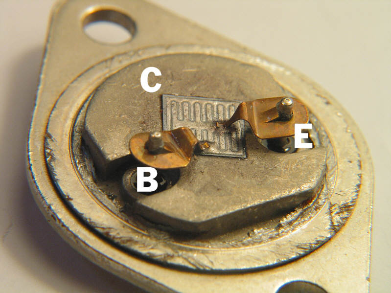

one funny guy ( guess which one) wearing Mithrandir's cap, recently said to me: " At this rate you will end up playing with original 2N3055's ...."
Baad Papa!
Baad Papa!
one day I'm really going to make dedicated amp with them
just because he's mocking, torturing,koan-ing me for decades
little container full with sand and little pill of gray smoke, how else
And no matter how well corporations design and build better containers to keep all that sand and smoke inside, I come along to challenge them as the better idiot.
Nelson was kind enough to explain earlier that the wiring diagram showing the additional run from the tabs to chassis ground was a redundancy put into place in the event an isolated supply was used. If you got a "full kit" then that run is not necessary.
Hmmm, can you maybe provide a link or similar to Nelsons explanation?
If an isolated supply was used, what's the point of isolating the chassis from audio GND using a thermistor?
Also, if a supply without isolation is used, the audio GND is connected to mains earth, which may cause ground loop troubles. It would be better to go with an isolated unit.
